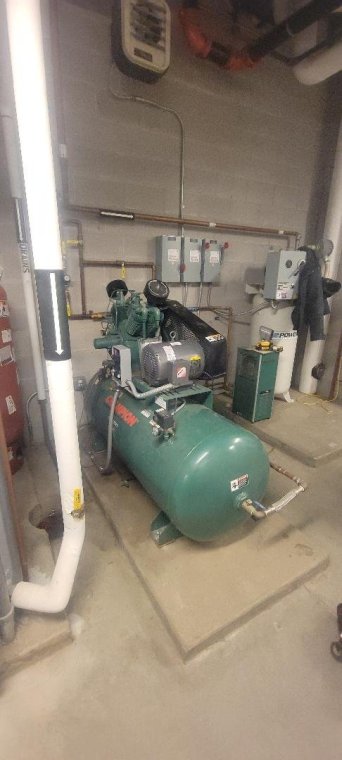

uncledj Posted March 1 #1 Posted March 1 I recently changed an air compressor at a facility and the one I removed was too nice to scrap. I know that it runs as I started it for a few seconds while it was still in place, before disconnecting for the changeout. It started and ran well for the 2 seconds I ran it. It had no oil showing in the sight glass so I didn't want to run it any longer. The maintenance guy at the facility condemned it because he saw oil film around the compressor end and thought that meant it was bad. So, I strapped it to my bike trailer and brought it home. The issue is that it's 3 phase and I'll need to get a converter to run it. It has a 200 v ? 10 hp motor. I typically see 208-230 for a 3 phase or 220-240 for single phase. So I don't know what the 200 v on the nameplate is about. My question is, should I get a 10hp or a 15hp converter. My tendency is to go larger, but I read that an oversized converter can cause the motor to run hot. Whaddya think....1o run a 10hp air compressor....a 10hp drive or a 15hp drive?

uncledj Posted March 1 Author #6 Posted March 1 (edited) It IS an air compressor. A 10hp drive is just over $200, a `15hp drive $300. A used 10hp motor would be around $700 + shipping, a new motor would be around $1200 +. I'd like to go the cheap route since, although I ran it for a couple of seconds, I don't know for sure that the compressor itself is healthy. If the compressor ends up without any major damage, this will make one hell of a shop compressor. I guess the question would be whether an air compressor motor would be a "Heavy start load" or a "Rated start load". I'll be retiring in a couple of years and will be looking to move back to the Youngstown area. I'll be looking for a place with a large detached garage, or with enough land to put up a pole barn to use as my "Tinkering space". This would be a hell of a compressor for such a shop. Edited March 1 by uncledj

uncledj Posted March 1 Author #8 Posted March 1 Well, I seem to have created some cornfusion with the A/C description of the motor. It's an air compressor, not an air conditioning motor. Yes, in most air conditioning compressors, if they're hermetic or semi hermetic, the oil travels through the system and returns to the compressor. There are large systems, designated as having "open" compressors that have a separate motor that typically drives the compressor using a Woods style coupler. These systems do not flow oil with the refrigerant. With an air compressor, I don't think they're supposed to discharge any oil, but only in a perfect world. I think they all leak a little oil and let a little oil into the airstream, but should be negligible on a healthy compressor. My suspicion is that this compressor, while never worked hard, has not had good / any service over it's 14 year life. I think the oil leaked out or was pumped out (slowly over the years) Still has the original oil filter on it. The question there will be how long did it run with low / no oil, and if / how much damage was done. I'll need the power converter to run it off of single phase. Since originally posting I ordered a 10 hp converter and will be able to determine compressor condition once I can run it.
