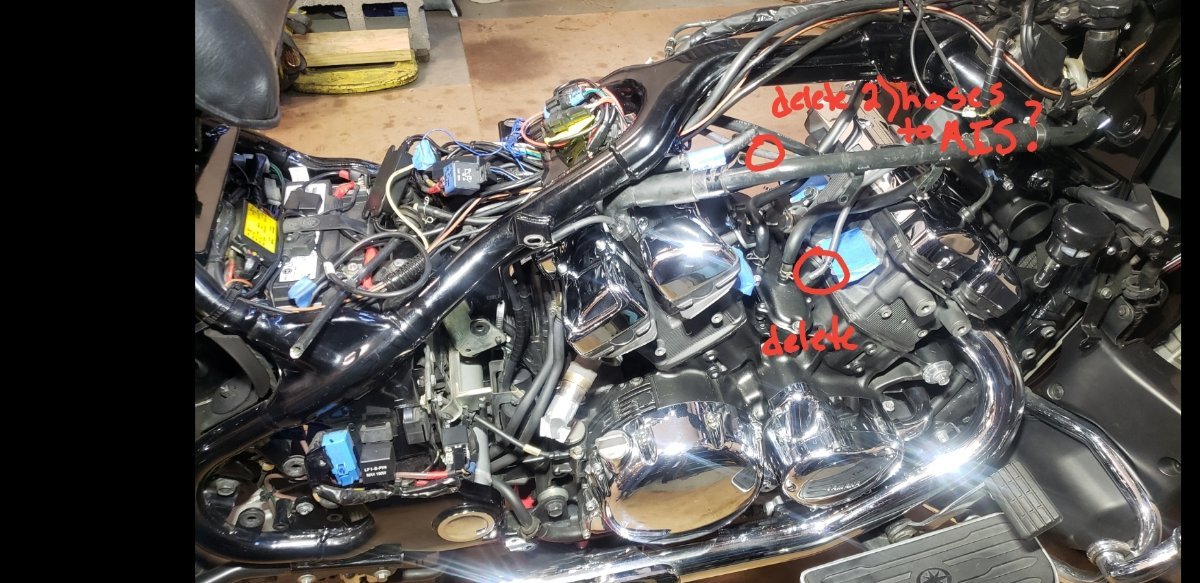

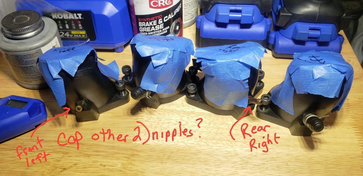

InfinitySurf Posted December 18, 2024 #1 Posted December 18, 2024 Question on my 2012 RSV. Just finished doing valve check (all within spec), replacing the valve cover gaskets and the gaskets in the twinkie.... as I am putting this back together I am wondering if I can DELETE the 2 hoses that connect to the front left and the rear right intake boot nipples since I previously plugged/deleted the AIS system in 2021? Dont see any reason why I cannot just remove those 2 hoses and install nipples to close them off like the other 2 cylinders but would like to verify since I saw a post a while back where someone says something about one of those hoses (maybe to the front left cylinder?) connecting to the cruise control so if plugged then the cruise will not work? I rarely use the cruise but would want to keep that option altho I cant see how that hose would make a difference to the cruise with the AIS system already plugged up. Can anyone confirm? Few pictures attached. Appreciate it!
ragtop69gs Posted December 26, 2024 #2 Posted December 26, 2024 After I deleted my AIS I removed the hoses and capped the intake ports. No problem. 1
InfinitySurf Posted December 29, 2024 Author #3 Posted December 29, 2024 On 12/26/2024 at 10:21 AM, ragtop69gs said: After I deleted my AIS I removed the hoses and capped the intake ports. No problem. Thank you for the confirmation!

InfinitySurf Posted January 2 Author #5 Posted January 2 On 12/30/2024 at 8:54 AM, BratmanXj said: I think i linked mine front to rear on each side of the engine. There was an article on one of the tech forms about "balancing" the engine pulses to the carbs, but I've read on other forums debunking any improvements and never really worried about it since on the Venture. I'm digging into my carbs this winter so maybe I'll eliminate the cross-over hoses. I read that thread here and saw linking them mentioned in a couple other places, the comments about the idle being wonky after doing that kept me from going that route. I just finished my list of maintenance items on the RSV for this winter and have my bike back together with everything running perfectly again, so planning to sync the carbs on the next day where I have decent weather. Figured after doing that I would go ahead and cap the other 2 nipples. Guess I also need to remove those 2 hoses and cap them where they terminate into the AIS system. The rear hose will be pretty easy to access but that front hose looks like its gonna be a PITA to get too since it terminates between the radiation and the bottom front of the engine. I may end up just plugging that front hose for now so I can get all 4 nipples capped.

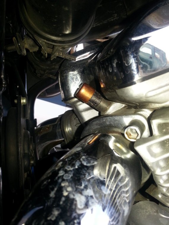

BratmanXj Posted January 2 #6 Posted January 2 (edited) 14 hours ago, InfinitySurf said: Guess I also need to remove those 2 hoses and cap them where they terminate into the AIS system. The rear hose will be pretty easy to access but that front hose looks like its gonna be a PITA to get too since it terminates between the radiation and the bottom front of the engine. I may end up just plugging that front hose for now so I can get all 4 nipples capped. 1/2" Copper plumbing caps were a snug fit with the factory stainless webbing "gaskets" for the AIS ports on the heads. 10 yrs later and they're still there. Edited January 2 by BratmanXj 1
InfinitySurf Posted January 7 Author #7 Posted January 7 On 1/2/2025 at 1:28 PM, BratmanXj said: 1/2" Copper plumbing caps were a snug fit with the factory stainless webbing "gaskets" for the AIS ports on the heads. 10 yrs later and they're still there. That is a great idea, I will most definitely try that! Did you literally just pressure fit them on or are they secured on there with anything? I got the carbs synced and since its so damn cold right now I just put 4 nipple caps on to the intake boots and then also just temporarily capped both of the small hoses for now. Have my heated garage tied up with a quad engine re-build right now so will get back to this bike sometime soon and if I can cap them at the cylinders with the 1/2" copper cap like you showed I will delete every bit of the AIS crap on & under the bike. Thank you for sharing!! 1
