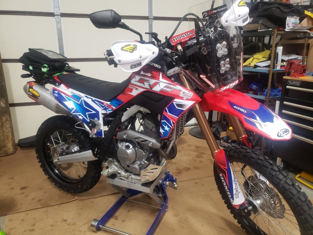

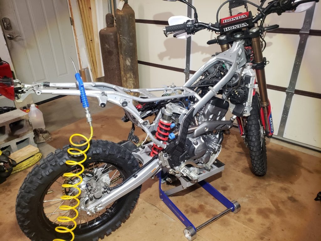

InfinitySurf Posted December 28, 2024 Author #26 Posted December 28, 2024 Received the 4 OEM diaphragm's in the mail today so planning to get the old ones replaced and the RSV back together again so I can crank her up & make sure there are no other issues. The weather has been pretty crappy this week so been in the garage quite a bit. I just finished putting my duel sport bike back together today (Honda CRF300L), had it stripped down to replace the cams and do some air box & throttle body mods and had the ECU re-programmed to give her a little more go juice. Still enjoy riding trails and doing occasional single track racing. Hope everyone had a great Christmas! 2
