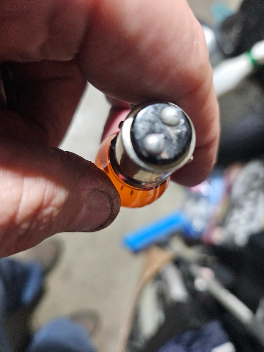

sleepy2 Posted September 27 #1 Posted September 27 Was out for ride last night and when pulling up to store front windows noticed left turn/marker light wasn't working. Turn signal did work so when I got home I tried to get bulb out but not enough strength in fingers to push up and turn bulb to get out! Going to get son to get it out for me. Went to dealer and there were 2 part numbers ( which I think it was for either clear or orange bulb)they had clear Yamaha bulb at $8.50 +taxcan but no orange. They had an aftermarket orange they said would work so I bought it for $4can+tax. Will change when he gets here! Probably don't need to change as passing lights would be enough to show width of bike but I like to have things working! 2
sleepy2 Posted September 29 Author #2 Posted September 29 Tried bulb dealer sold me(2 ears) but when I finally got old bulb out it wasn't the same (told him it probably has 3 ears that hold it in)like I told him. Went back to return it and order the right one and girl says "that's a different price!" So I asked how much? $17can with tax!! Should be in next week!

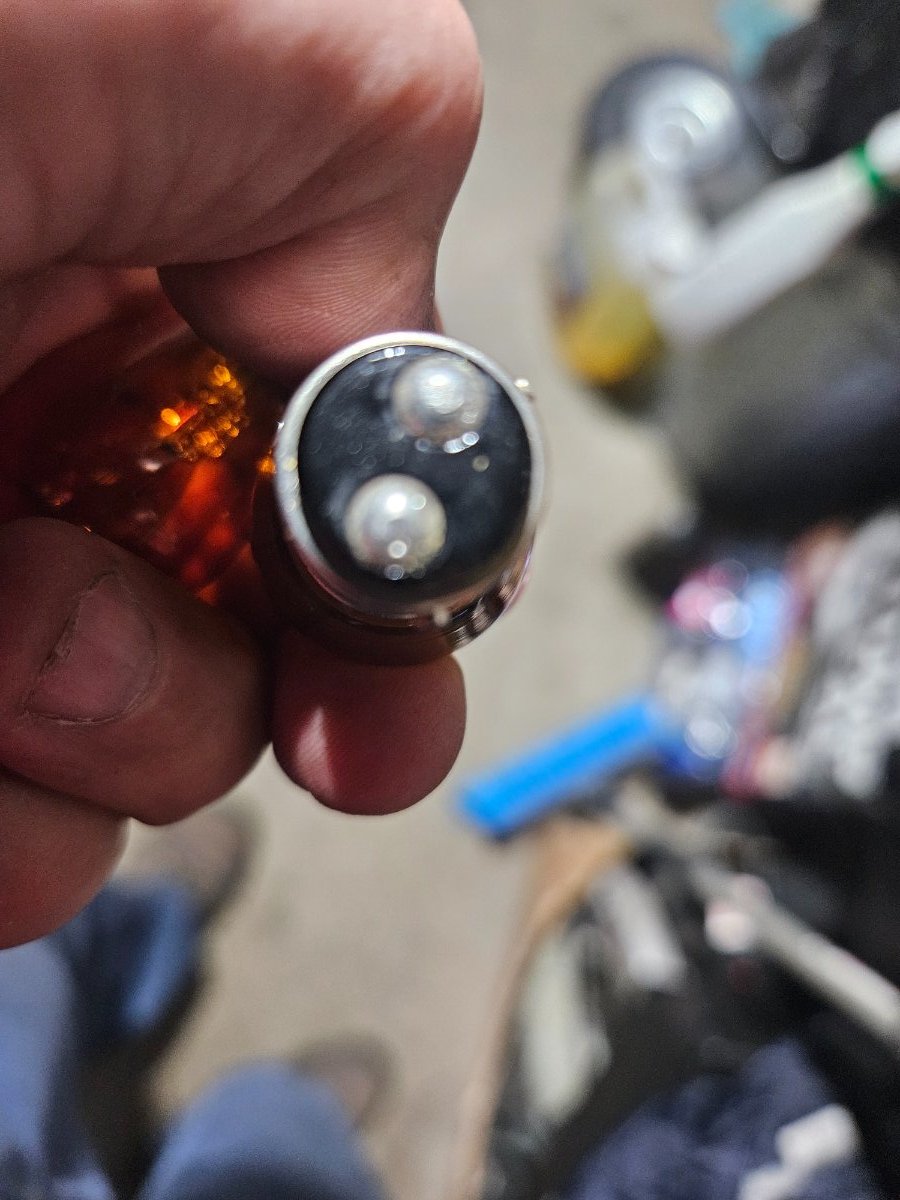

sleepy2 Posted September 29 Author #4 Posted September 29 @cimmer sorry pictures didn't show properly as I have tried Canadian Tire but they are not standard 1157 bulbs! 1157 bulb only have 2 pins on opposite sides while Yamaha bulb has 3 pins around with 1 slightly off to lock bulb in base of holder. Tried other jobers and same, told me it's a dealer part! 2

sleepy2 Posted October 9 Author #7 Posted October 9 @cimmer no problem, should have had wife hold bulb so I could have taken a better picture. Still waiting for dealer to call! Yes the rubber around bulb is a pain! took me a bit to remove, now it is a real pain to get lined up to get bulb back in,I don't think the old bulb is quite in right but still works on signal. Will worry about it when I get new bulb then will make sure it goes in rite! Hard to tell when pins are lined up!

sleepy2 Posted October 20 Author #13 Posted October 20 No number on bulb! Looks like same bulb in picture but picture doesn't show other side to see if another pin. Original has 3 equal distance around and new bulb has 2 pins in same position as original (missing 1 pin)Haven't changed it yet as ridding around and working on tractor but took it out of box right now to replace but it looks like only 1 filament inside and I think it should have 2 because it is a marker lite and flasher. Will check tomorrow! Number on box is the same as Partzilla tho!
saddlebum Posted October 20 #14 Posted October 20 4 hours ago, sleepy2 said: No number on bulb! Looks like same bulb in picture but picture doesn't show other side to see if another pin. Original has 3 equal distance around and new bulb has 2 pins in same position as original (missing 1 pin)Haven't changed it yet as ridding around and working on tractor but took it out of box right now to replace but it looks like only 1 filament inside and I think it should have 2 because it is a marker lite and flasher. Will check tomorrow! Number on box is the same as Partzilla tho! You are correct regarding it should have 2 filaments and it should also have 2 lead contacts on the base. Odd that they would opt to use such a rare bulb for a simple signal light.
