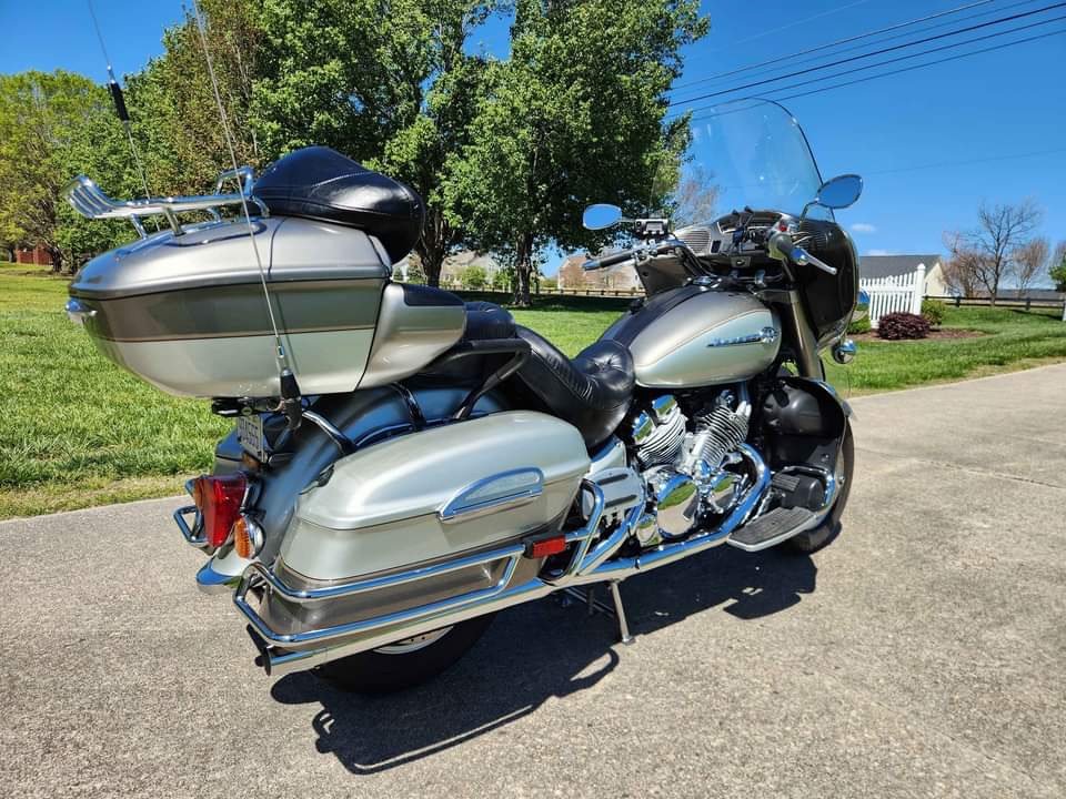

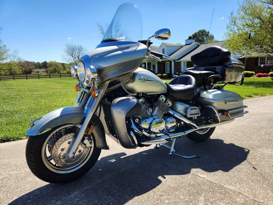

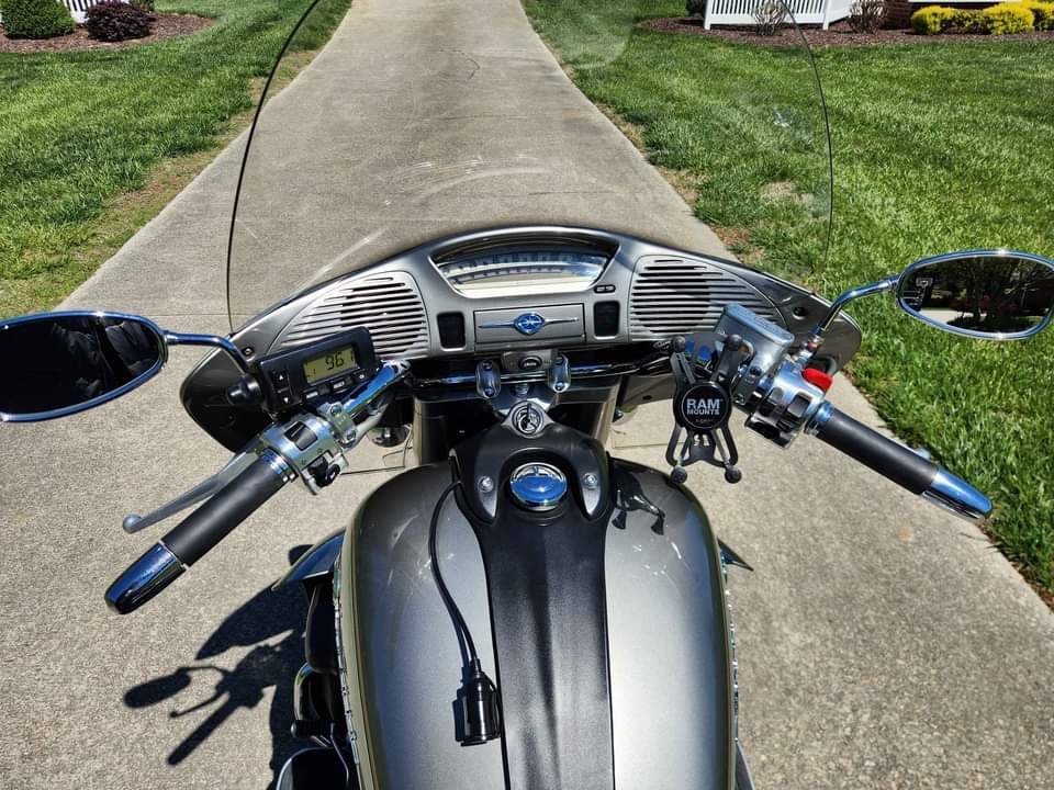

Doublehorse Rider Posted August 28, 2024 Author #4 Posted August 28, 2024 Had to get our main man help me with the picture uploads. Wondering if he ever sleeps… I was looking at the Goldwings, and I know some of us have them, but I couldn’t get over the fairing not turning with the front wheel. I love the fact that the RSV does, so I’m enjoying the “Silverwing”. 2
