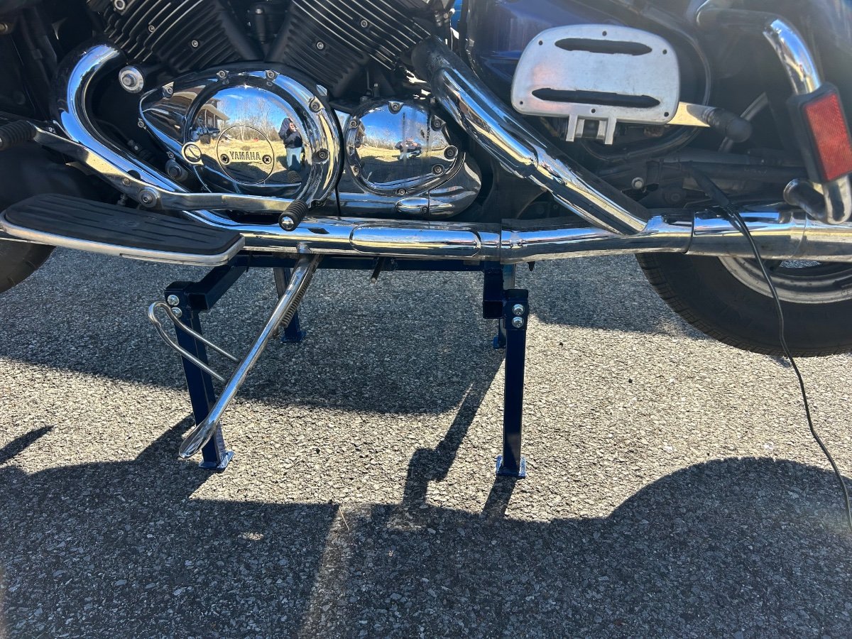

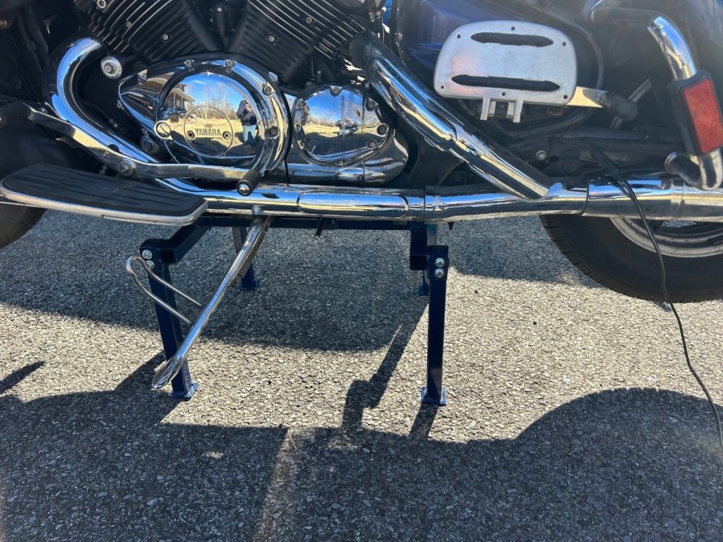

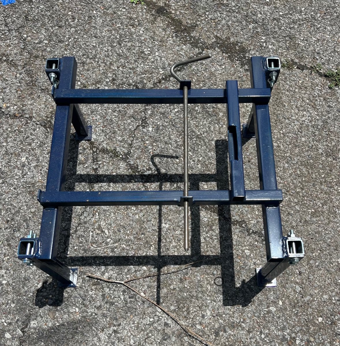

RDawson Posted May 27, 2024 #10 Posted May 27, 2024 This is the adapter with legs I build. It has a wide stance for stability and oil drain pans fit under it.
XV1100SE Posted May 27, 2024 #11 Posted May 27, 2024 41 minutes ago, RDawson said: This is the adapter with legs I build. It has a wide stance for stability and oil drain pans fit under it. Looks good. Just wondering.... the plates at the bottom of the legs don't look very long/wide. Have you considered going bigger on those? How tall are the legs? Some jacks don't go as high as others. Might be something for people to consider if they order it from you. You should put it in the "for sale" area if you already haven't for those interested....if you plan on making/selling them. Also...how wide is the adapter? The jack I had originally had pads that barely fit across the adapter that Larry made. I went with a jack with much longer pads so I have about 2" extending beyond the adapter (makes less me less nervous when lifting the bike !)
RDawson Posted May 27, 2024 #12 Posted May 27, 2024 (edited) 4 hours ago, XV1100SE said: Looks good. Just wondering.... the plates at the bottom of the legs don't look very long/wide. Have you considered going bigger on those? How tall are the legs? Some jacks don't go as high as others. Might be something for people to consider if they order it from you. You should put it in the "for sale" area if you already haven't for those interested....if you plan on making/selling them. Also...how wide is the adapter? The jack I had originally had pads that barely fit across the adapter that Larry made. I went with a jack with much longer pads so I have about 2" extending beyond the adapter (makes less me less nervous when lifting the bike !) The legs are 1.25. The bottom pads are 2x2, that gives 16 square inches of ground contact. 869lb/16 gives only a 54lb per inch ground pressure point. I didn’t feel the need to go bigger as it lets you move the jack to find center of gravity depending on contents of bags or maybe bags removed without hitting the jack. I can drop a tire/wheel, slide the jack off center to keep it level and jack it up to get the tire out. The width at the frame is the standard 11” for frame contact. Leg width is 20”. The legs are 12” so that shorter jacks work and gets tire’s approximately 5” off the ground. (My personal one has taller legs but the 12” is for a more universal fit for different jacks) These aren’t box store tubing, they are constructed of ASTM A500 structural steel I went extra wide so I feel more comfortable really cranking on bolts without a chance of tipping. The only downside I see is that due to the wider size the shipping gets a little steep depending where it goes. The price includes shipping in the 48 and to Canada it is actual shipping minus $60. ($60ish is an average price I pay to UPS in the 48.) They are listed under the 2nd Gen Parts and Accessories heading. Edited May 27, 2024 by RDawson
