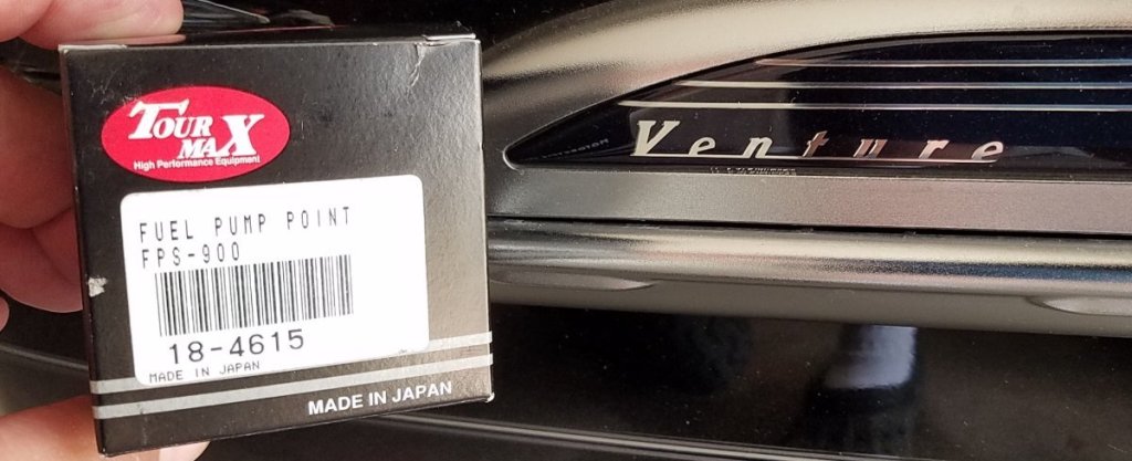

RDawson Posted May 10, 2024 #5 Posted May 10, 2024 On 5/10/2024 at 9:32 AM, uncledj said: It's probably be a good idea to keep a set of replacement points with the tool kit on the bike. Where might one purchase them? Expand I get mine from Amazon. 1

Du-Rron Posted May 10, 2024 #7 Posted May 10, 2024 Your dealer can get them direct from K & L Supply, or you can get them from Amazon. The K & L Supply points are quality Japanese made points. https://www.amazon.com/Supply-Universal-Point-Switch-18-4615/dp/B0034ZMVKU
