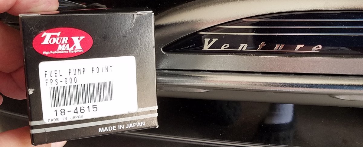

VentureFar Posted Saturday at 06:55 AM Posted Saturday at 06:55 AM Just want to pop my head up and say thanks for this thread. I used to be active on this forum but now my Venture has pretty much sat for 4 years as I play with a Tenere 700. Went to go for a ride with the wife today and all I got was a slow idle and no clicking. I took off the side cover and tapped the fuel pump and voila ! gas. This isn't my first rodeo with replacing the points but didn't remember the part number. Thanks @Du-Rron 1
