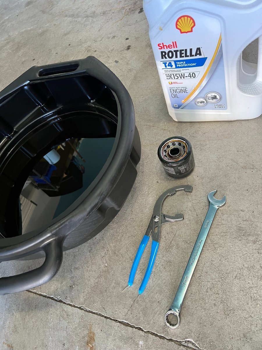

N3FOL Posted June 25, 2024 #5 Posted June 25, 2024 (edited) Today was "Oil Change Day' for my RSV. I've owned her from the very beginning from 2007 to present. It has always amazed me from her very first oil change up to now...how straightforward it is to change the oil on the RSV using simple tools. This is all the tools I need to do an oil change. Every 3000 miles using dino oil ever since. Ride safe all. Edited June 25, 2024 by N3FOL 3
bpate4home Posted June 26, 2024 #6 Posted June 26, 2024 Gen 3's are a different beast. 3 drain plugs and 2 fill locations. Same tools though.
N3FOL Posted June 27, 2024 #7 Posted June 27, 2024 That is true. I always have to measure the oil 2 to 3 times before I finally do the pour. Because my SVTC is lower than the RSV, I will have to lift the bike in order for me to fit my one and only oil pan. So generally, it takes more time on the SVTC than the RSV IMO. The SVTC also takes more oil. FWIW, I love them both.
