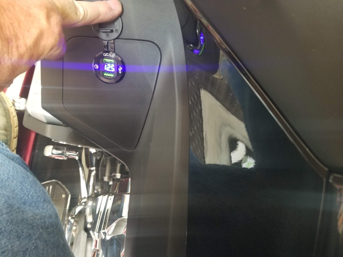

Woody Posted September 27, 2023 Share #4 Posted September 27, 2023 I prefer a digital readout over the lights, I can look at the readout when I turn the ignition on and again when the motor is running and see the status of my battery and charging system. Link to comment Share on other sites More sharing options...

etcswjoe Posted September 29, 2023 Share #6 Posted September 29, 2023 (edited) On 9/26/2023 at 10:22 AM, Frank88 said: Thank you very much Crazy Joe. Thank you for your Service Joe. My Dad is a Retired Chief Warrant Officer III. Have to watch out for those Warrants Unless he was a carrier or Nuke cruiser sailor. On 9/28/2023 at 12:08 PM, Frank88 said: Yea I may change mine also to a digital readout. Thank you, Woody. Make sure you get one that you can see in the daylight, I made that mistake. Edited September 29, 2023 by etcswjoe 1 Link to comment Share on other sites More sharing options...
