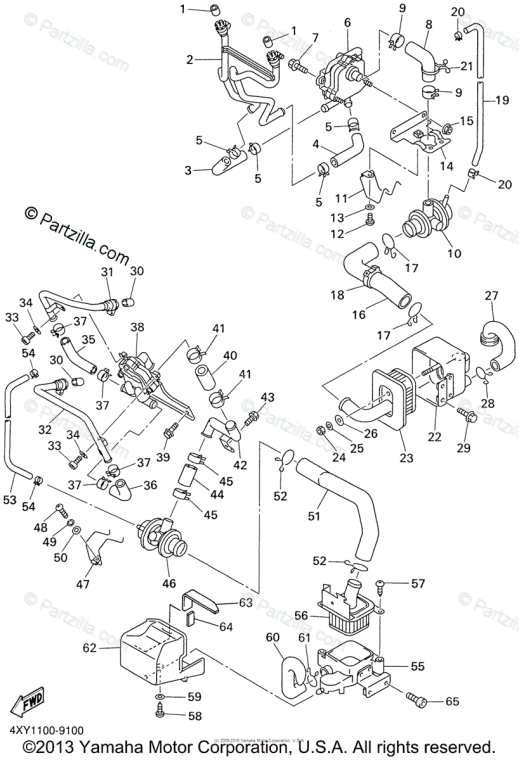

djh3 Posted September 14, 2023 Posted September 14, 2023 Well I looked in the parts diagram and couldn't run across where the plastic thing goes to. But it also appears to be a vent box. If you look the tube starts low and goes higher before it can exit. Indicating it is capturing a liquid possibly and if it gets to high it can then drain out. But its idea is if there is some liquid it can evaporate before it would drip. Would make sense if it was some sort of crankcase vent, or possibly fuel?
WIZ Posted September 14, 2023 Posted September 14, 2023 (edited) I think it is part of the AIS system. Part number 22. 22 CASE, AIR CLEANER 4XY-14857-00-00 In Stock $65.99 $49.64 Edited September 14, 2023 by WIZ 1
BratmanXj Posted September 16, 2023 Posted September 16, 2023 I do believe that 2nd picture is the air intake for the Air Injection System (emissions)
Russ Posted September 27, 2023 Author Posted September 27, 2023 #22 looks like it! How urgent is this to replace or can it wait until I put her up for the winter?

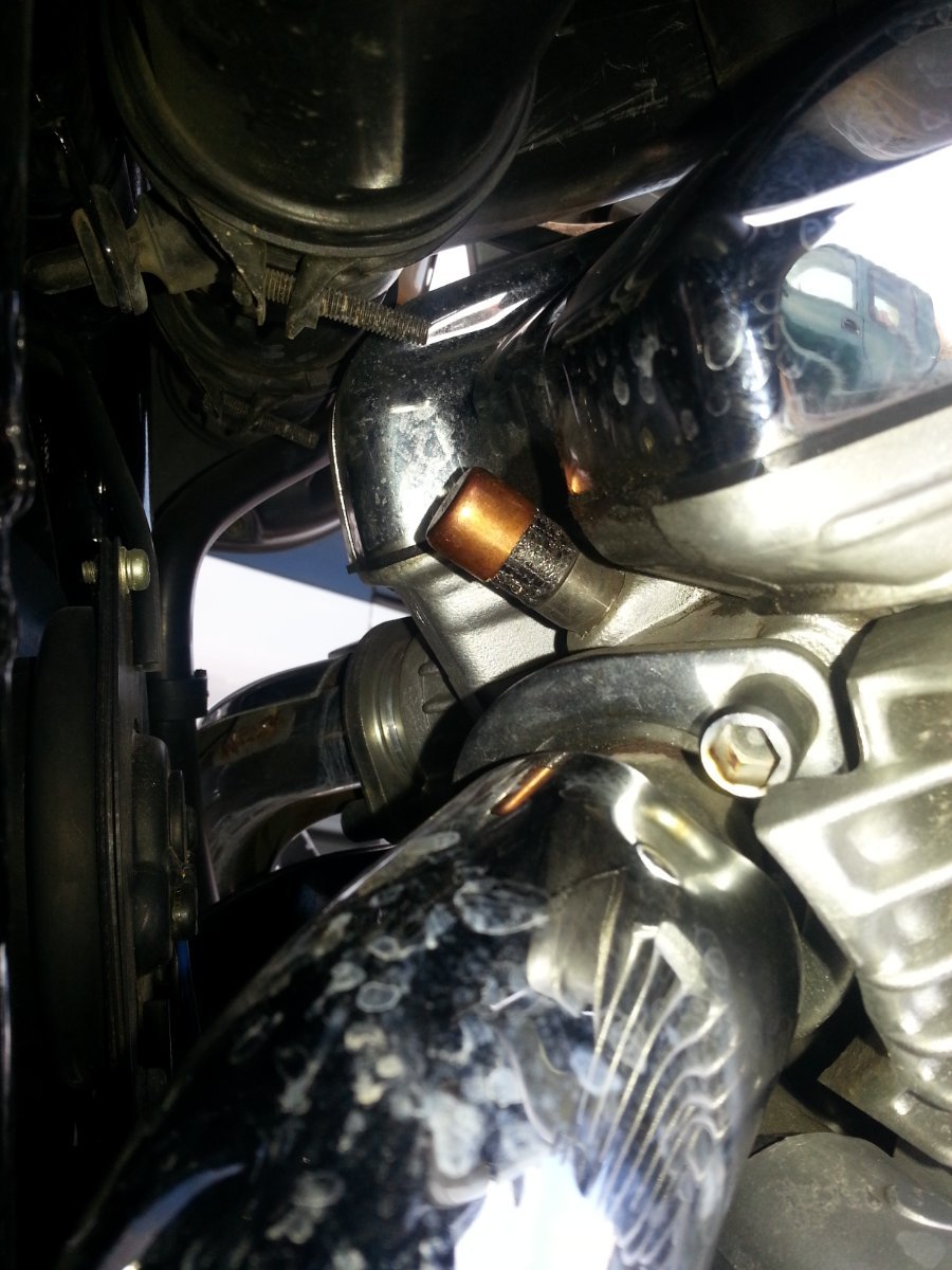

BratmanXj Posted September 29, 2023 Posted September 29, 2023 On 9/27/2023 at 5:42 AM, Russ said: #22 looks like it! How urgent is this to replace or can it wait until I put her up for the winter? I gutted the AIS system from my bike all together... I capped the ports on the cylinders with 1/2" copper plumbing caps. I may have that part in my bin O spares, I'll take a look this weekend. 1
Russ Posted September 29, 2023 Author Posted September 29, 2023 20 hours ago, BratmanXj said: I gutted the AIS system from my bike all together... I capped the ports on the cylinders with 1/2" copper plumbing caps. I may have that part in my bin O spares, I'll take a look this weekend. That'd be awesome! What exactly does that system do? It sounds like it's not really needed.
BratmanXj Posted October 2, 2023 Posted October 2, 2023 On 9/29/2023 at 4:10 PM, Russ said: That'd be awesome! What exactly does that system do? It sounds like it's not really needed. I guess that was some of the few parts I didn't keep. Its an emissions control unit that injects a small puff of air into the exhaust pipe to cause a secondary burn of any unused fuel coming out of the engine. I've disabled it on a few bikes during tuning with no adverse mechanical results, but obviously slightly higher emission out the tailpipe .
Russ Posted October 2, 2023 Author Posted October 2, 2023 1 hour ago, BratmanXj said: I guess that was some of the few parts I didn't keep. Its an emissions control unit that injects a small puff of air into the exhaust pipe to cause a secondary burn of any unused fuel coming out of the engine. I've disabled it on a few bikes during tuning with no adverse mechanical results, but obviously slightly higher emission out the tailpipe . Thanks for checking. I'll probably leave it as is for now and then look into either replacing or repairing it this winter. Thanks again!
BratmanXj Posted October 4, 2023 Posted October 4, 2023 Yamaha Air Injection System AIS Removal or Disable XVS 650 This is for the 650, but its basically 1/2 of our engine and the concepts still work. I was able to use 1/2 copper plumbing caps right at the port on the heads by re-using the stainless wadding from the original piping and lightly tapping it on.
