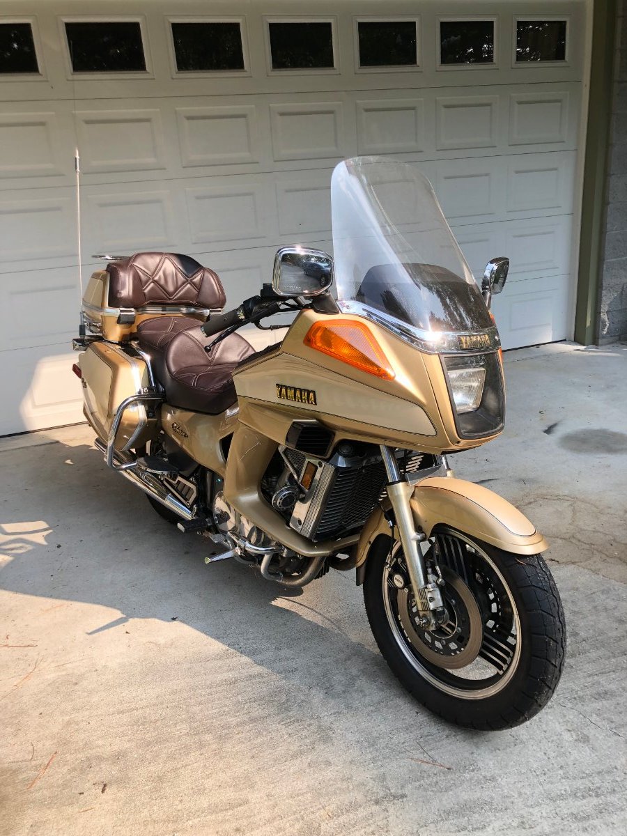

Vickersguy Posted September 4, 2023 Posted September 4, 2023 (edited) So I started out like all of us, at 2 1/2 turns out on the pilot jet screws after the carb rebuild. First plug check was black and soot covered on all 4 plugs. Went on the process of leaning out the pilot jet in steps. Went to 2 turns and #2 cyl. was close to good, the rest unchanged, still sooty. To cut to the chase, down to 1.1/4, 1 1/2, 1/3/4, and 2. The sooting is almost gone but the new issue is that the bike is now almost impossible to start. Have to get the choke just right or it cranks forever. No power below 4000 rpm, #2 plug is wet and smells of gas. Once it starts the idle seems OK. It has barely acceptable power over 4000 rpm but not the power I hear folks describe. I'm beginning to think that possibly the pilot screws were over tightened at some point. Are the symptoms I'm dealing with consistent with this kind of damage ? In my mind, I'm thinking that at hi vacuum, the fuel flow would be adequate but as the throttle valves open and the vacuum drops, the fuel flow would be starved, or maybe I have that backwards. Anyway, I suspect #2 cylinder is not firing at idle because the right hand exhaust is significantly warmer feeling than the left exhaust. I'm going to give the bike a run tomorrow and do another carb/plug check after the new adjustments. If this isn't sorted out I will tear down the carbs and clean them AGAIN. It would seem though that this won't fix the issue. Those carbs are clean. If it remains screwed up I suspect it is damaged pilot valve seats. Anyone else chase this issue down ? Is what I'm seeing consistent with damaged pilot jet seats ? Edited September 4, 2023 by Vickersguy spelling, clairity

Vickersguy Posted September 10, 2023 Author Posted September 10, 2023 (edited) Well, this is where I ended up. When I got the Venture, it would only run with the choke on. That is a classic. Dirty carbs ! Not an issue ! So I bought it. Took it to my garage and did the carbs. The instrument panel didn't work either, and I got that all repaired. Greased the speedometer cable. Got the class system on line. Did new stainless brake lines, rebuilt the calipers and installed new pads. Fixed the sensor issue in the rear master cylinder. Did two valve adjustments when I found the bad data in the original owners manual. New tires were purchased and installed, final drive lube changed along with the engine oil and new filter. ( Have to do the clutch and front brake master cylinders yet ). Something was not right. There was no power and sometimes it seemed to drop a cylinder. Hard to tell which one... Changed out the plug wires, plugs and did a coil check. They were fine. I dipped into the TCI to be sure it was 100%. Changed out a bad capacitor but got no improvement. But it ran rich, so I redid the carbs, reset the float levels Installed and balanced them AGAIN. Still ran rich. Turned the pilot screws in by 1/8 turns to lean it out. Then it started running slightly leaner, but also lost power. It also became almost impossible to start. Finally, the #2 cylinder stopped working at all. Spent several hours just staring at the thing. What had I missed ? You gotta have spark and I proved that was good. Gotta have fuel and I got that 100%. That leaves air. I never checked the compression. It never occurred to me, that just because the bike starts and runs, that it might be bad. How could it be bad ??? I just put 40 miserable miles on it and it ran like garbage, but it ran ! Well, that is what the problem has been all along and I never spotted it. I got 92, 98, and 102 PSI. ( Should have 170 ) Didn't even bother to check the fourth cylinder. If I ever want to run this bike I have to do a valve job and might as well do the 2nd. gear issue at the same time. I don't know. It's a big job. It will cost about $800. I'm an older man and have other stuff to do. I'm 70 next month and by the time I finish this I may lose another year of riding. I just lost this year. I was ready to go May 1st. this year. I spent the entire summer's free time wrenching. I am really sick of working on this bike and now I have a HUGE job to do. She looks purdy but I think she wants to kill me..... Edited September 10, 2023 by Vickersguy missing whineing
