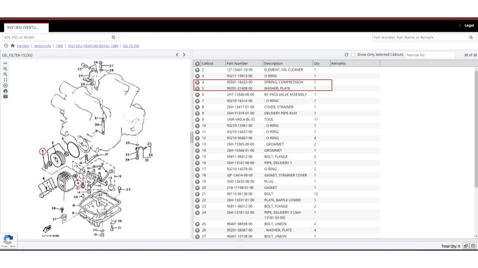

TTrax Posted June 19, 2023 #1 Posted June 19, 2023 Good evening. On some sort of coincidence, I stumbled across the oil filter parts page on the Yamaha website and noticed apparently I have been missing some parts since I owned the bike. The owners manual and the service manual doesn't mention it during the oil filter changing procedure. I ordered the missing parts and installed today. Really didn't notice a difference other than it seems to be more of a PITA to get the threads started in the block. I just hope there hasn't been any long term damage. Looking at the construction of the bypass valve, I was thinking that either the bypass function has been disabled, or the filter has been bypassed letting unfiltered oil back into the lubrication system. Either is not good. I just went over 93K miles and still doesn't use a drop of oil that I can tell so hoping no issues. I can't see oil pressure so it would be hard to say if it is lower or higher than normal. Has anyone else removed these components for any reason? Trying to determine why the original owner would have discarded these parts unless there is a reason I can't think of.
Marcarl Posted June 19, 2023 #2 Posted June 19, 2023 Somebody didn't know what they were doing. It was much easier to install without the spring than with it and after all the filter was in place isn't it? The spring holds the filter tight against the engine and if the filter should plug for some reason it will be pushed out of the way so that oil will still be processed through the engine. Looks to me like the previous filters weren't used a whole lot, other than filling a void in the cover. You should be just fine I think. 1
Abnorml Posted October 19, 2023 #3 Posted October 19, 2023 So if the spring isn't there, then the filter could be pushed away from the block and there would be no filtration of the oil? I didn't know there was supposed to be a spring in there until I saw this post. I guess I'd better find one for my 83. 1
Marcarl Posted October 19, 2023 #4 Posted October 19, 2023 46 minutes ago, Abnorml said: So if the spring isn't there, then the filter could be pushed away from the block and there would be no filtration of the oil? I didn't know there was supposed to be a spring in there until I saw this post. I guess I'd better find one for my 83. You got that right. 1

FaceDeAce Posted July 29 #7 Posted July 29 Same issue on my ‘84 been resurrecting. No spring, no washer on the oil filter. I went into my parts bin. For the washer, I used a standard 20mm flat washer. For the spring, I grabbed a piece of stiff brazing rod and made a 21mm ID spring. Eyeballed the cut the length of the spring and based on depth of where the filter is supposed to sit in the cover and when set against the engine oil port.
