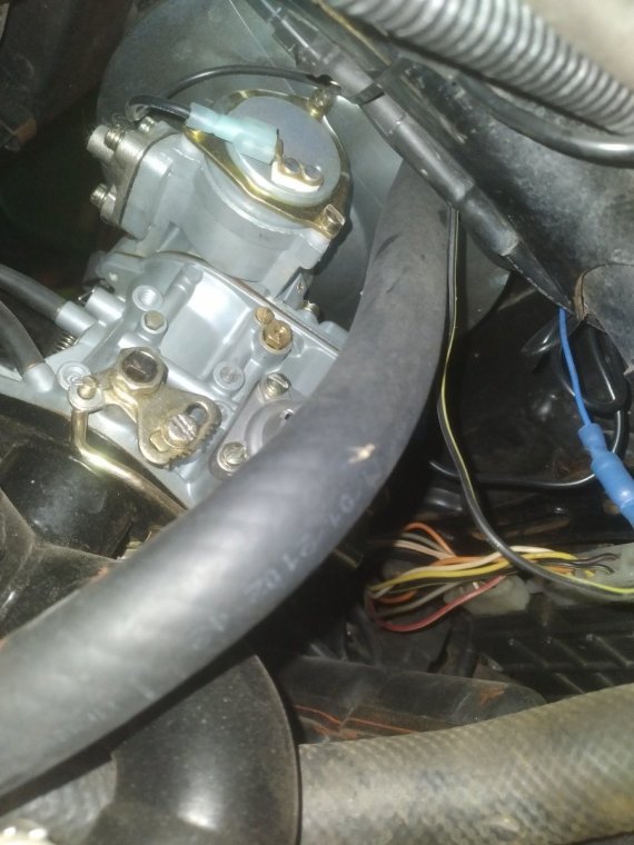

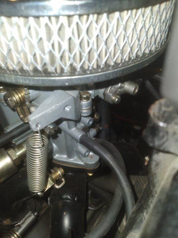

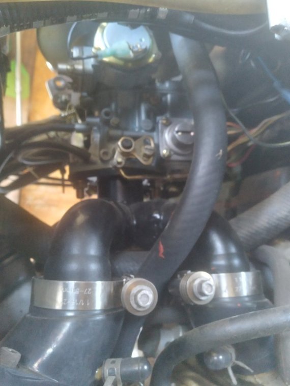

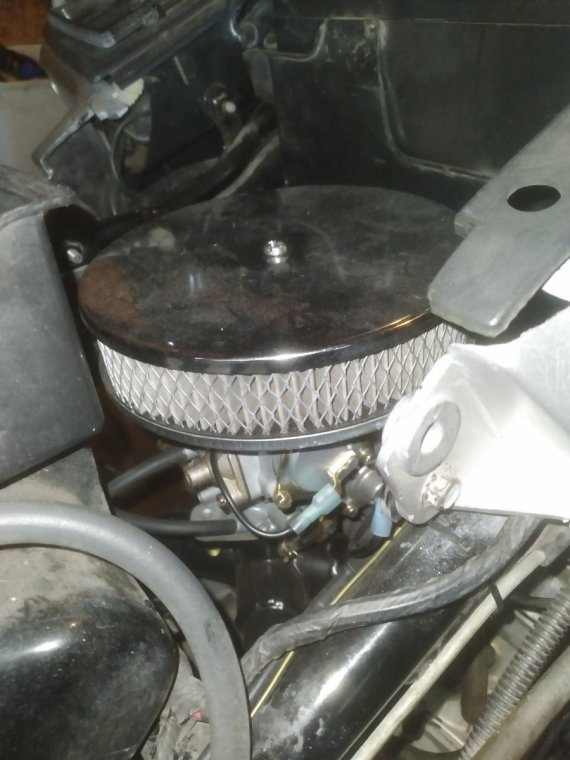

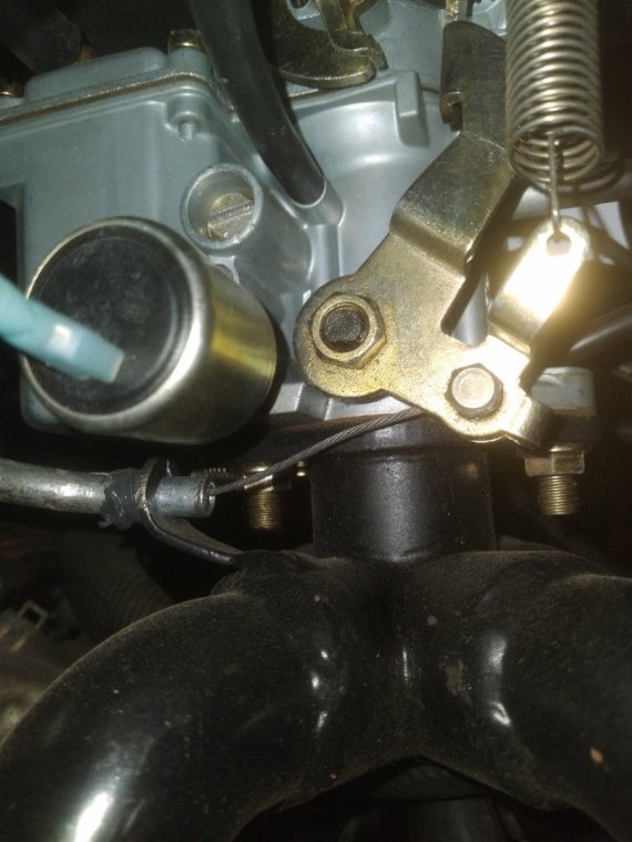

Baldphil Posted June 11, 2023 Author #4 Posted June 11, 2023 On 6/10/2023 at 4:17 PM, Marcarl said: Super! Maybe you could give us the particulars on the setup and where you found it all. Expand Got it through ebay. Manifold and carb together. Fairly easy setup. Picked up some heavy duty clamps. The originals won't work. Also got a small chrome air breather with an outlet for the crankcase breather hose. Connect the choke and fuel shut-off to the accessories screw. I connected the ground to one off the float bowl screws. The carb has 3 vacuum outlets. Connect one of the bottom ones to the the vacuum advance. Then I just looped the other bottom one the the one on top. Notice that I set the accelerator pump screw up 2 notches from the bottom. Once it was all hooked up, I watched a Volkswagen beetle YouTube video on how to set the carb screws. Only need the pull throttle cable. Hopefully the pic will show how I connected the cable. I zip-tied the choke and return cable up out of the way. Such a joy to go out, give the throttle a twist and here the choke engage 20230611_192400.mp4 1
