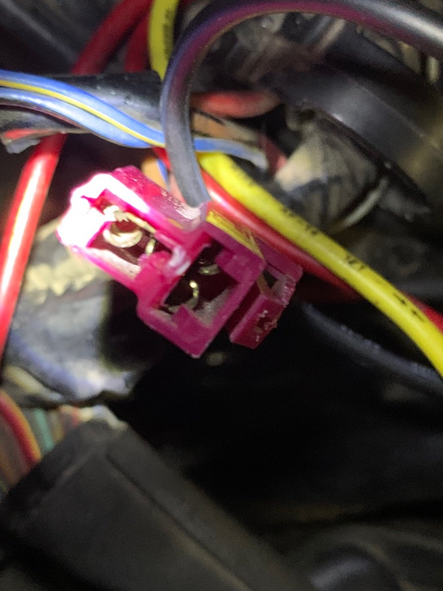

RoTorKev Posted June 5, 2023 Author Posted June 5, 2023 Thanks for the replies, I installed a new starter solenoid, did not fix the problem, looked at the start button and it looks ok, connected the battery with the start button disconnected and still gettin power on with the ignition in the off position. Any advice on where to look next would be greatly appreciated.
RoTorKev Posted June 5, 2023 Author Posted June 5, 2023 I have a new connector on the way. I’ll post an update when I get it installed.
RoTorKev Posted June 6, 2023 Author Posted June 6, 2023 Fixed! It was the connector pictured in my previous post. Put in a new one and everything is working normally.
