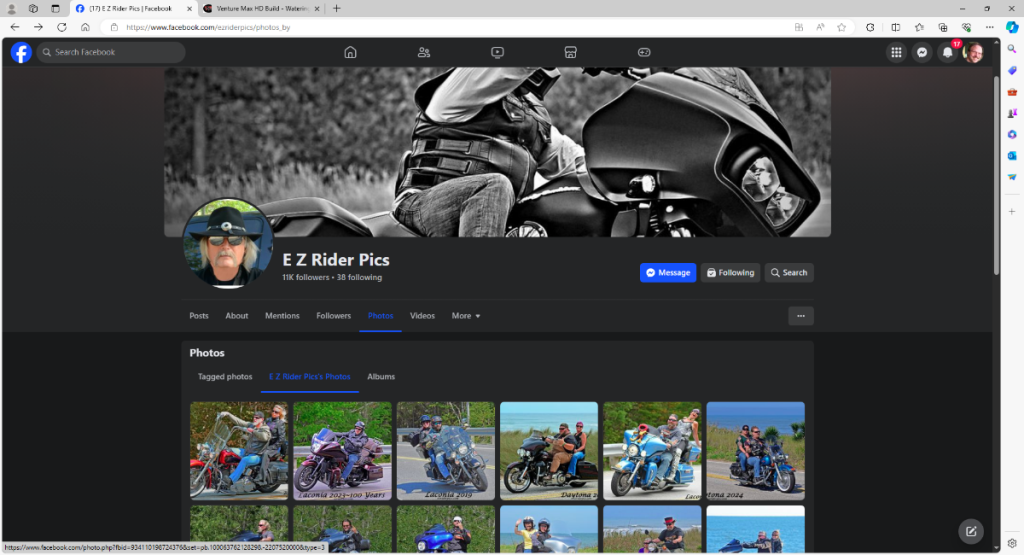

HermanK84VR Posted April 10, 2024 Author #88 Posted April 10, 2024 Hi All I hope you all had a good winter Biking season is coming soon, I just purchased my KancaMagus Digital Photo from E Z Rider Pics and Mike has it posted on his Facebook Page. The 1984 Venture Max HD has hit the Bigtime LOL Go to his facebook page and hit like on my photo the most liked photo gets a free 11x14 souvenir photo. Happy riding to all this coming season Herman K
