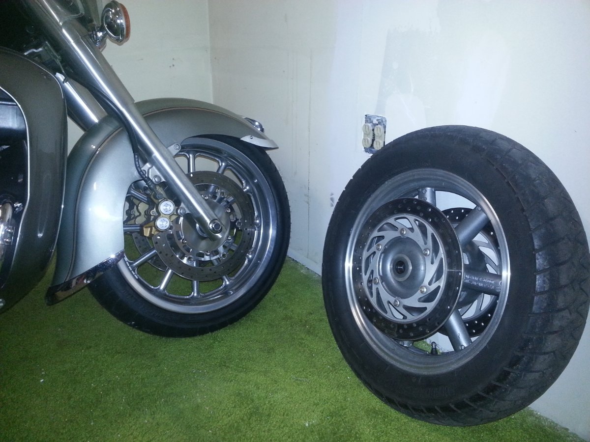

Freebird Posted October 25, 2022 #1 Posted October 25, 2022 Made a little modification today. I like it but haven't tried it out yet. Anybody spot the change? 1
Motorcycle Mike Posted October 25, 2022 #2 Posted October 25, 2022 I see a few after market Items on there. The trim on the front fender? My side cover is black. The plastic on the bottom of the fairing looks larger than mine. No, now I see it, The front wheel. What do I win? 1
Freebird Posted October 26, 2022 Author #4 Posted October 26, 2022 15 hours ago, Freebird said: Made a little modification today. I like it but haven't tried it out yet. Anybody spot the change? You got it. I actually did add the front fender rail a while back but installed the wheel and new tire yesterday. Love the look but don’t know yet about the ride and handling. I’m optimistic though. Chromed Stratoliner wheel. Decided to leave the pie plates off. Can always put them back on later if I decide to. 1

dueyk1111 Posted October 26, 2022 #8 Posted October 26, 2022 so a dummy question here, is the stratoliner rim smaller? 🤔

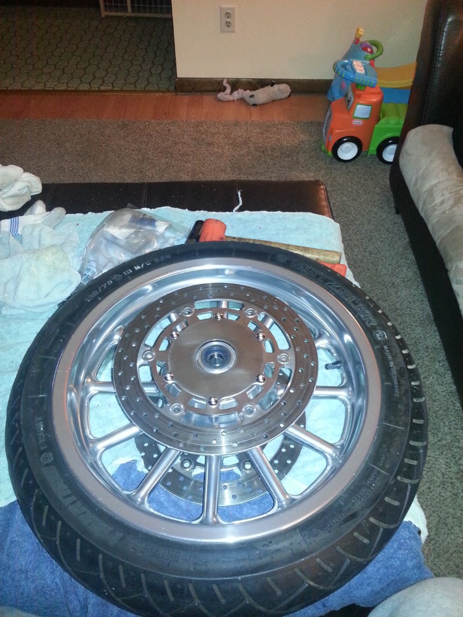

BratmanXj Posted October 26, 2022 #9 Posted October 26, 2022 30 minutes ago, dueyk1111 said: so a dummy question here, is the stratoliner rim smaller? 🤔 Stratoliner is an 18" wheel with a 130 tire that's a direct bolt on to the Ventures. Upgrades the looks with the bigger front wheel, lightens the steering with the 130 (vs 150 stock) width front tire. If you get REALLY lucky and find the chrome Stratoliner rotors they're full-floaters vs our solid disk on the Venture.

Freebird Posted October 28, 2022 Author #13 Posted October 28, 2022 @BratmanXj, I’m not very familiar with the full floating discs What are the advantages?
BratmanXj Posted October 29, 2022 #14 Posted October 29, 2022 22 hours ago, Freebird said: @BratmanXj, I’m not very familiar with the full floating discs What are the advantages? The braking ring is supported by rivets with a light metal (typically aluminum) inner mounting ring. They're slightly lighter, not that it maters on our big o'l bikes. They dissipate heat a little bit better and since they float your less likely to have pad chatter. Biggest thing....they're chrome an match the "lighter" look of the bigger wheel with more open space than the stock rotors. 1
