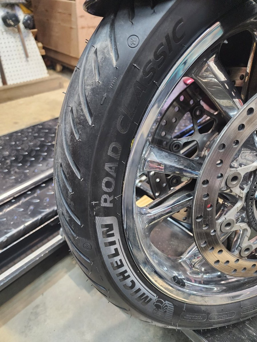

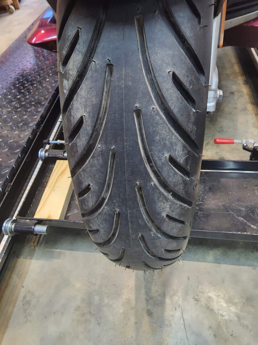

Woody Posted September 24, 2022 #1 Posted September 24, 2022 While we were at Asheville I noticed the front tire was getting close and then we went to Maggie Valley and by the end of it I knew I needed a front tire. Well we got it mounted and installed yesterday it is a Michelin Road Classic rear tire in reverse so we gonna give it a try. 3

luvmy40 Posted September 25, 2022 #4 Posted September 25, 2022 OK fella's, educate me. What's the purpose of a rear rated tire on the front and why reverse the rotation? 2
Woody Posted September 25, 2022 Author #5 Posted September 25, 2022 Just now, luvmy40 said: OK fella's, educate me. What's the purpose of a rear rated tire on the front and why reverse the rotation? you get a lot more miles, most have a flatter contact patch on the road. reversing it put the carcus plies in the correct direction in order to make the tire stronger and not separate. When the tire is used on the rear most of forces on the tire are on acceleration and when it is on the front most of the forces come from braking. 2

bpate4home Posted September 26, 2022 #9 Posted September 26, 2022 Everything I've read about Double Dark, CT on the Back and rear MC on the front, says exactly the same. Longer life and reverse the rotations for the proper strength on the belts of the tire. People have been doing this for far more than 8 - 10 years.

Woody Posted October 8, 2022 Author #16 Posted October 8, 2022 Okay got a chance yesterday to get the new off of the Michelin Road Classic tire, Mike and Shirley came over and we enjoyed a 170 mile ride through some of Alabama's country side. I think I am going to like this tire we tried it out at all speeds and road conditions. Good friends and a good ride on a motorcycle equals a great day to be alive. 1
