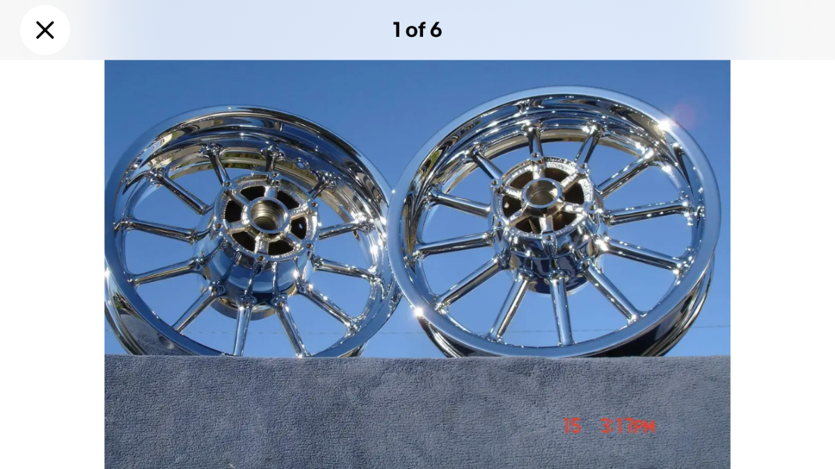

Chopperdavemays Posted September 20, 2022 #1 Posted September 20, 2022 1999 Yamaha royal star venture wheel upgrade help One picture is of my 1983 Honda bobber I restored last winter and yes I’m on the Honda shadow forum as well the reason this picture is on here is because I am painting my Yamaha venture this color to match. The venture in the picture is mine and the wheels are what I need help with the wheels in that picture are strata liner wheels I need to know if they’ll fit my venture some people say they will some people say they won’t. I appreciate any help I can get from any of you before I pay $750 for the front and back wheel or if anybody knows of a site we can buy aftermarket chrome wheels for our ventures I’d appreciate that info too. Thanks for any help in advance and from what little I’ve looked on this forum so far you guys rock thanks again Chopperdavemays
Freebird Posted September 21, 2022 #2 Posted September 21, 2022 I know that the front wheel will. Several have done that. I don't know about the rear wheel though. I'll say though that sounds like a good price. Much cheaper than I've seen them if they are new. I looked for the front wheel only but the only ones I found were on Ebay and they wouldn't sell just the front.
BratmanXj Posted September 21, 2022 #3 Posted September 21, 2022 I was able to get my Stratoliner front wheel & floating chrome S rotors back in '14 for under $200 used off eBay (add a tire and wheel bearings to that cost). I think $750 is a bit steep for used. The REAR wheel does not fit the Ventures, we're shaft drive and the other Star bikes are belt drive.
Chopperdavemays Posted September 23, 2022 Author #4 Posted September 23, 2022 Please if anyone can help these Yamaha Strataliner wheels are 06 to 14 Will they fit my 1999 royal star venture?
Chopperdavemays Posted September 23, 2022 Author #5 Posted September 23, 2022 Thank you Bratman and Freebird that helps a lot
