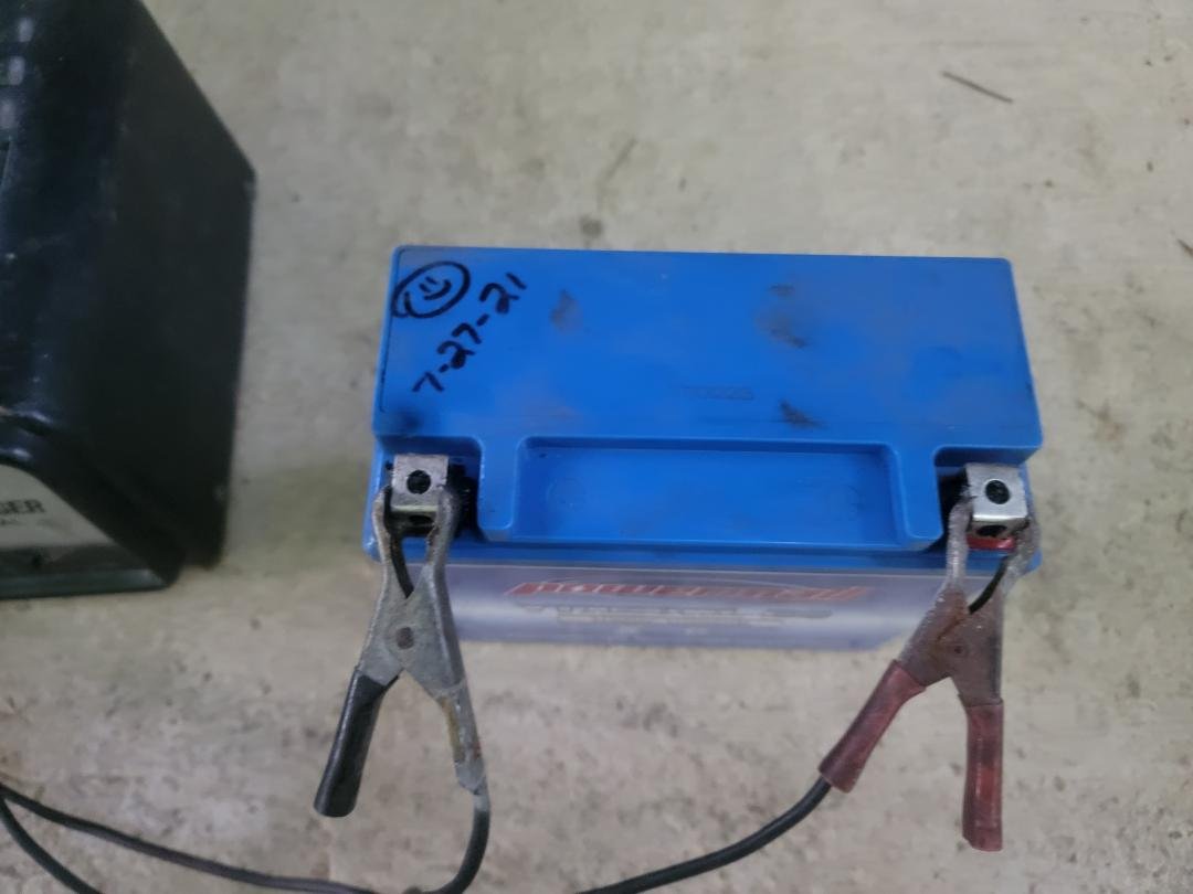

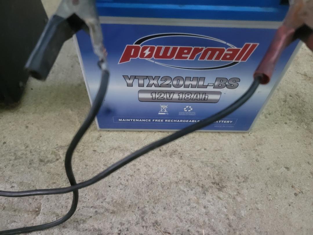

uncledj Posted August 3, 2022 #1 Posted August 3, 2022 I'm heading out on a trip with friends up to the cabin, and going over the bike, I decided to put a new battery in it. Haven't ridden for a month or so and the battery was dead. Charged it up, then went for a 1/2 hour ride to get it charged up; put the bike back in the shed and 2 days later it's weak. Down to 9.7 volts. So I replaced it. It was a year old AGM, NOT on a tender, and I've now replaced it with a lead-acid. I've had this bike since 2012 and I think there was only one year that I didn't feel the need to replace the battery. I've done the basic checks, making sure any accessories are disconnected when she's sitting, but the problem persists. Is there a common issue that would cause the slow drain that's killing these batteries? Not a major issue, but I"d like to get it resolved. Now that I've put a lead-acid battery in it I'll leave it on a tender again, but it's aggravating when you turn the key and nothing happens.
Freebird Posted August 3, 2022 #2 Posted August 3, 2022 Well, it does seem a bit extreme to be down to 9.7 volts after only a couple of days. I know that they will go down due to things like the clock and etc. but I didn't think it would happen that quickly. I can't say for sure because I always leave mine on a battery tender, regardless of the battery type, all the time. 1
RDawson Posted August 3, 2022 #3 Posted August 3, 2022 I went through one per year on my 86 using lead acid. Went to AGM and got 5 years out of the last one never using a tender. Seems a little extreme.
WildBill1 Posted August 3, 2022 #4 Posted August 3, 2022 I've got up to (8) years out of my AGM's using a battery tender occasionally. I use Deka brand batteries in my bikes.
saddlebum Posted August 3, 2022 #5 Posted August 3, 2022 (edited) I am currently on year eight with my Deka AGM and it is still going strong. Generally keep on a battery tender through the harshest winter months but I have had years where I have forgot to hook it up and I never disconnect the battery from the bike, yet still the bike would just barely crank over. I would then put it on the battery tender overnight and it would be good for another season. If it is dropping off as fast as you say I would suspect a parasitic drain condition try disconnecting the ground cable from you battery when you store the bike and see if it still occurs. Edited August 3, 2022 by saddlebum 1
