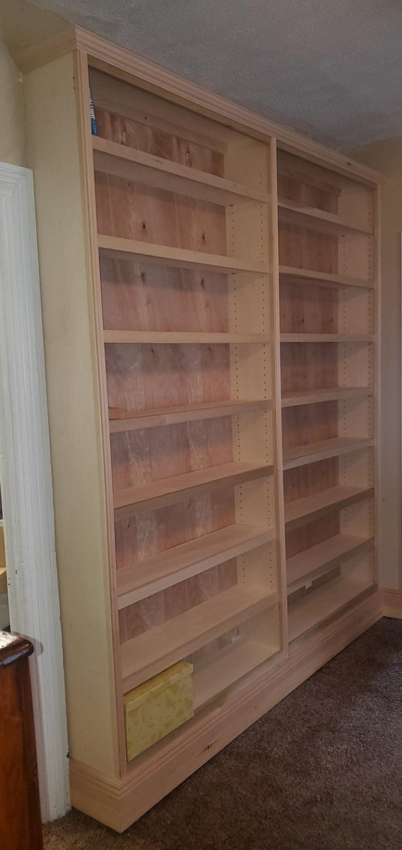

I paid the bills as trim carpenter for quite a while. Custom kitchens, coffered ceilings, full room built ins, the whole shebang. After 25 years in the refrigeration world, I dove back into carpentry to start on our "new" house's( built in 1890) library.
I went to Harbor Freight and got their Hercules 12" compound sliding miter saw with portable stand, the Hercules 10" portable table saw and ordered the Powertec rolling, folding table saw stand on Amazon and got to work.
I have to say, the Harbor Freight tools I just got are so much better than the "professional" equipment I was using 25 years ago. At 1/4 the price we paid for the "pro" tools back then. It's actually ridiculous. They are really not even comparably in quality and performance.
So, here is the start of our built in library.

Carpentry finished. Ready for putty and paint.
Kris wants to use a period correct finish with "Milk Paint" so I was able to cheap out on the materials a bit. 3/4" "Sande" plywood for the carcass, a couple cherry picked pieces of 1/4" underlayment for the backs and poplar trim.
I made one mistake in planning. I neglected to check the floor for level before buying my moldings and did not account for the 1" out of level over the 84" run. Not a huge deal. I'll just cut some filler strips before Kris paints.
This turned out pretty good, but up close and personal, you can see the 25 years of slack! Seeing as they will be painted, good enough is good enough.
I have to say, the Hercules saws are punching way above their price point. It was a joy to work with them.

We are about 90% done with the first wall of shelves. The final coat of milk paint is done and the base coat of wax is done. We just need to wait for the wax to set and then do some dark wax detailing to make the rope mold accents pop. The base mold will be done with white semi gloss enamel to match the rest of the room.

We got started on the opposite corner of the room today. This will have the same basic design and all the same trim accents, but will "free standing" rather than "built in" as the original 130 year old base mold is still intact and serviceable in this corner.

Today's update:
Second half installed and faced. Kris wanted a drop front desk in these for her laptop and bills files. I's been a long time since I did an inset door, much less a drop front flush mount desk front. It's going to take some tweaking!

I just remembered that I never posted any pics of the final product. Well, almost final. I still need to paint the base mold, but the books and mess have all migrated to their new home.
