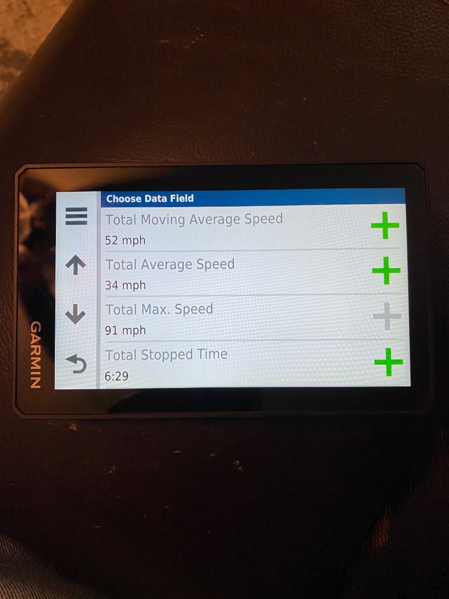

Pasta Burner Posted June 28, 2022 Posted June 28, 2022 Ok @cowpuc @skydoc_17 I’m really getting frustrated not knowing how to navigate this new GPS. It isn’t letting me see the data like it’s displayed BEFORE you save it, once it’s saved it converts to a .GPX file that I can’t figure out how to open. I think I need to get on my laptop rather than my phone. Anyway eventually I found a screen that kinda sorta shows the data I want to see, but can’t export it so I took a pic. I’m thinking “Total average speed” includes stopped time at red lights and whatnot.
