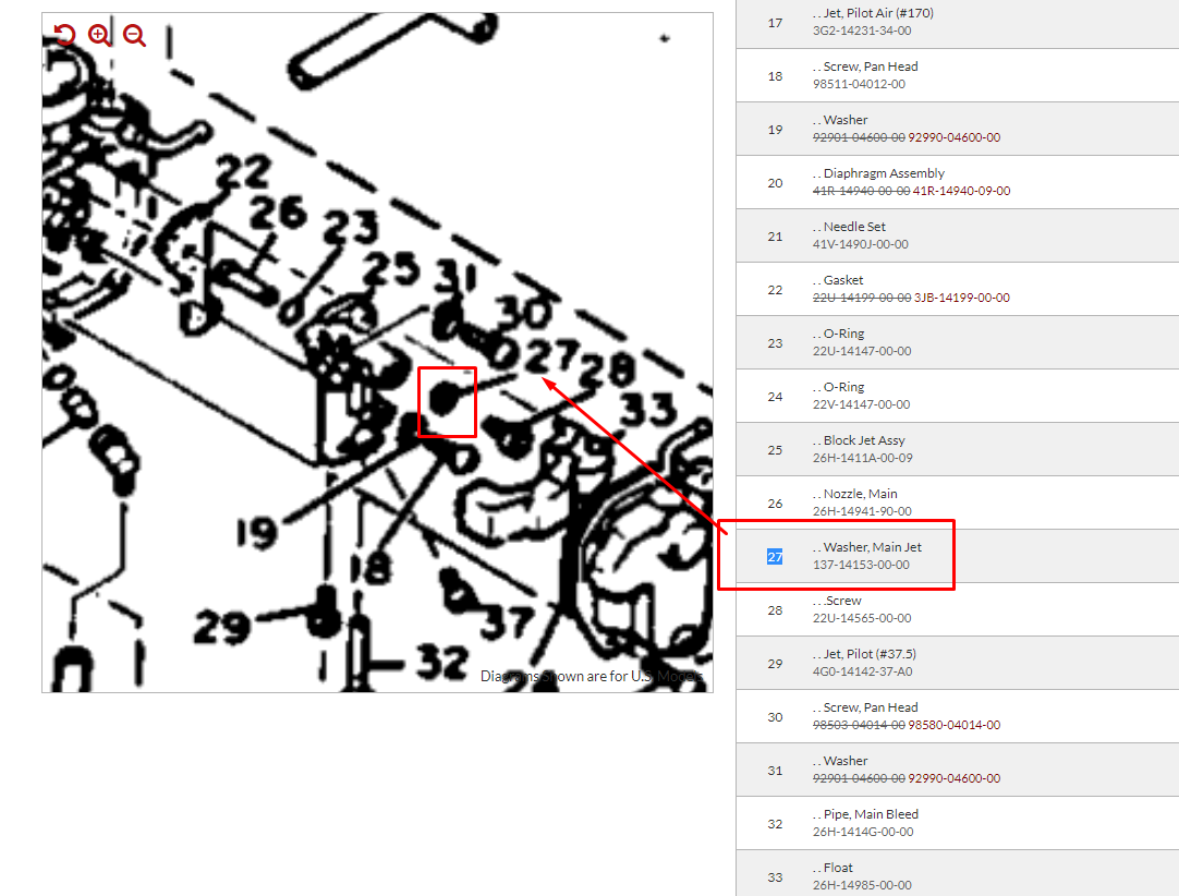

Solace Posted May 7, 2022 Author #29 Posted May 7, 2022 Hey all she’s running poopy again after I had her on the road. Hard to start. Cleaning again. This is what I was mentioning about a missing washer, thoughts?

cimmer Posted May 8, 2022 #35 Posted May 8, 2022 Yes you should have the o-ring, item, #23, in there on the tube. Also check and see how tight the rubber plugs, 40 & 41 are in the bottom of the jet block. They should be a very snug fit. A source for parts is in Ontatio, Sirius Consolidate Inc., https://www.siriusconinc.com/search_result.php?make=2&model=Venture Royale&part=All&partno=&x=56&y=16&search=search&start=0 They have different parts for you Venture. I would also check the carb diaphgrams for pin holes or tears. They do wear out over time. There really isnt a complete carb kit for these bikes and you need to source the parts from different places including Yamaha. Also you might need to replace the spark plug wires and caps as there could be corrosion in ends of the wires and also the spark plug caps. Be aware there is a small o-ring on my coil end of the wire so when pulling it out of the coil be sure not to loose it. Hope this helps you out. Rick F.

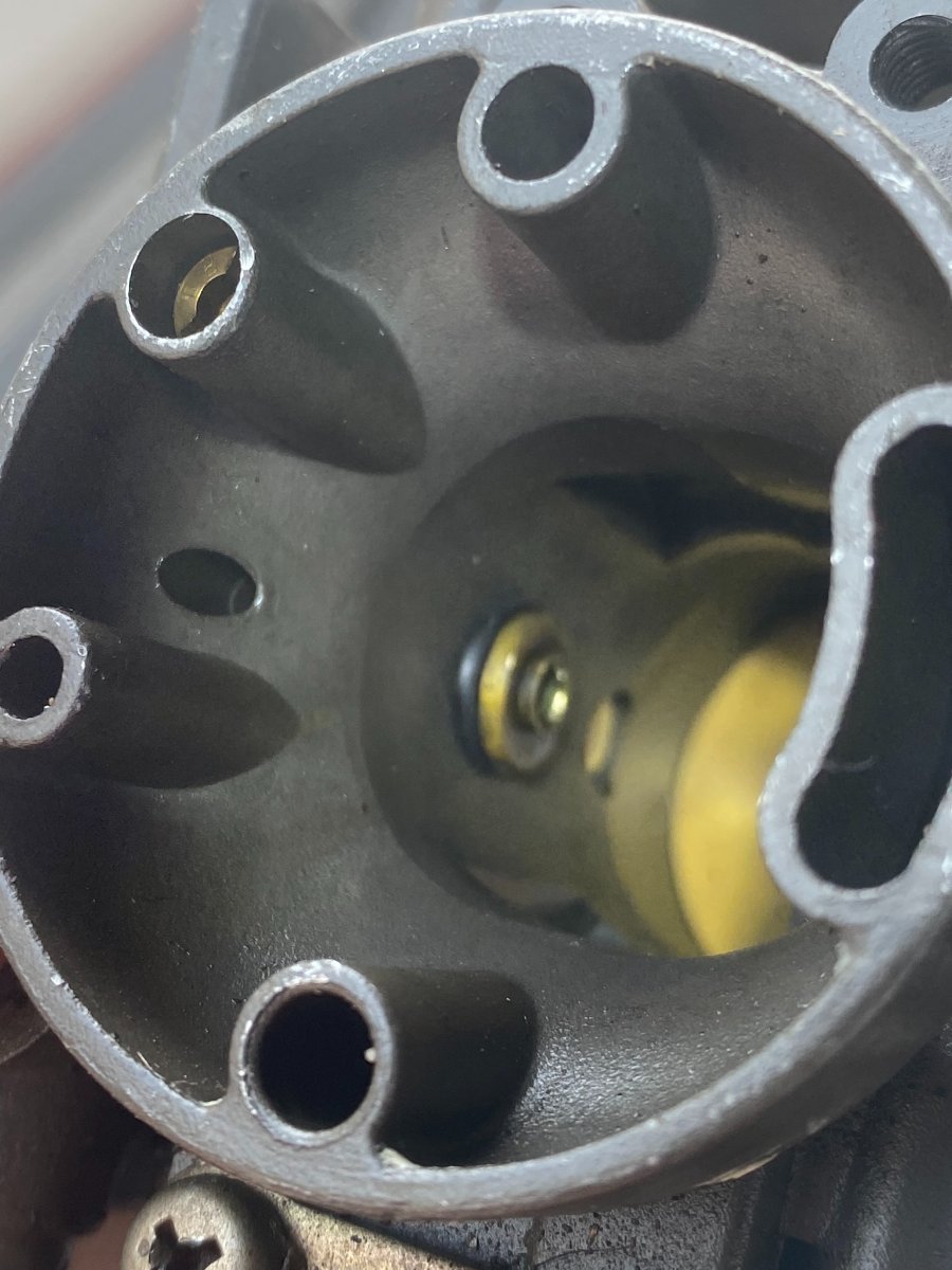

Solace Posted May 10, 2022 Author #41 Posted May 10, 2022 So looks like I am infact missing TWO "Washer, Main Jet" -- which explains why I'm only firing on 2 cylinders I think, because if this washer is missing the Main Nozzle will have 2mm of play and can wiggle, which changes the adjustment of the main needle by 2mm and does not properly stop fuel flow essentially flooding the entire carburator -- which also explains the back fire and woosh of smoke out of that side of the carburator! I have started replacing the ignition coils already which probably doesn't even need to be done 😕 But hey, new ignition coils are new ignition coils. Just need to find a replacement for a few washers and I think I might have a shot at riding this weekend!
cimmer Posted May 11, 2022 #42 Posted May 11, 2022 Those are available from Yamaha and that might the only place to get new ones. Check with some of the guys up in Ontario and see if they have a place they prefer to order from. Rick F.

Solace Posted May 12, 2022 Author #45 Posted May 12, 2022 Thanks all -- Yeah I'm looking at the CDI and Coils like, hey they don't often fail.. right? I will for sure clean the electrical connections wherever I see ability to clean it. I'm really hoping to get her working this weekend. I'm very sure what happened is those washers being missing would create a LEAN condition, the air would just pass right through that part where the needle goes into the hole. I found some nearly the same size washers, I'll try them, failing that I'll use some larger ones and grind them down. Fun fun fun. I did get the side panels, newer more aggressive exhaust, new fuse box (old one falling apart) and I'm really looking forward to the bike running soon! 1

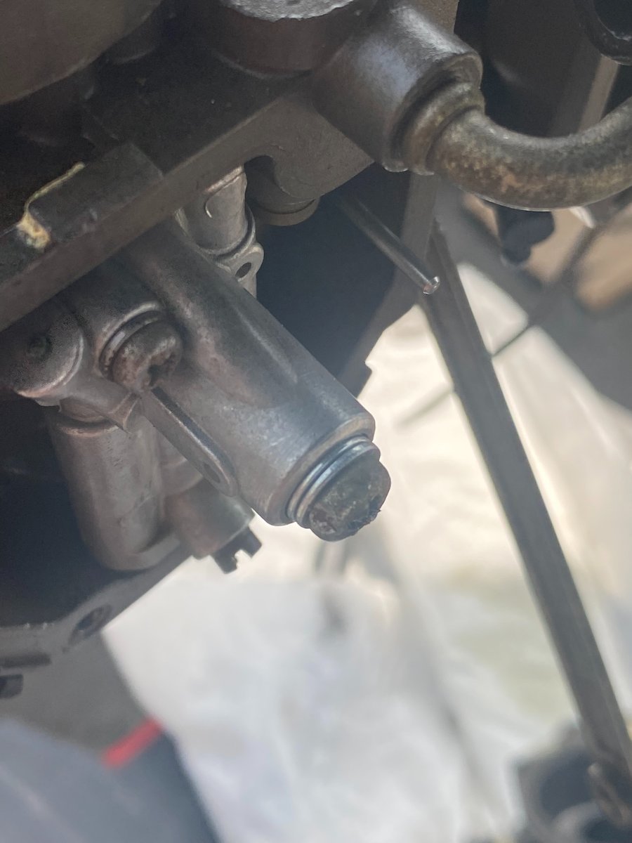

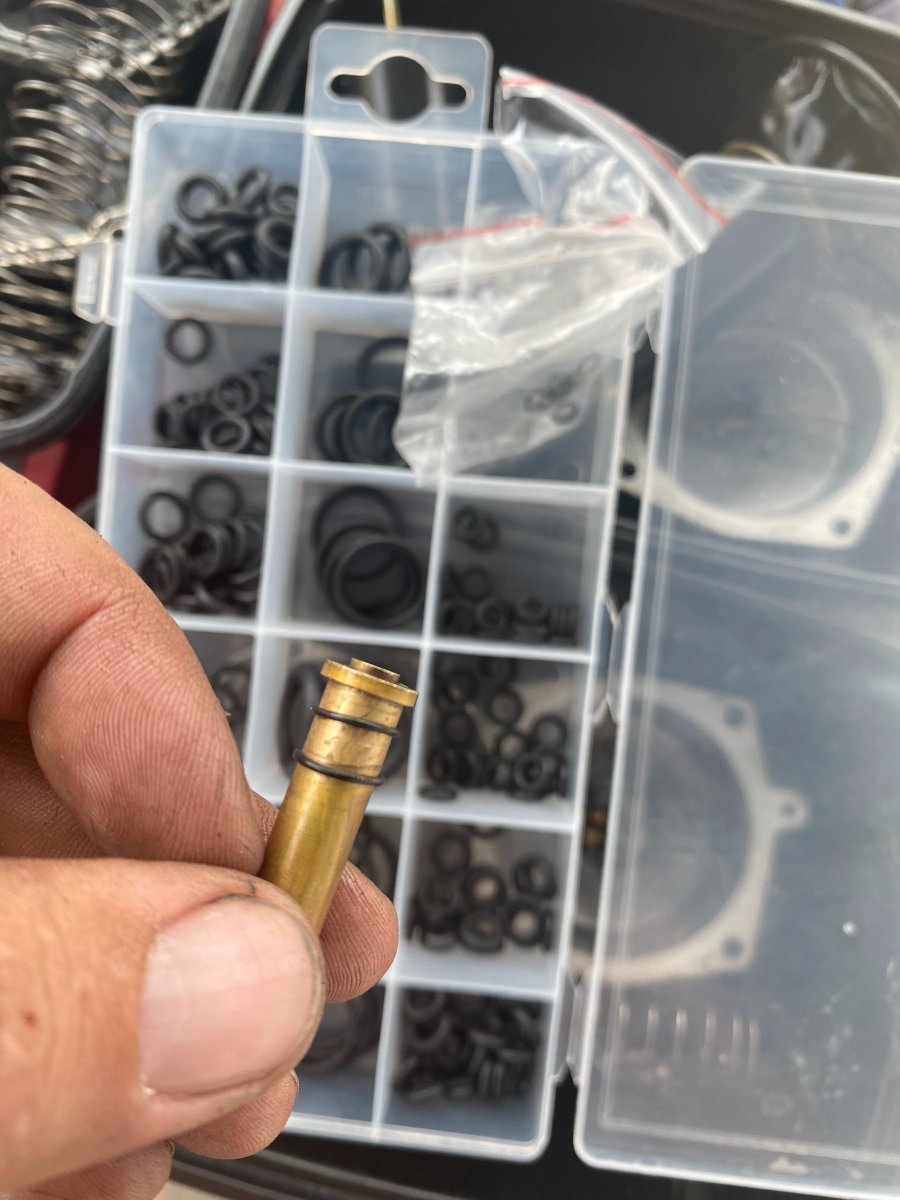

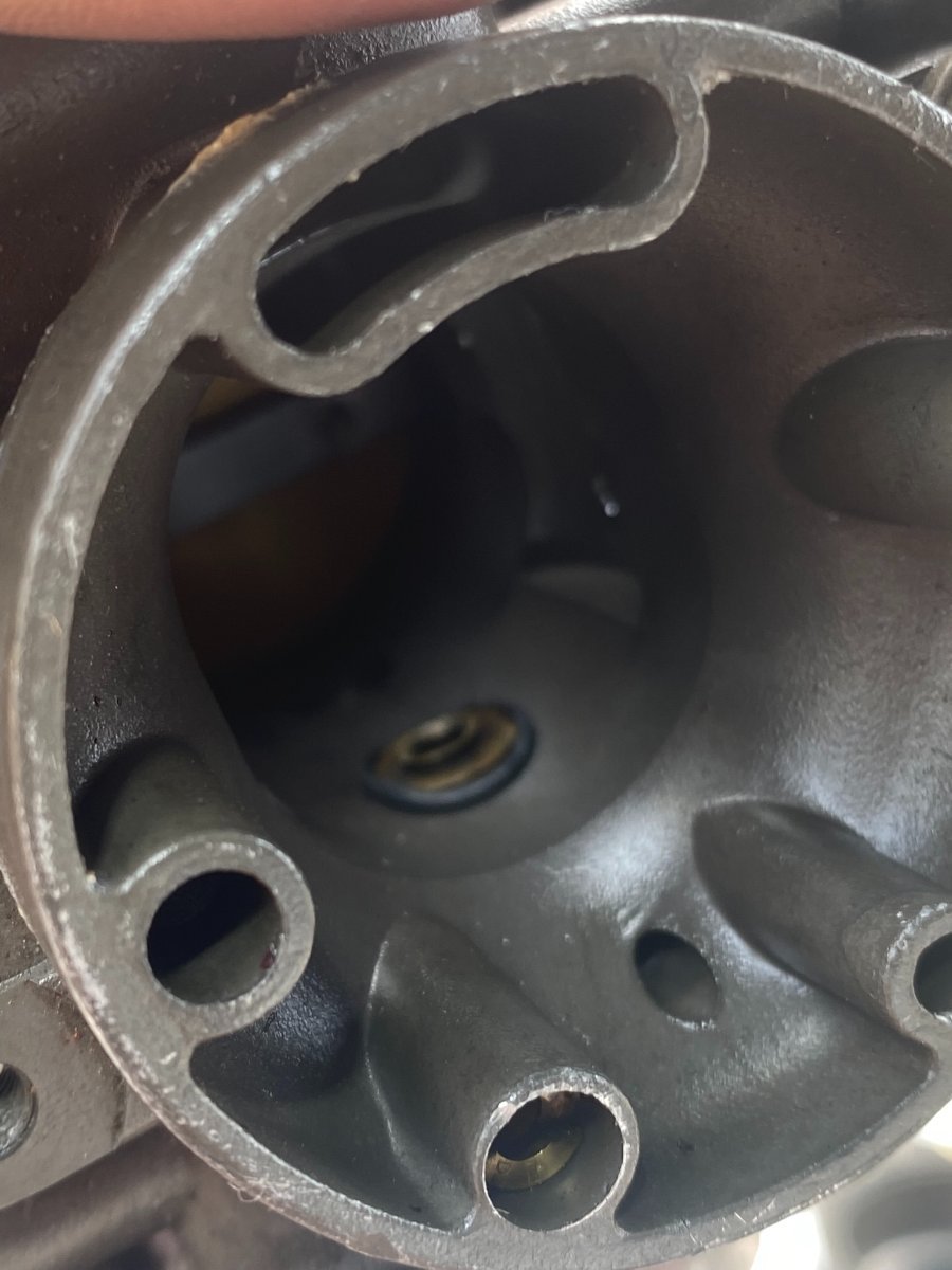

Solace Posted May 13, 2022 Author #47 Posted May 13, 2022 VICTORY! Well sorta. Upon inspection it appears that only ONE of the MAIN NOZZLE had o-rings. So what I did was a hack, 2 smaller o-rings out of a generic kit to try to fill the gap. You can see in other photos I'm kinda learning what they do, I installed way too fat of a ring and it doesn't fit. So looks like the last guy working on these just didn't bother with them, perhaps. Next up is the coil pack was certainly defective, and I have now by passed it. Simply cut out the old one, steal the adapter and I'm going to home it under the radio, and I will probably just do ALL coil packs. She still only starts with quickstart. But I can get her a little more quiet. I need to adjust the air/mixture screws for sure, I have a feeling they're outa whack from the last guy. I put my hand behind the exhaust and both pipes were HOT, where as last time the left pipe was half as hot. So the ignition coil was for sure a problem - you think I should replace all coils? REALLY excited that I may have it figured out today. IMG_1369.MP4

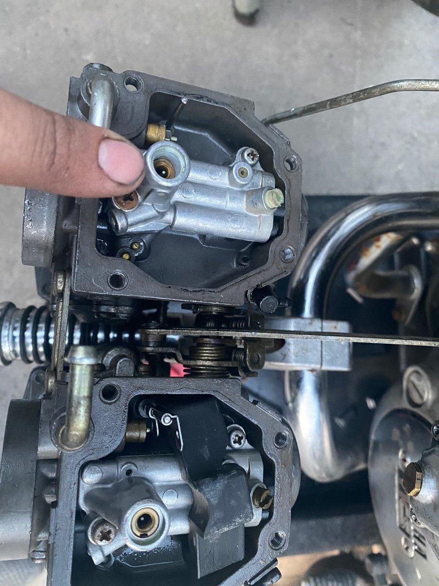

Solace Posted May 13, 2022 Author #49 Posted May 13, 2022 (edited) MORE PROGRESS! She wants to run so bad. Still only starting on starter fluid, was able to get her down to a nice idle, but she started surging rev up downnnnnnnnnnnnn upppppppppp downnnnnnnnnn. Turns out one of the carbs is flooding over and spitting a lot of gas out. Just one carb. I also made sure to re-attach and double check the airbox fittings, some of that was sloppy, had to grease the inside of the boot and it sat down perfectly. Hooked up more various connections things are running better. I did not however hook up that big fat hose to the air box because how the hell do you do that lol, I'm gonna get a slightly longer hose and refit it. Here she is wanting to run! SO CLOSE I can taste it. I believe the float may be stuck or installed incorrectly (lazy / tired?) so it's emptying out, then pumping too much fuel, emptying out, too much fuel, etc and I believe that's what is causing the surging. One more time I will have to take the carbs apart... maybe later tonight. wantsa.mp4 Edited May 13, 2022 by Solace
Solace Posted May 13, 2022 Author #50 Posted May 13, 2022 Yep on double checking, one of the carbs is like... maybe I forgot the needle entirely kinda sticking. Fix that, maybe fix bike...
