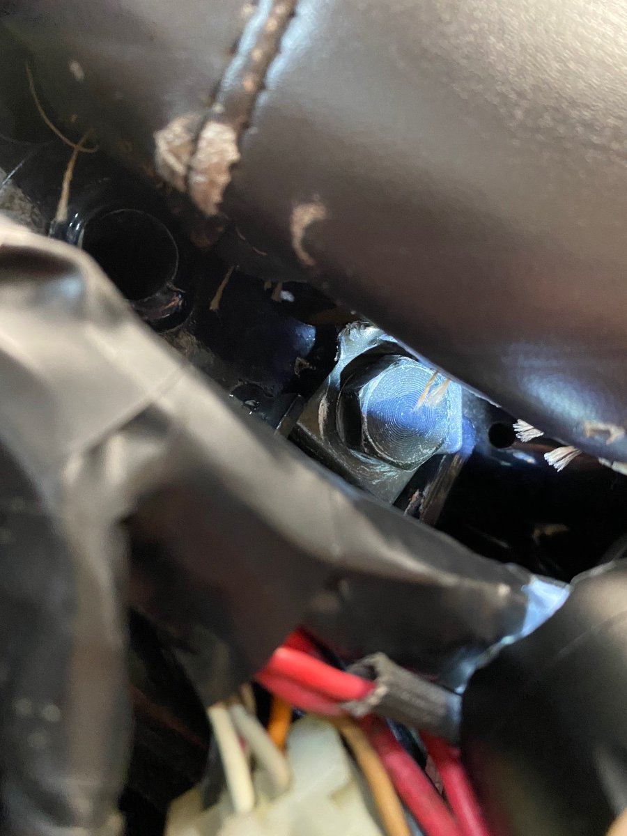

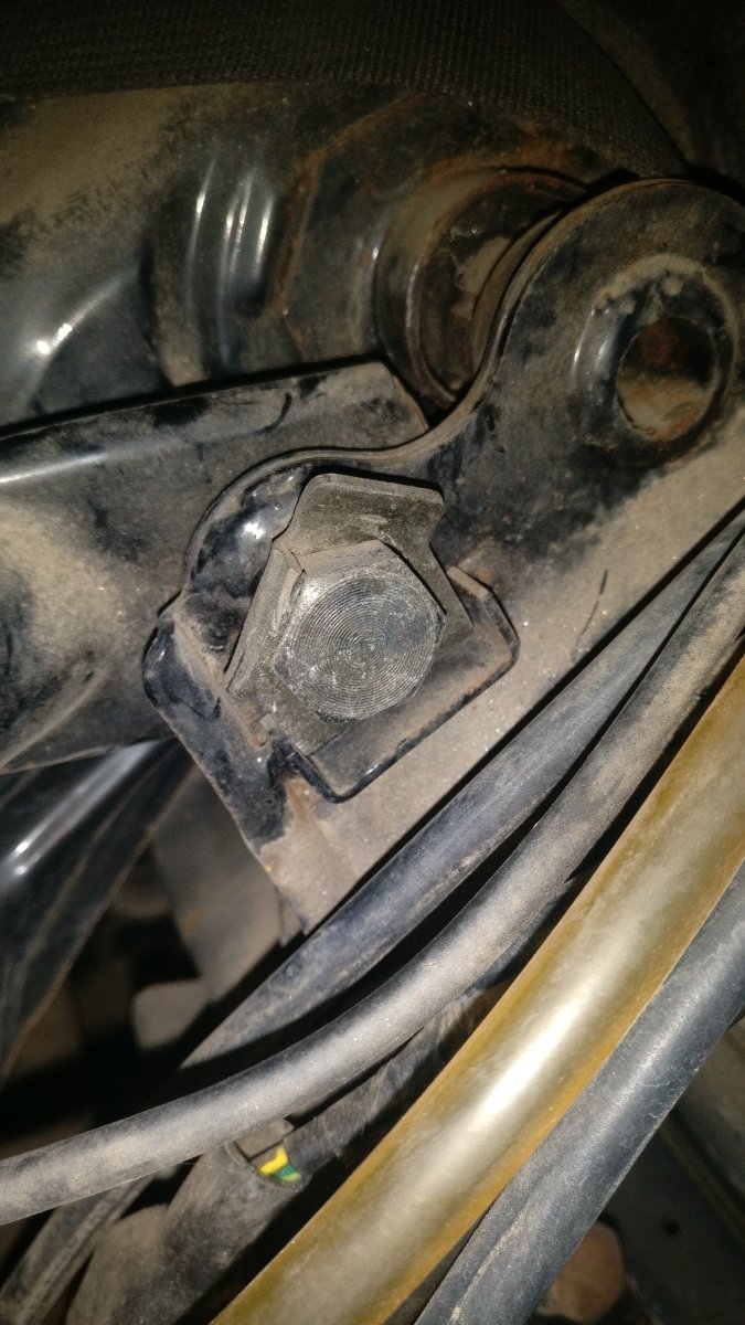

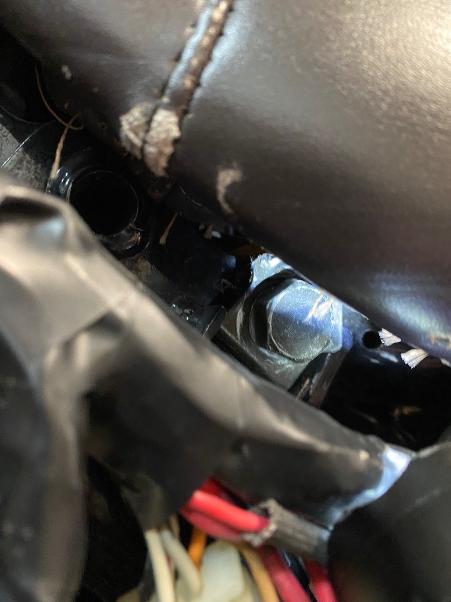

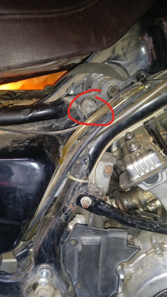

YoungWayne Posted February 21, 2022 #1 Posted February 21, 2022 There's 2 bolts on each side, but I can't seem to figure out how to remove them. They have a metal thing around the head that prevents me from being able to attach anything to remove them. And I don't see how I can remove the metal thing. Please help!!!

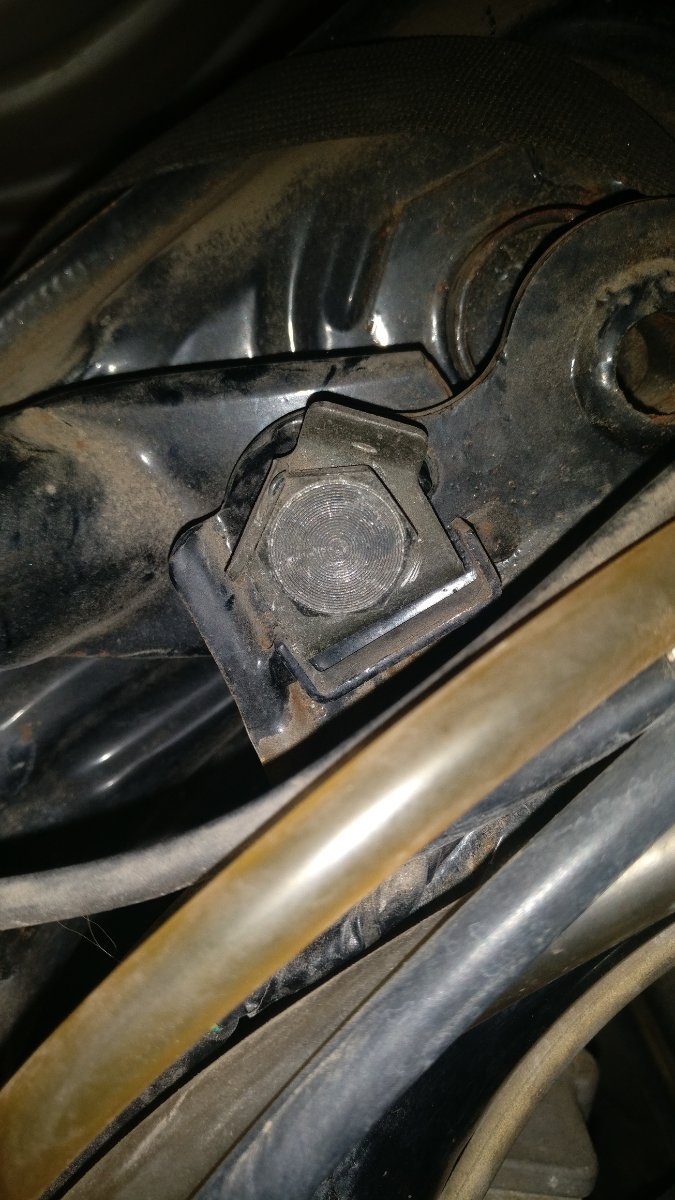

Marcarl Posted February 21, 2022 #2 Posted February 21, 2022 Those are metal tabs that prevent the bolt from turning so that it won't loosen and come out. Take a screw driver and hammer to flatten them out away from the head. 1

Marcarl Posted February 22, 2022 #4 Posted February 22, 2022 Took a deeper look at your picture. If you look again you will see one tab that is in the open position and the other is closed against the bolt head.The closed one needs to be brought back so that you can install a wrench on the head. If you consider both tabs you'll also notice that either one or the other can flat fit against the bolt head, this is so you can use either one depending on the position of the head. These tabs are a part of the washer under the bolt head and will have an anti-turning pin in the hole.
saddlebum Posted February 22, 2022 #5 Posted February 22, 2022 (edited) Marcarl is correct. these are lock tabs which prevent the bolt from backing off after they are tightened. Bend the tab away from the bolt head and flatten it out so you can get a wrench or socket on the bolt head. After you tighten the bolt up again bend which ever tab will go up against the flat of the bolt (It does not need to be the same tab either one is fine). If neither line up with a flat tight the bolt until at least one does. DO NOT back off the bolt to get a tab lined up, always tighten the bolt to the next possible flat. Edited February 22, 2022 by saddlebum
