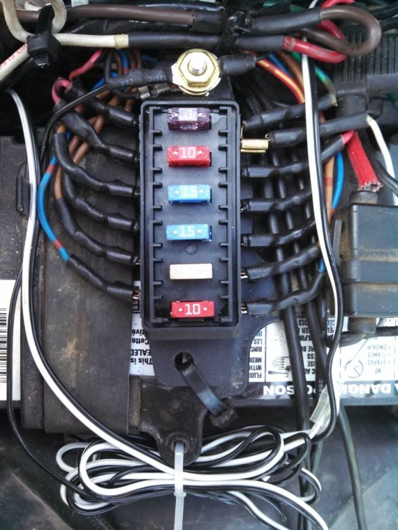

On 11/12/2021 at 9:51 AM, saddlebum said:
If your bike still has the glass fusses I recommend updating to the blade type fuse.IMG_20130726_135057_126.thumb.jpg.ffa2be5042cf79ae805965aab3b980d0.jpg
Where in the world did you find a fuse block that takes mini ATM fuses??
Local jobber. I have seen them at marine stores and at princess Auto (our equivalent of harbor freight) as well.
