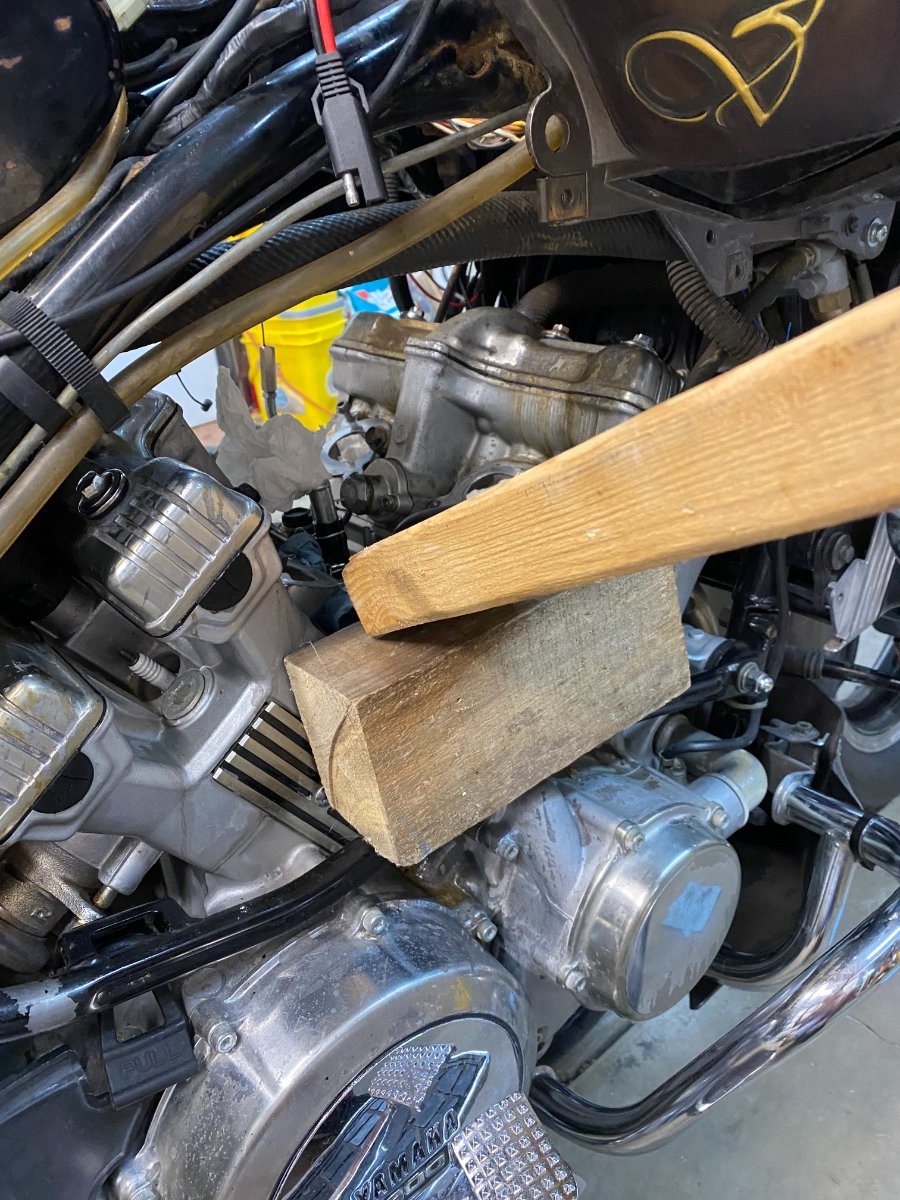

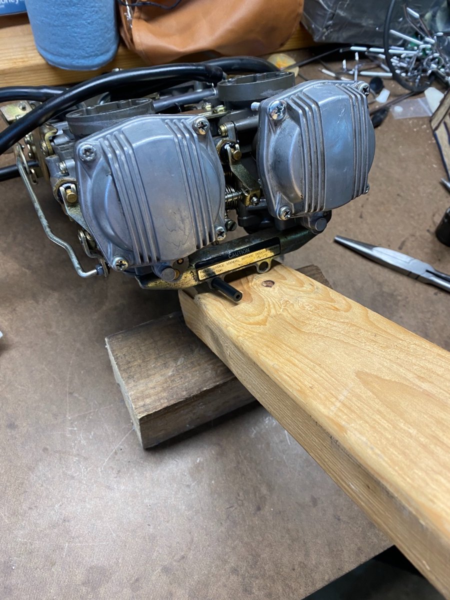

Pasta Burner Posted October 3, 2021 #4 Posted October 3, 2021 Two tips I learned yesterday. 1. Take the choke cable off first, that will enlighten you as to how the cable attaches to the carb. I didn’t know how it was attached so doing it blind inside the carb bank was a bitch. 2. Use the bike and leverage to your advantage. It seemed people had trouble getting the carbs out of the lower boots. I put a block of wood on the frame rail below the carbs and used another piece of board to pop them out. Pics below, obviously carbs already removed. someone please correct me if I’m steering this guy wrong for a Mk1

luvmy40 Posted October 3, 2021 #6 Posted October 3, 2021 I always used a wooden hammer handle to pop the carbs up off the intake boots. 1
