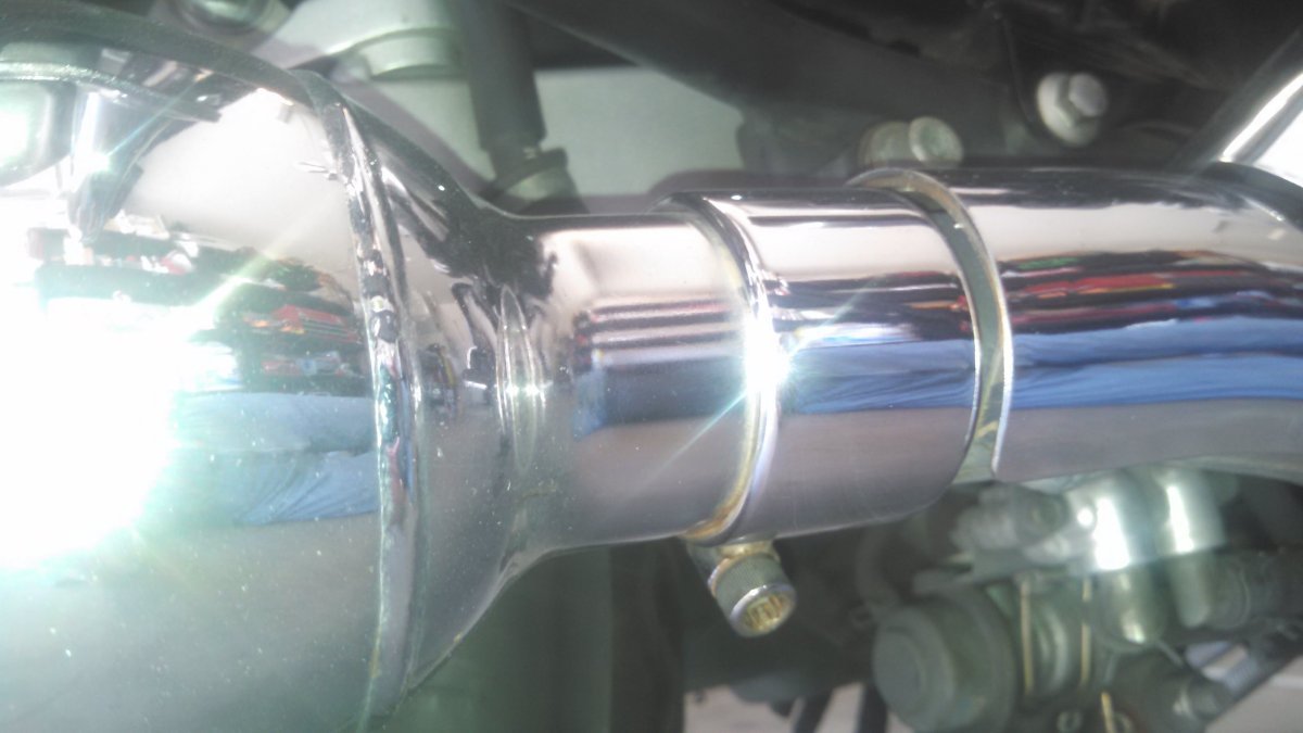

Dutch Navigator Posted September 20, 2021 #1  Posted September 20, 2021 (edited) Does anybody know if these mufflers will fit? They have a 45mm en 65mm mounting end. Partnrs. OEM 64900240 en 64900239. Peter Edited September 20, 2021 by Dutch Navigator Typo
Squidley Posted September 20, 2021 #2  Posted September 20, 2021 They should fit, I don't believe HD changed much on their big bike mufflers in the last 15 years. I have a set of slash cuts from a 2005 Road King on my RSV. You'll have to get a special clamp that will adapt from the metric pipes to a HD muffler. I know their is some posts about it on the site, You'll just have to do some searching. 1
Dutch Navigator Posted September 21, 2021 Author #3  Posted September 21, 2021 Thanks! I read some info about the clamps. 1
videoarizona Posted September 21, 2021 #4  Posted September 21, 2021 Yep. Have a pair on my RSV..  Yes, the do sound good. And yes, you will need to get the clamps. 2
djh3 Posted September 23, 2021 #5  Posted September 23, 2021 I went cheap and used hose clamps. Aint pretty but worked. Only thing on the HD pipes was there was a couple years there they had a Cat in one side. Somewhere around 2009 ish I think. 1

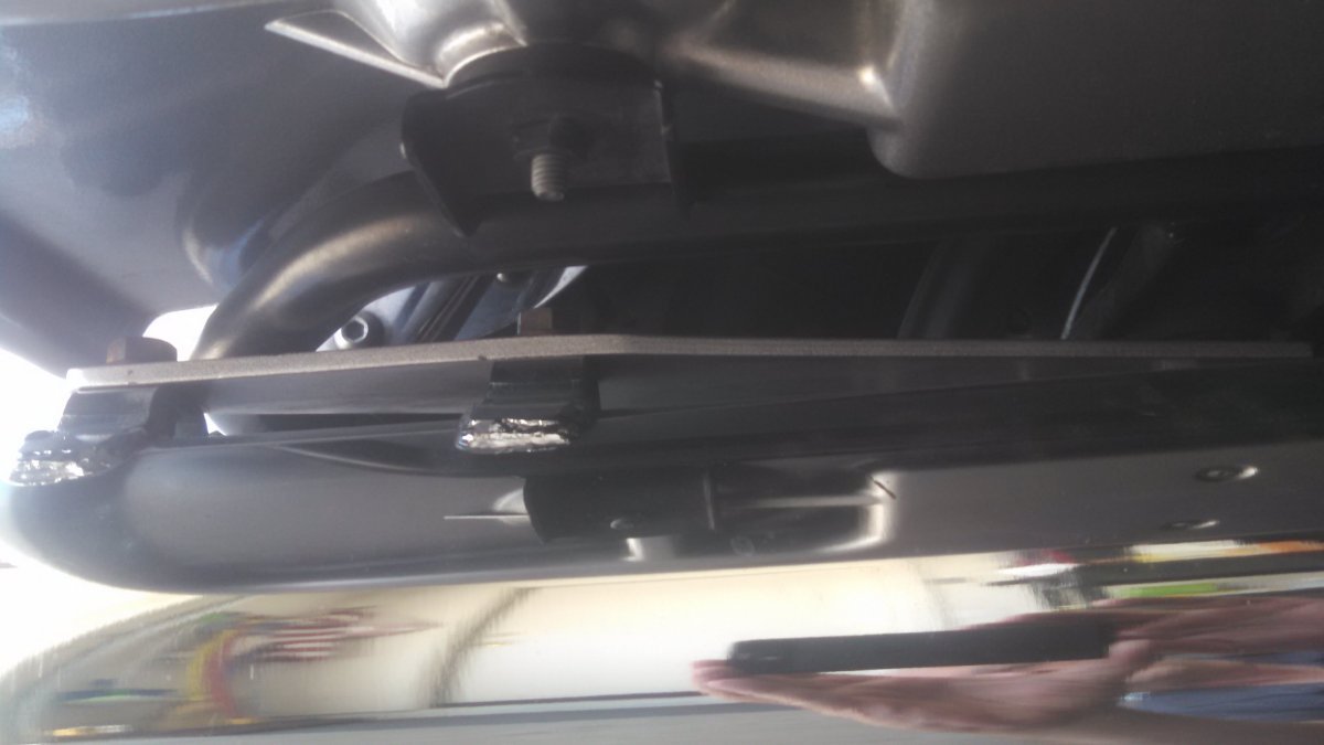

BratmanXj Posted September 24, 2021 #7  Posted September 24, 2021 Also there should be drawings on the internet for the fabricated metal brackets to fit HD mounts to the Venture mounts. Some guys have used P-clamps around the saddlebag brackets with good luck too. 1
videoarizona Posted September 24, 2021 #8 Â Posted September 24, 2021 Someone on this site made brackets. There also was a diagram with info on building your own. I thought I just saw a post recently???? Memory...first thing to go as we age....LOL! 1
djh3 Posted September 24, 2021 #9 Â Posted September 24, 2021 I just use 3/4" P clamps from home depot and a couple 1/4"x20 bolts in the HD factory bracket. Making those hockey stick bracket was going to be a day project. Once I checked into it the P clamps were easy and cheap. 2
Dutch Navigator Posted September 26, 2021 Author #10 Â Posted September 26, 2021 I found the drawings of the brackets, thanks guys! Â Â Â 2
BratmanXj Posted September 29, 2021 #11 Â Posted September 29, 2021 On 9/24/2021 at 6:46 PM, djh3 said: I just use 3/4" P clamps from home depot and a couple 1/4"x20 bolts in the HD factory bracket. Making those hockey stick bracket was going to be a day project. Once I checked into it the P clamps were easy and cheap. Brother-in-law works in a machine shop and I'm an engineer with AutoCAD.... gave him a scale drawings and had brackets the next day. 2
