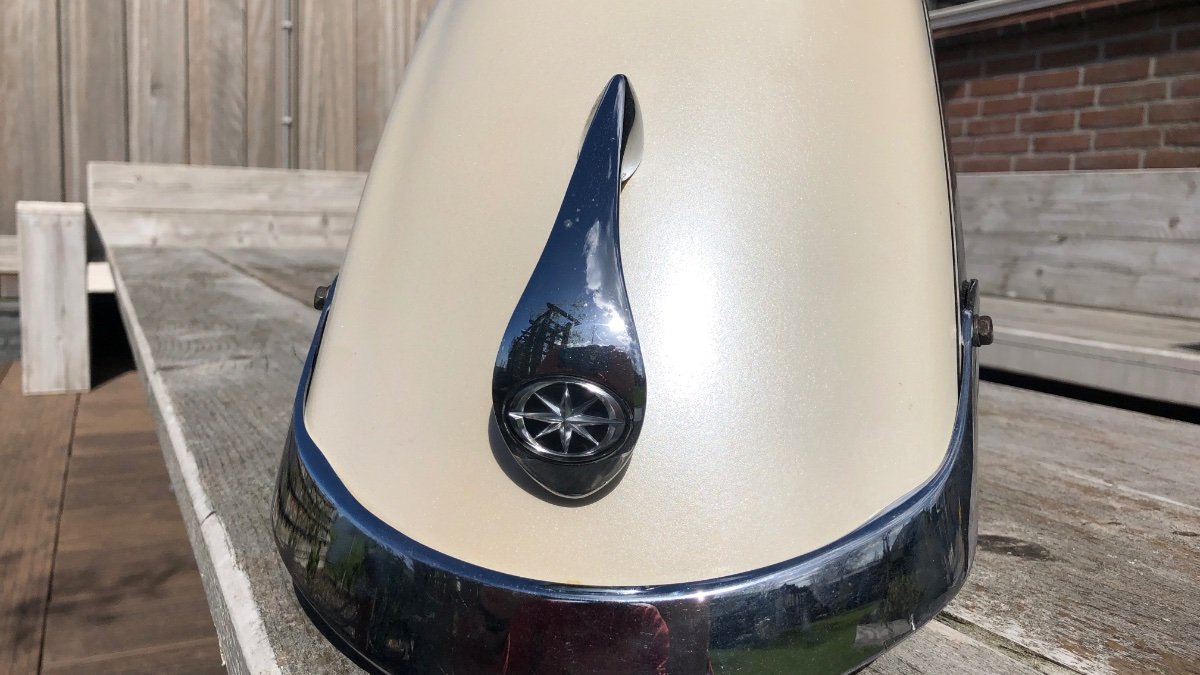

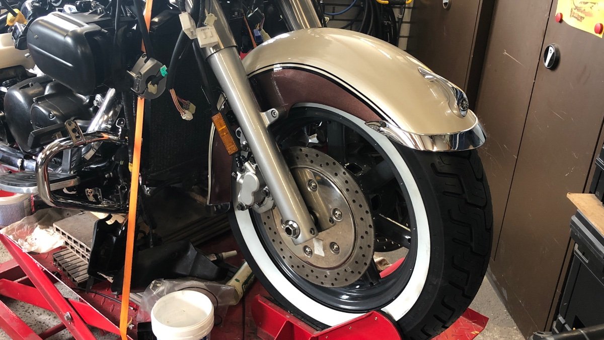

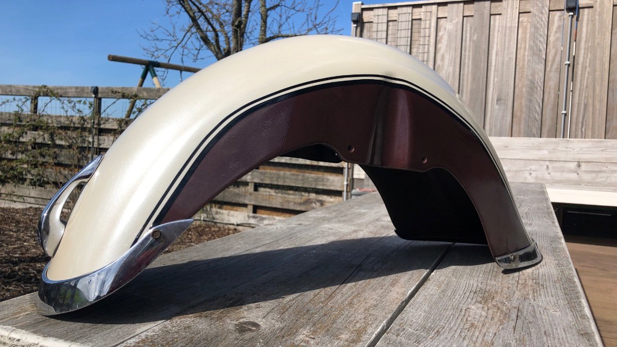

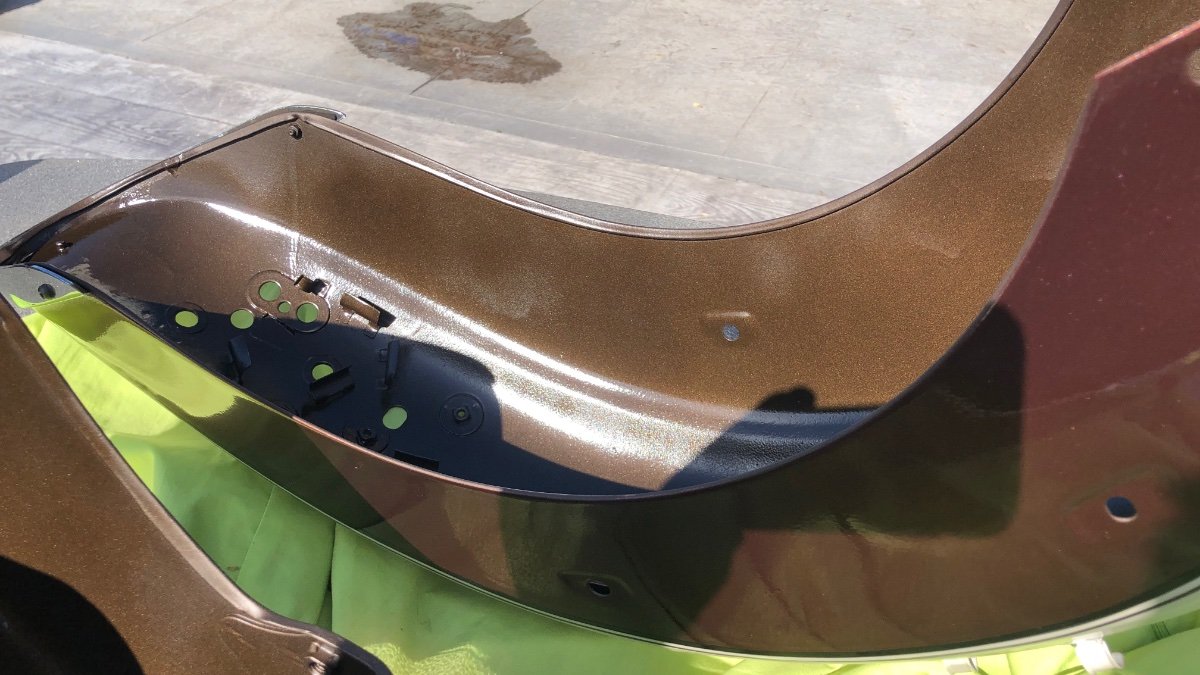

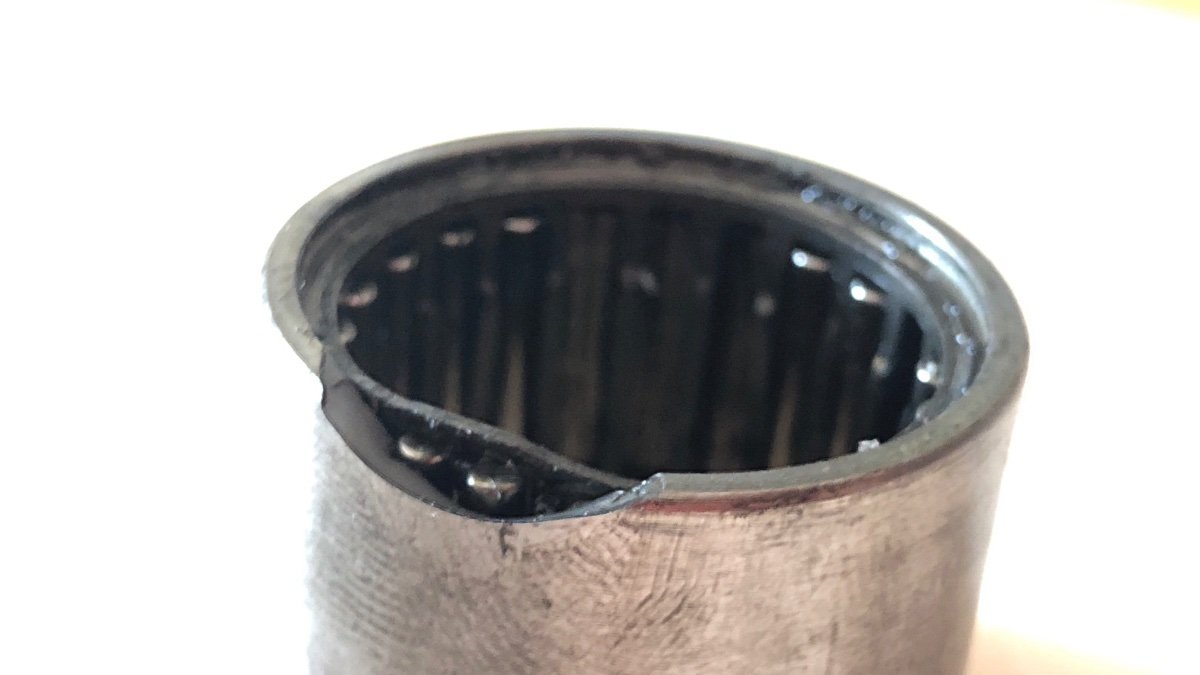

Dutch Navigator Posted April 10, 2022 Author #84 Posted April 10, 2022 (edited) We closed the COVID-chapter last week, so let's continue! First we sprayed a layer of rust protection on the inside of the fenders: Second, we added some chrome parts to the fenders: Awesome! Some bearings from the back wheel are damaged. Probably by ourselves when dismounting these parts. We ordered a couple of new ones: Edited April 10, 2022 by Dutch Navigator typo

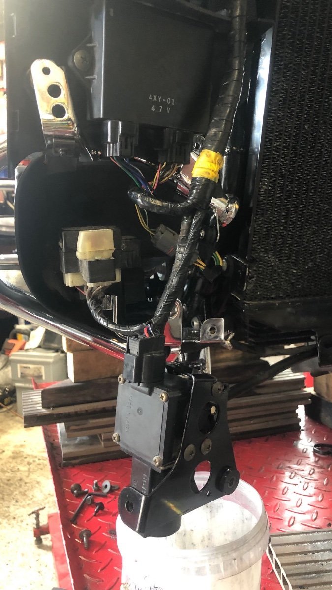

Dutch Navigator Posted June 2, 2022 Author #98 Posted June 2, 2022 I'm lost, well sort of. Need help to mount the vacuum pump on the right side of the bike. Any help appreciated! vacFetching info...
Marcarl Posted June 2, 2022 #99 Posted June 2, 2022 I'm not much help in that regard I'm afraid, not that versed in 2nd gen build. Hopefully somebody will jump in here. 1
Dutch Navigator Posted June 2, 2022 Author #100 Posted June 2, 2022 Thanks. Even the Clymer manual isn't very clear about this.
