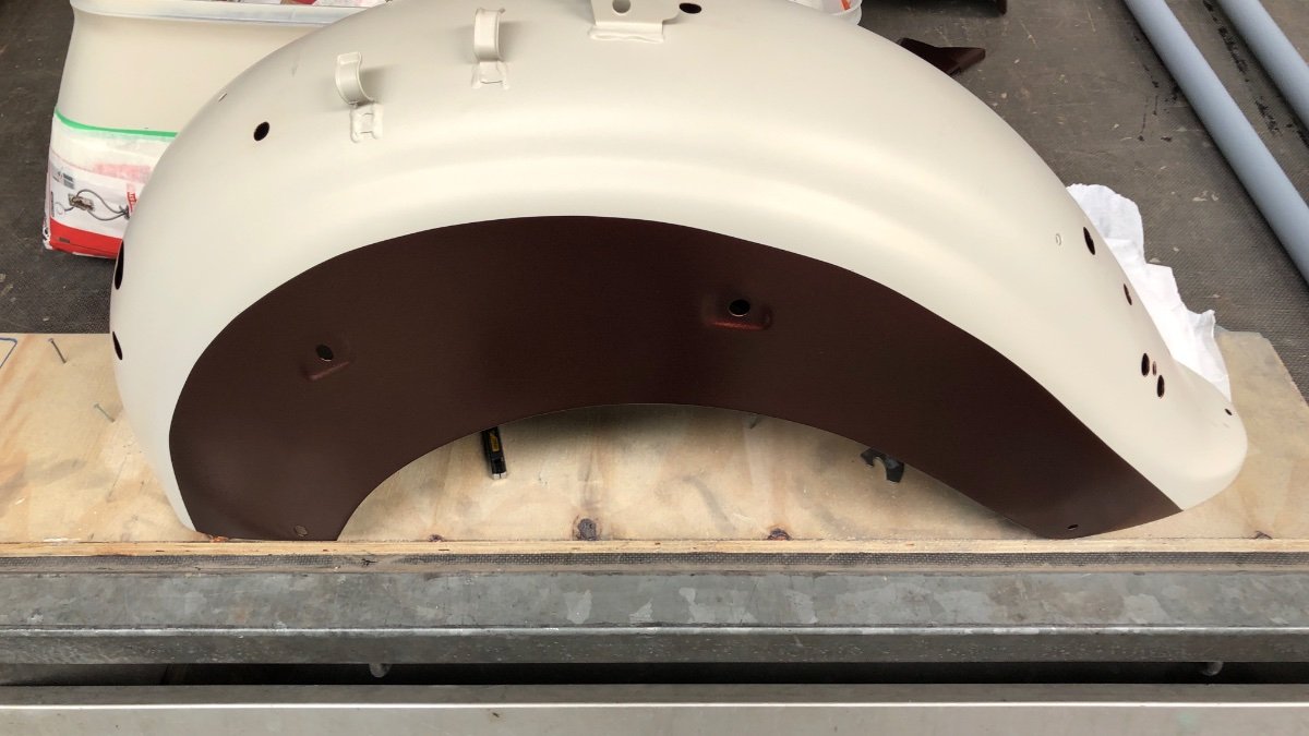

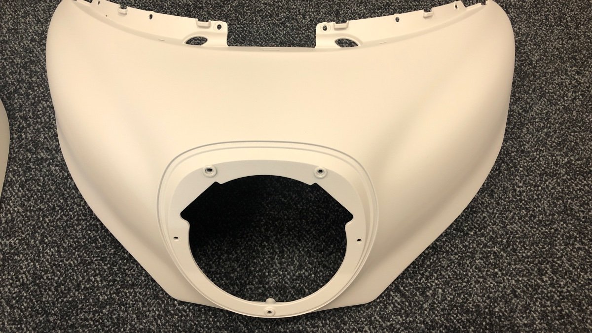

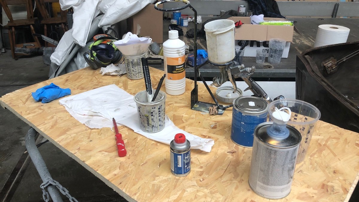

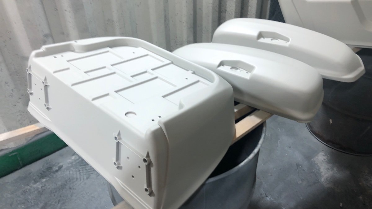

Dutch Navigator Posted January 29, 2022 Author Posted January 29, 2022 Today (Saturday) a day in the paint booth. All Tupperware got 2 layers of filler: 1

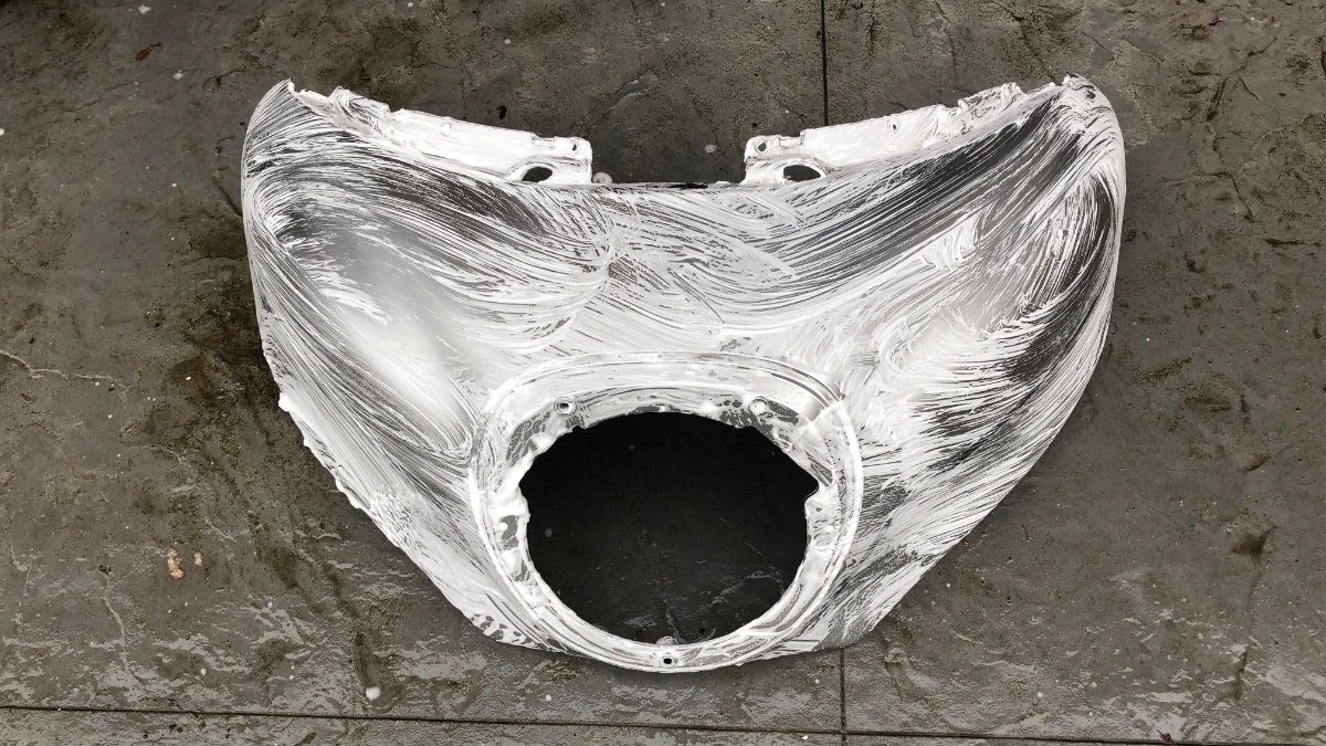

Marcarl Posted January 29, 2022 Posted January 29, 2022 I really like the look of the first picture, those swirly marks are an awesome design. Oh well, guess it's not my scooter. Next pictures look more traditional, nice work. 1
Dutch Navigator Posted January 29, 2022 Author Posted January 29, 2022 It's a great effect in the first picture. You just need sandpaper (600) and some water....... Sometimes we're all artists. Thanks for your reply.

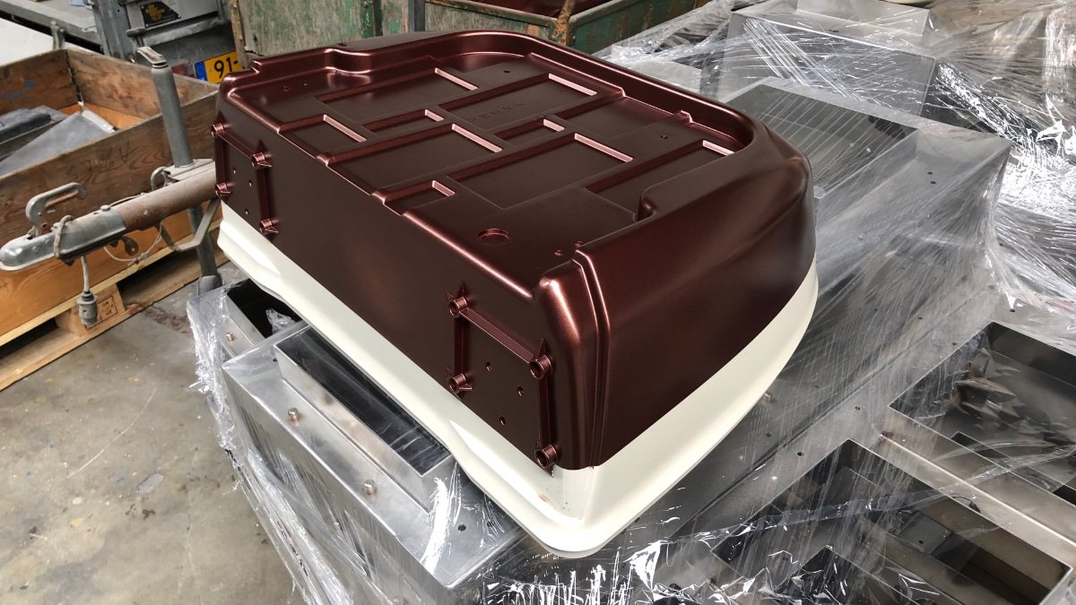

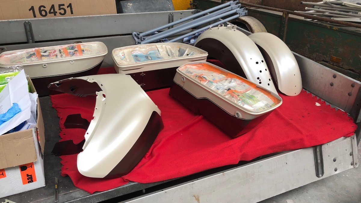

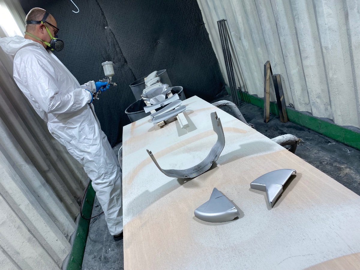

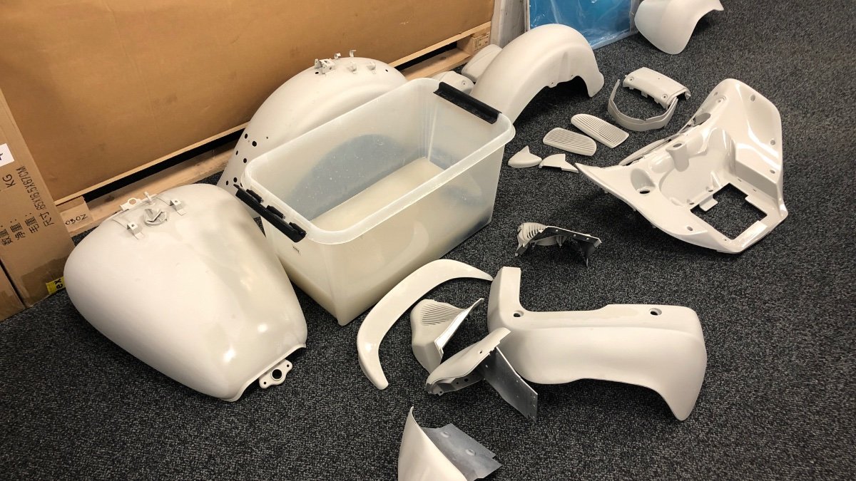

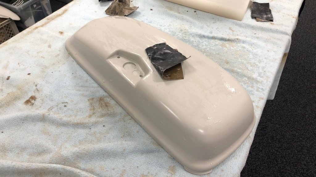

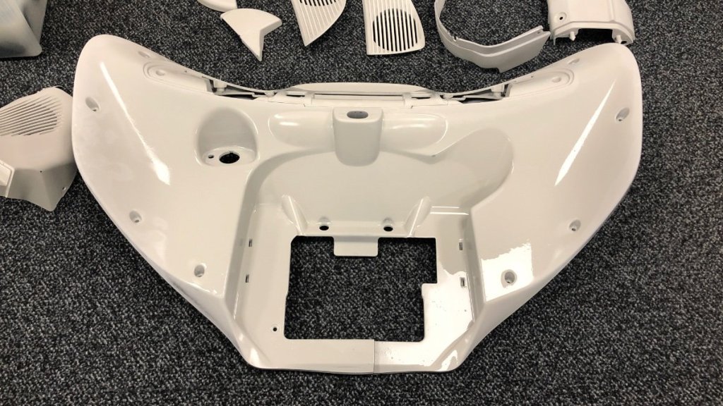

Dutch Navigator Posted February 5, 2022 Author Posted February 5, 2022 Today a 'wet' day. After spraying the grey filler on the metal parts also, we sanded everything with 400/600 sandpaper. The parts are like new. Next week we're in de paint booth again spraying the base-coat on all the parts. The shiny parts are still wet from sanding. 2
Marcarl Posted February 5, 2022 Posted February 5, 2022 Might I suggest a quick wet sanding with 2000 paper before final coat? Seems to give a deeper shine I think. 1
Dutch Navigator Posted February 5, 2022 Author Posted February 5, 2022 To be honest, I think 2000 is too fine. You can use 2000 to sand the definitive paint and then polish it.

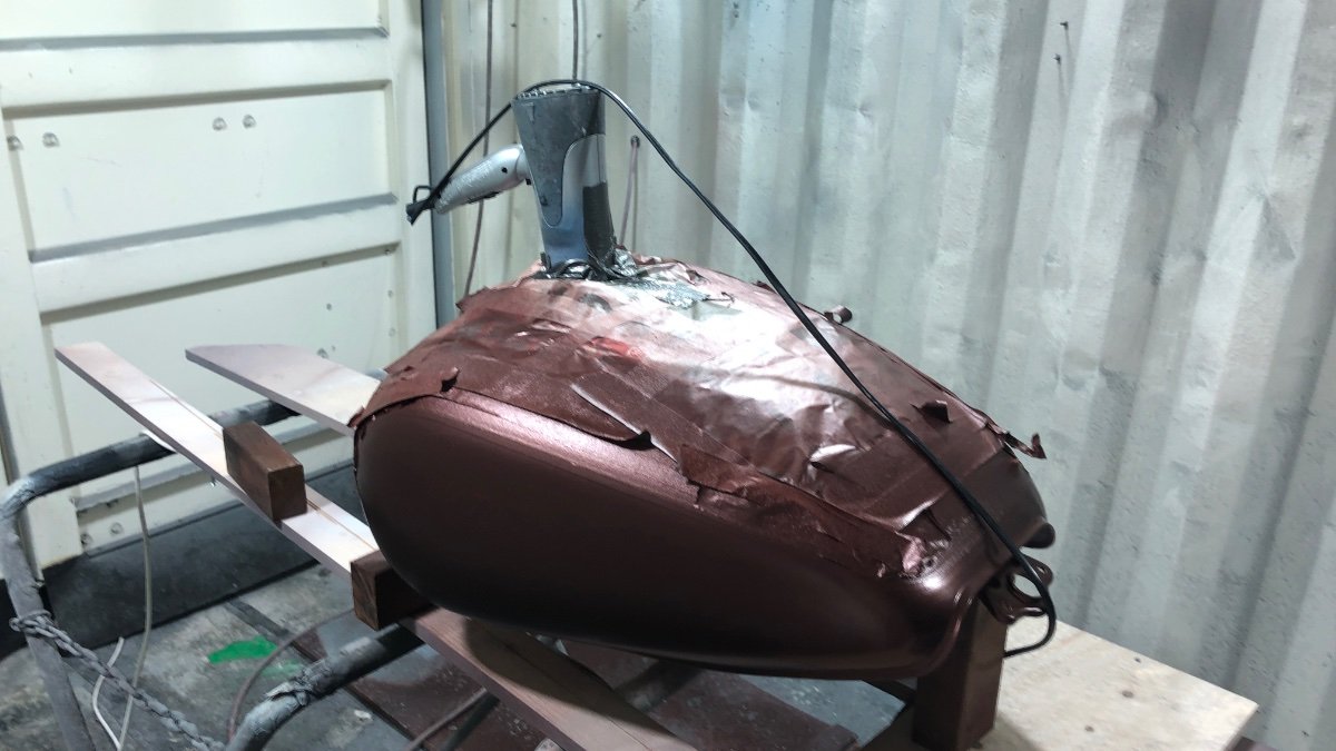

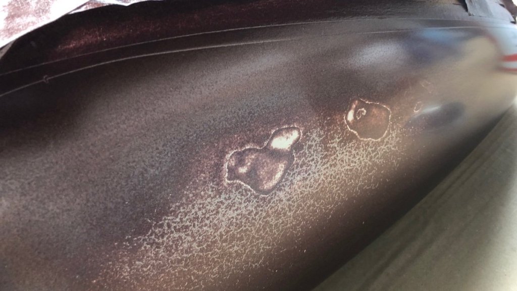

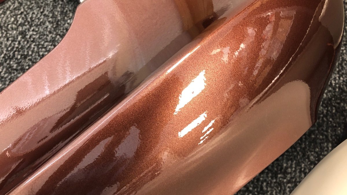

Dutch Navigator Posted March 6, 2022 Author Posted March 6, 2022 (edited) Well, let's be honest. Not everything is going smoothly........... Today in the paint booth we encountered some bad 'crackle' problems with the paint on a fender. Sanding, two thin coats of primer, three thin coats of paint (and 3,5 hours) later the fender was ready for the clear coat. Overall, it was a long and productive day with great results. Clear coat finishes it all! Edited March 6, 2022 by Dutch Navigator 2

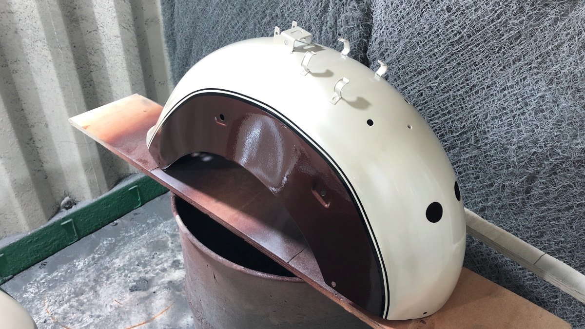

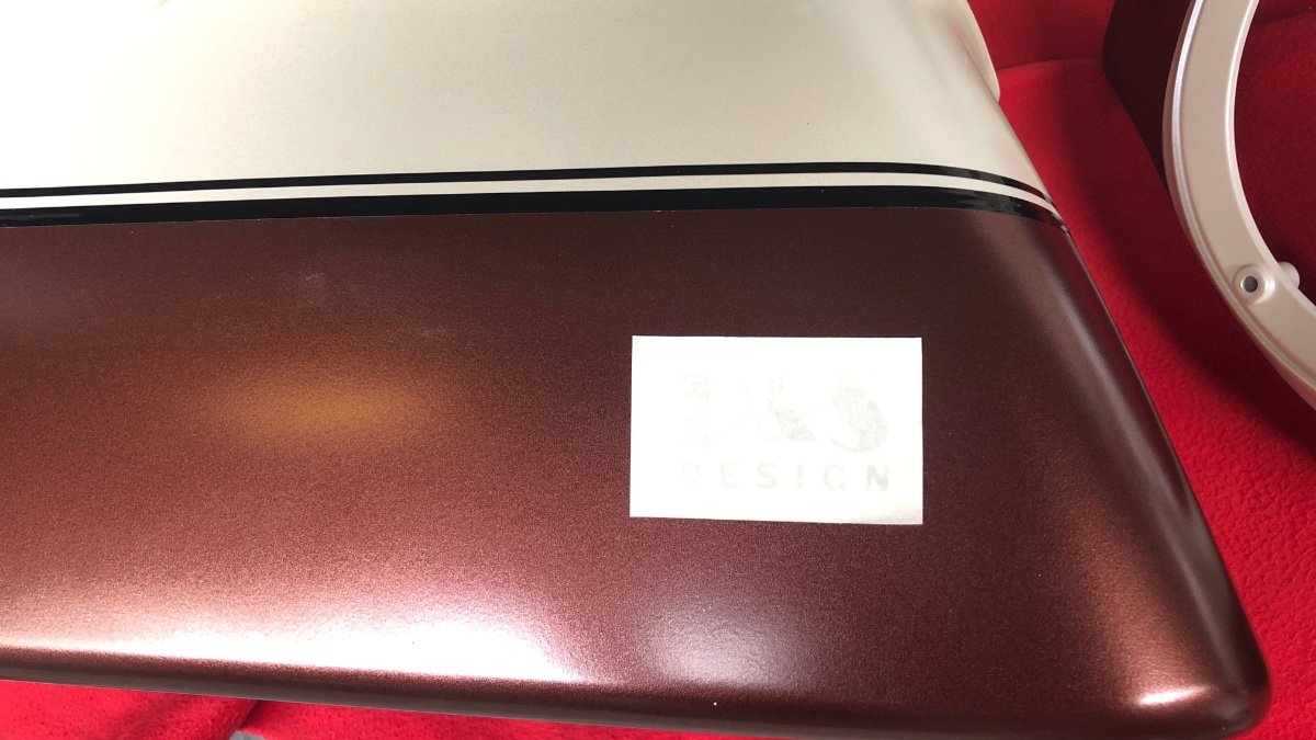

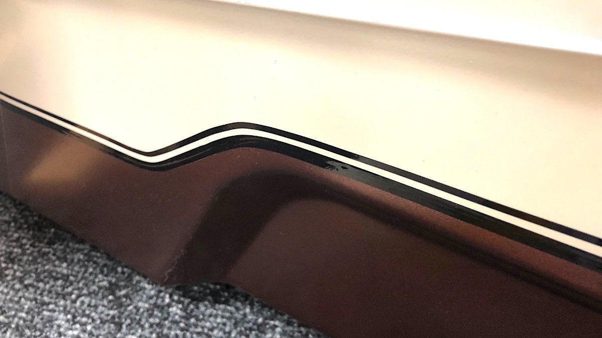

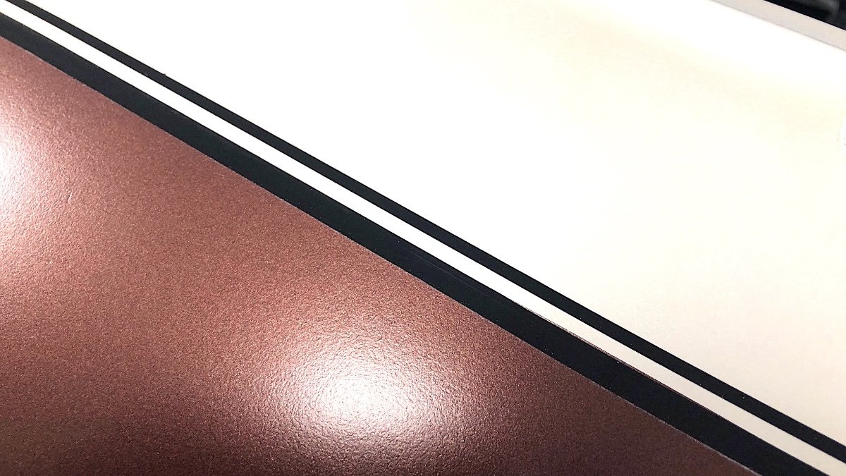

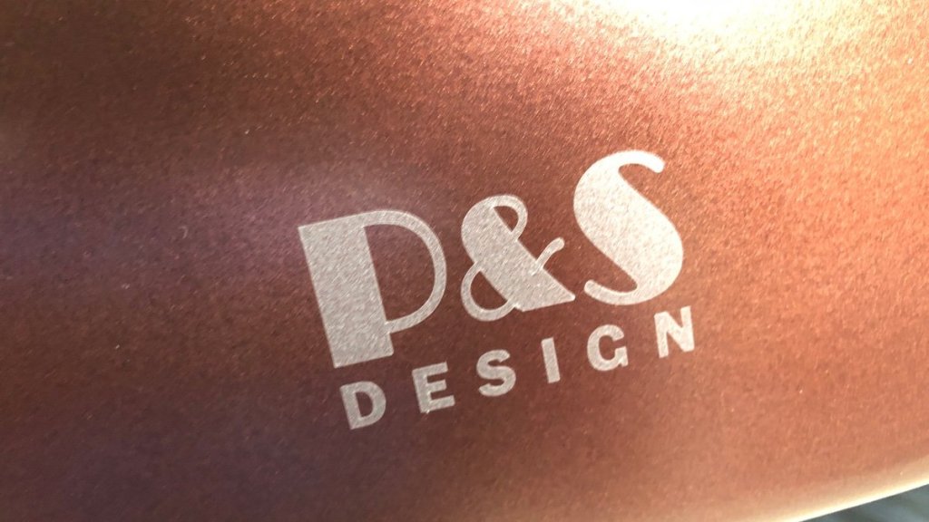

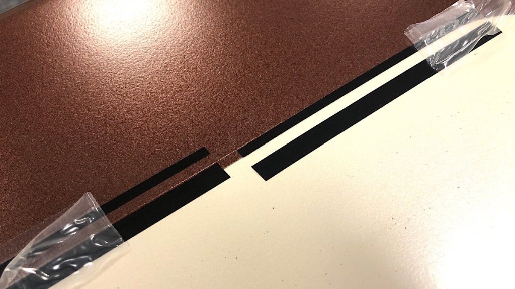

Dutch Navigator Posted March 11, 2022 Author Posted March 11, 2022 (edited) Yesterday we worked on the finishing touches about the spray paint. This time we tested some 'racing stripes' or 'striping' (hope this is the correct English). Today and tomorrow we will finish all the Tupperware with 2 layers of clear coat. Edited March 11, 2022 by Dutch Navigator
Marcarl Posted March 11, 2022 Posted March 11, 2022 5 hours ago, Dutch Navigator said: Yesterday we worked on the finishing touches about the spray paint. This time we tested some 'racing stripes' or 'striping' (hope this is the correct English). Today and tomorrow we will finish all the Tupperware with 2 layers of clear coat. Striping is the word, stripping is not something that is suggested you do. So far it looks good enough for me to ride. Carry on! 1
