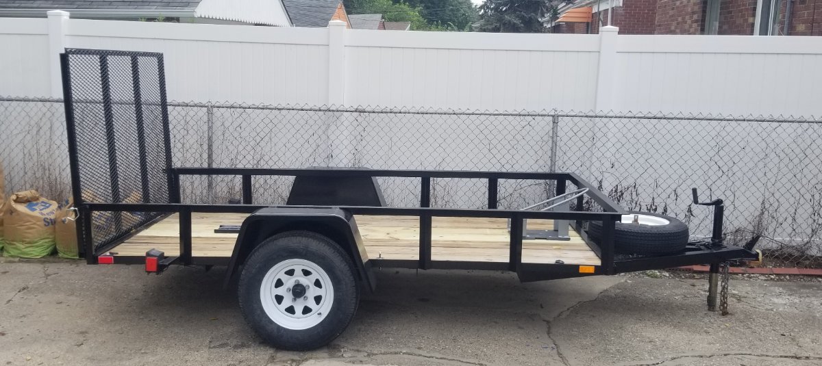

Candyman867 Posted August 18, 2021 Posted August 18, 2021 Hey everyone! I have an amazing 2000 Royal Star Venture, love the bike. Going on a trip "tail of the dragon" about 10 hour drive to get there! I have never tried this bike in a trailer, PLEASE HELP!! I have a good solid trailer with the wheel chock, need to know where to put my straps, do I let air out of the suspension... etc! Any help would be appreciated. Pictures of bike, trailer and tow vehicle included
luvmy40 Posted August 18, 2021 Posted August 18, 2021 (edited) This is the ONLY way to tied your bike down! (Notice that, purely coincidentally it's an RSTD in the video!) You don't have to use the "Tank Straps". They are fantastic, but any quality heavy duty ratchet strap will work. It's the method/tie down point that is key. This method does not compress your supension and allows the bike to float as it would when ridden. No need to adjust your air ride pressure or any other adjustments. I have used this method many times with great success. DO NOT TARP YOUR TRAILERED RSV! It will destroy your paint. Edited August 18, 2021 by luvmy40 typo
Candyman867 Posted August 18, 2021 Author Posted August 18, 2021 Fantastic, thank you! Will for sure use this method!
Motorcycle Mike Posted August 18, 2021 Posted August 18, 2021 I agree with the straps in front. On the rear however, I put 2 straps around the rear wheel, one pulling left and one pulling right and both pulling slightly to the rear.
luvmy40 Posted August 18, 2021 Posted August 18, 2021 (edited) 17 minutes ago, Motorcycle Mike said: I agree with the straps in front. On the rear however, I put 2 straps around the rear wheel, one pulling left and one pulling right and both pulling slightly to the rear. As long as the straps are on the wheel and not compressing the rear suspension. I've done that as well if there might be rough roads on the trip. Edited August 18, 2021 by luvmy40

saddlebum Posted August 18, 2021 Posted August 18, 2021 4 hours ago, Motorcycle Mike said: I agree with the straps in front. On the rear however, I put 2 straps around the rear wheel, one pulling left and one pulling right and both pulling slightly to the rear. I agree, The way the chap did it in the video left me thinking the wheel could still slide side to side within the confines of the strap.
luvmy40 Posted August 18, 2021 Posted August 18, 2021 I hauled my '06 down to Youngstown, OH from Niagara Falls with no strap on the rear and did not move an inch. Like I said, rough roads possible? Tie the rear wheel down.
Motorcycle Mike Posted August 19, 2021 Posted August 19, 2021 I always assume I'm going to hit a rough patch somewhere. I'd rather spend a few extra seconds preparing for it rather than wishing I had. Your bike, Your choice. 1
