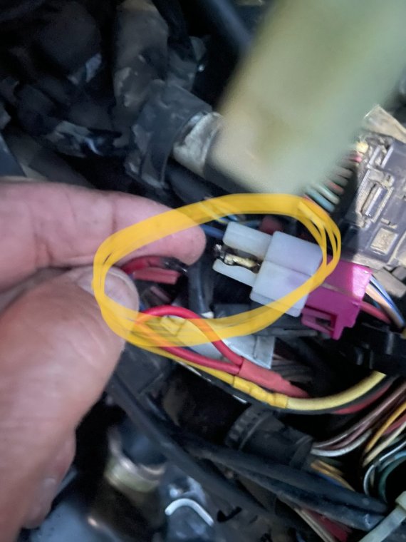

To start with, thanks for @djh3 for the ignition relay I bought back in 2014. It definitely saved my ignition switch but gave its life in the process.
I was in Yellowstone this week in a thunderstorm downpour, pulled over to the shoulder on a narrow road  section and my 2006 RSV just shut off like the key was turned off. Literally getting buckets poured on me and in an unsafe place. I, of course, channeled my inner @cowpuc for guidance.  My buddy waved traffic about two feet away from my butt as I checked the Ignition fuse and battery connections. After that I just knew that something was amiss with the wiring to the ignition switch. I was in a very unsafe place to be pulling the tank off and totally getting drenched at the same time. Had to call for a tow out of the part to West Yellowstone - $520 - and using my Somewear satellite hotspot ( no cell service of course) I was able to ask my daughter to find me the ONLY motel room left in the whole town. As soon as I was unloaded off the tow trailer as the motel I pushed the bike under a bit of covering and took the tank off. We don't always get so lucky to see such an obvious solution yelling out - ITS ME ITS ME ! but that is what I saw see photo.
That red wire burned up and came off the connector. Had the ignition power been running though the ignition switch directly - as stock- this would not have had such a happy ending and quick repair. I stopped to have dinner since I could relax. After dinner I had to cut off and cut out the DJH3 ignition relay wiring, Plugged the now open blade females ( had to cut them out of the ink connector ) back into the stock connector and I was ALIVE again. So thank you to the ignition relay and thank you to djh3!
Now I need to contact djh3 to buy another ignition relay and an extra male connector.
I suggest that everyone with the relay check the relay wires every IMG_1423.thumb.jpg.9016c94075950ff5dee09434c8835290.jpgtime you have the tank off.
