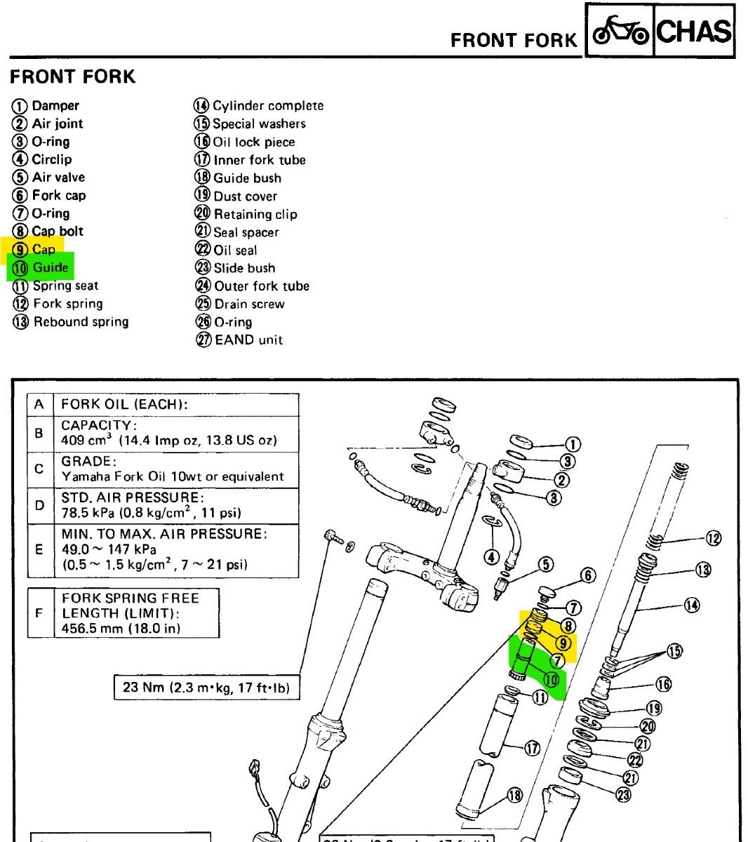

I'm quite interested in this topic.  I have been confused about what spacers, parts, and how much oil to use after reading through a ridiculous number of posts/threads. Some of it seems to spring (pardon the pun) from inconsistent naming of parts. Earlier this year (while completing my service & restoration) I opened up the forks to replace the fork oil.  To my delight, I found that the previous owner had installed Progressive springs up front.  I believe I found my forks to be set up like the top spring in this picture - using only the threaded fork cap, the spacer with the fat o-ring, and the spring.  There may have been a washer in there too, I can't remember.  I believe I tried making and adding some PVC spacers, but there was no way I could get the fork caps down and get the threads started, so I left them out (I'm healthy and able-bodied enough to do such a job, so that wasn't the problem).  While I'm sure the fork oil replacement was helpful, I find the front end to "wallow" when pushing the bike through the twisties.  I can touch down pegs, but it doesn't feel all that planted up front when leaned over at speed.  That was certainly disappointing, but then I don't really know what to expect from such a big bike.  This sounds like what Pasta Burner is experiencing as well.  I don't notice the bike diving excessively, which is good, but better cornering would be very much welcomed.

I'd like some clarification on some things.  Those that are using the PVC spacers - are you using these IN ADDITION TO the factory spacer that has the fat o-ring (the one that is 1-2 inches thick), OR INSTEAD of that factory spacer?  Sorry I don't know what else to call that part.  The factory setup (as shown above) has what are, to my eyes, 2 spacers - a short one with the fat o-ring and the long thin metal tube.  I know not to use the thin metal tube spacer.
Second question, what is the actual length of the PVC spacers provided by Progressive? I don't have them, so references to 1/2 or 3/4 of the spacer length do not have any meaning to me without the original length measurement as reference.  Thanks.

The metal OEM pipe will be history. An 1.5" pvc spacer is a good measure to start from. There should be a good amount of umph needed to get the screw cap to get threaded, if it goes on easy, make one a 1/2" longer.
I checked my notes from my 2005 installation of Progressive springs.  The PVC spacer was 1 1/4" tall.  I didn't use it.  Instead, I installed the OEM metal spacer with the o-ring that Prairiehammer referred to as the "cap" in the above photo.  It is approximately 1" tall.  I'm 175 pounds.
That shorter OEM round metal piece is indeed called the "cap" and the original longer spacer is called the "guide".
