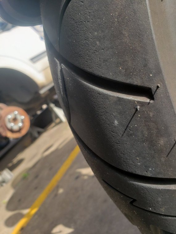

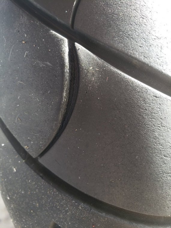

Squidley Posted July 25, 2021 Posted July 25, 2021 (edited) Hey Folks, I wanted to come on here and tell you about something I discovered this morning on my RSV. I have been a big proponent of the Shinko tires, I've ran a few sets on various bikes. I looked at my front tire this morning after I got to work and saw it cupping badly, at closer inspection, as seen in the 1st picture, the tire is separating. This tire has somewhere between 7 and 9K miles on it and has a lot of tread depth left. I'm obviously going to replace this tire, and also not purchase anymore Shinkos. It's unfortunate as I've had pretty good luck with running them, but I will not promote this brand any longer. Some of you will remember when the Metzler 880's were doing this, this reminds me exactly of that. Just wanted to give y'all a heads up so you can make better informed decisions when ordering tires for your bikes. Edited July 25, 2021 by Squidley
saddlebum Posted July 25, 2021 Posted July 25, 2021 (edited) Not that I disagree with your decision Mr @Squidley. but keep in mind any brand of tire is capable of having a bad one in the batch. My wife's car started shaking real bad and would bunny hop at slow speeds. turned out all four tires had broken and shifted belts resulting in bulges in the tires. These were Michelin tires a brand many us pretty much consider top of the line tires. So one bad apple should not condemn the whole basket, where as the Metzler 880's, had a whole rash of tire separation failures and Avon not so long ago had a rash of side wall cracking, related to a certain batch and yet both before and after they have been one of the highly recommended tires except for 1st gens were they tended to cause a rear end sway at highway speeds. I would get the batch number off the tire and contact Shinko and see what kind of feed back you get. They may have had a bad batch and if so may be willing to provide a new tire. there may even be a recall on that batch. None of this is to say I disagree with your decision just some food for thought. At the end of the day you gotta do what makes you feel safe. Edited July 25, 2021 by saddlebum 6

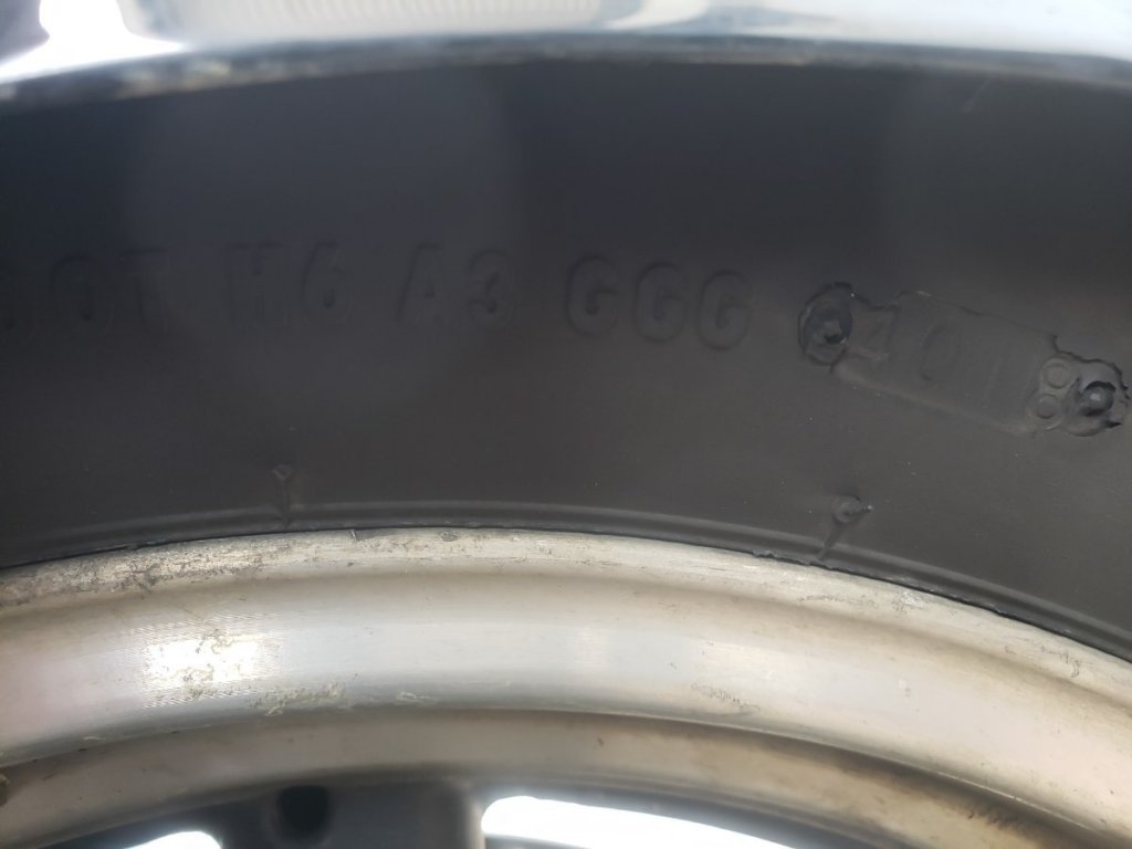

Squidley Posted July 25, 2021 Author Posted July 25, 2021 (edited) The tire was manufactured in the 40th week of 2018, so basically the 1st week of October. Edited July 25, 2021 by Squidley

circa1968 Posted July 26, 2021 Posted July 26, 2021 I see some consistent microcracks in the recessed channel area around the side blocks. The main channels that go diagonally across the tire do not have these tiny cracks. Not sure what to make of it, but will keep an eye on it for sure. The tire has 5k miles on it and date code is 2420.
saddlebum Posted July 26, 2021 Posted July 26, 2021 (edited) It is not uncommon to see some slight hair line checking in the grooves known as weathering of most tires but I would definitely keep a close watch just the same Edited July 26, 2021 by saddlebum 2

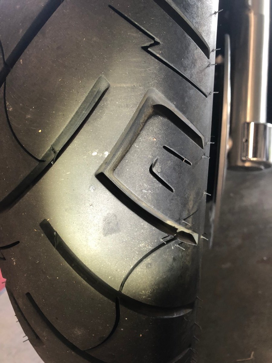

Squidley Posted July 26, 2021 Author Posted July 26, 2021 14 hours ago, djh3 said: So the tire is a little more than 2.5 years old. Has it been used all winter or set for months? I live outside of Houston Texas and I ride all year long. 12 hours ago, Pasta Burner said: @Squidley did you notice some ride difference that made you look at the tire when you got to work? Just wondering what prompted you to look at it at that point. I have been noticing the cupping and could feel it buzzing in the handlebars. It just happened that the bad spot was right in plain view at the perfect angle for it to really catch my eye yesterday morning after I got off the bike. Now I'm going to fill y'all in on something here, I run darkside as I have a 15" Nexen car tire on the back of my RSV. I've been running it for about 2 years. Now I know some of you are shaking your heads as you would never think of doing it, and that's cool, I just wanted to run one for myself for an extended period as a lot of my riding these days is 1 up and on the freeway. I'm fairly confident that running the car tire on the back should not have made any difference on this tire. I still get into the twisties, and even though my chicken strips aren't to the complete edge of the tire, I still ride it how I want to. The only thing I wonder about is the Shinko on the front is a bias tire and the back is a radial, I've heard about not mixing the 2, but not sure what the "side effects" are with running it this way.
