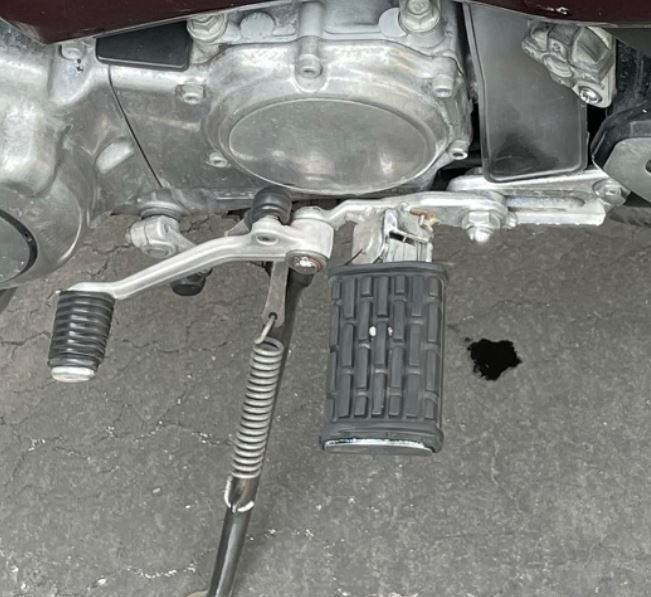

Not losing any brake / clutch fluid, seems like oil. Kinda hard to see above exhaust, hoping others have had similar drip and suggestions.  I know I need to start off with a good cleaning.  ps: it's a 83.

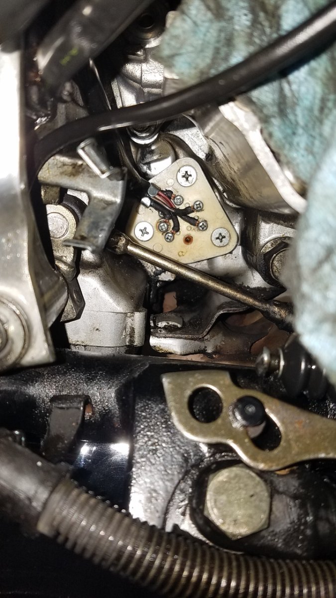

In that area, there isn't much. Forward of that is a lot of areas....but your scoot looks to clean for those. My guess is pry off the rubber drive boot cover and see if there is oil there.
  • Thanks 1
The only other area that would drop oil down in that area would be the rear cylinder valve cover leaking. But then you should be able to see an oil line running down the back of the cylinder.
To the left of the final drive is the neutral/gear switch. It has an orange O ring that can leak. To the left of that is the stator wires. Below the final drive is the tiny crush washer in the drive cover... On the bottom. It can leak if not replaced. But both of those are forward of where your leak appears. I'm assuming the leak was straight down.
To the right of the final drive is the output shaft. The rear shock is up in there as well but our shocks on the 1st Gens are not known to leak, if memory serves.
That's about as far as I can go, Ronnie.
Let us know what you find....
David

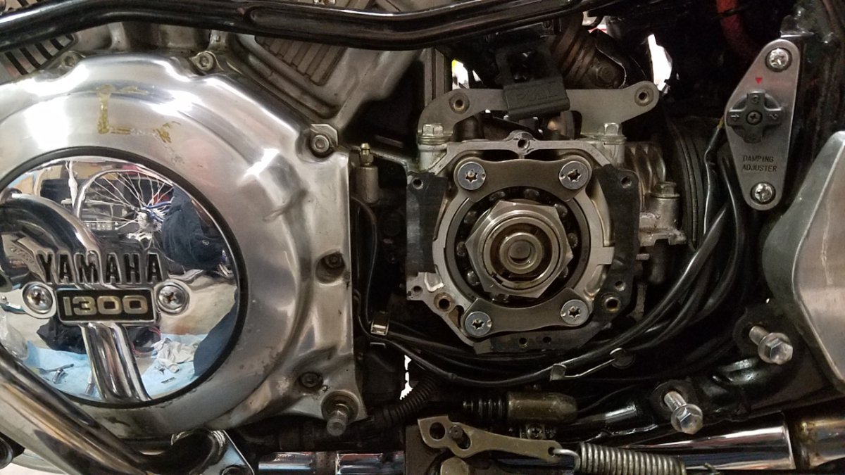

Thanks alot David, After another ride, and sitting a bit more level, it is forward a bit from my above picture.  My rear valve covers seem dry, It's been dripping a large drop after every ride for a few months now.  Oil level not noticeably down.  I really need to get some engine cleaner, purple stuff, and get the area clean.  It's really tough to see, even with mirrors, because the exhaust collector is in the way. Not to appear super stupid, but the cover you have off, isn't that the crankcase cover? Maybe I should start by ordering the gasket for that, it sure seems that opens up a lot more for viewing purposes.  ps: it's Paul, not Ronnie, lol.

Ok... If the leak is forward of the picture then there is the neutral/gear switch and it's orange O ring. The cover is what I call the final drive cover. It's where the engine drive is turned 90 degree to go to the output shaft. It has 2 leak areas... The main gasket and the crush water on the bottom screw. The crush water can be annealed and used again.

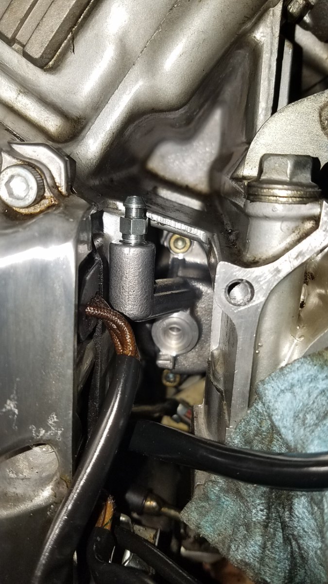

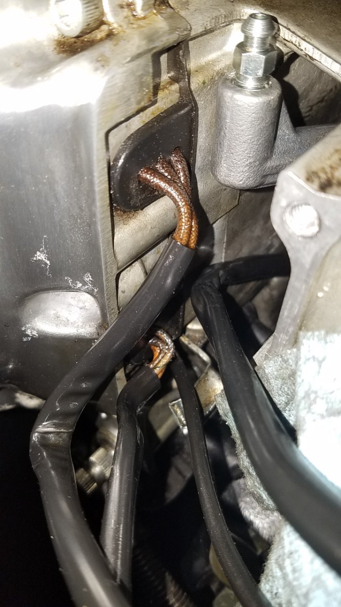

Next to the neutral switch is the clutch slave cylinder. It can leak where it's mated to engine. And above that to the left are the 2 stator wires that come out of the stator case. They can seep. If they are seeping, then when you shut down motor they could drip off wires as well.
BUT.... If any of the above were leaking, you would have a trail of oil underneath the left side of bike..... Covering parts of the left muffler, left saddlebag, kick stand and center stand areas. As they all would leak under pressure as well as when you lean bike over to left on kickstand.
All of the above leak areas can be accessed by taking off that one cover as I did in the picture I sent you. If the stator wires are the problem, then you will need the gasket for that cover to get to the wires, clean them and dry them up.
Hope this helps...
