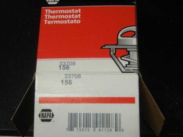

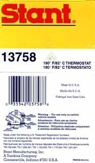

Jayceesfolly Posted July 18, 2021 Posted July 18, 2021 I use these for my '89 VR and have for a few years with no issue. They are 180 degrees. 2
larrydr Posted July 20, 2021 Author Posted July 20, 2021 On 7/18/2021 at 6:51 PM, Jayceesfolly said: I use these for my '89 VR and have for a few years with no issue. They are 180 degrees. Thanks for the picture ,,,found one with the same parts number ....I found out that my thermostat was sticking and I may replace it anyway
