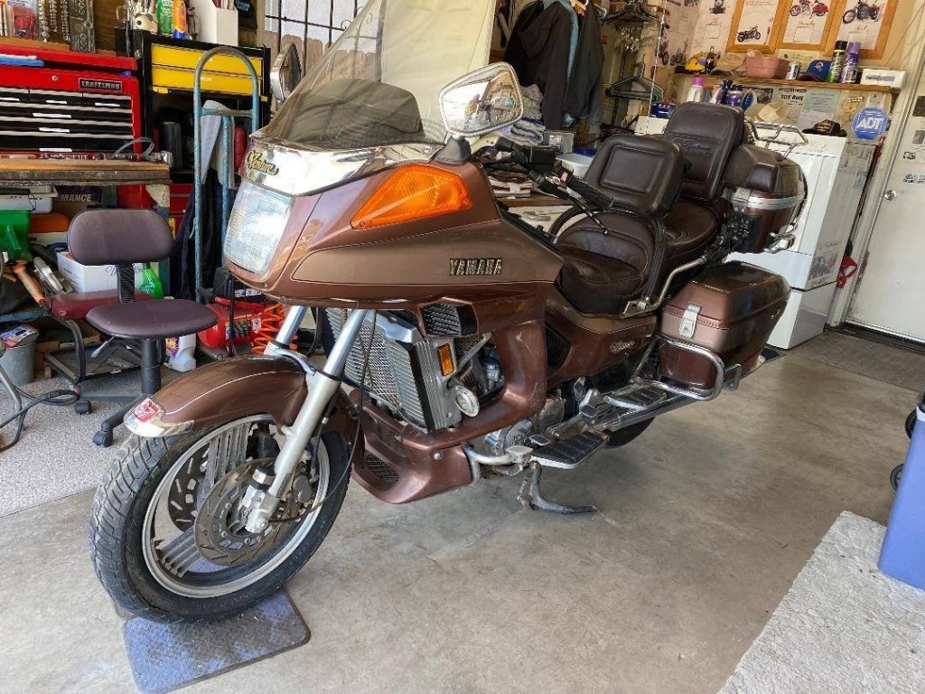

YoungWayne Posted July 9, 2021 #1 Posted July 9, 2021 (edited) Hello everybody. New to this forum. I just found a 1986 Venture Royale on craigslist. Hasn't ran in 10 years, it looks like it has ~25,000 miles. How reliable are these bikes (assuming it was in running condition)? They are asking $1,000 and cosmetically it's beautiful (picture attached). I haven't had a motorcycle in a couple years, last thing I rode was a '99 bmw f650gs, how powerful are these bikes it looks like it has a big engine. I have some mechanical experience working on my own car, but I haven't had to dig into the engine except to change the valve cover gasket. Looking forward to any feedback and wisdom, the bike looks beautiful and I've been wanting a motorcycle project. Not sure if this is the right forum, if not please let me know I just joined! Edited July 9, 2021 by YoungWayne

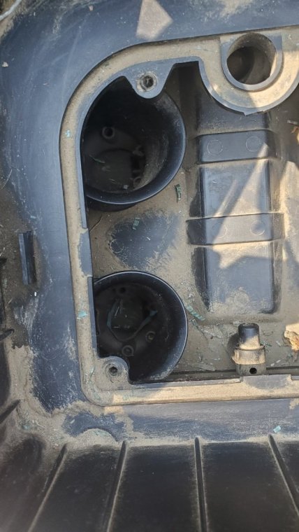

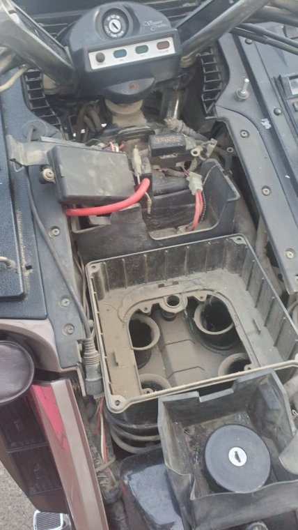

YoungWayne Posted July 12, 2021 Author #20 Posted July 12, 2021 (edited) On 7/11/2021 at 10:32 PM, saddlebum said: A compression check here is not a bad idea. Don't look for perfect readings at this time you just want a general idea that you at least have reasonable compression just to be sure there are no major issues. The valve clearance I would not worry to much about just yet unless there is a definite issue. Myself if an engine has not run for a while I prefer to run a few additional miles on it before setting valves, get things resettled so to speak. If the engine wont start but you have spark trickle a little bit of gas or lighter fluid down each carb (Start with about a tablespoon in each), then crank it and see if it will fire it should run for a few seconds. This will at least tell you if the engine is capable of firing up. Next move onto the carbs. Gentley with a long screw driver see if the sliders move freely a little bit of seafoam dribbled on the barrels before hand will lube them up a bit..Next I would give the carbs a good flush or what many here like to call a hot shot with carb cleaner. you can do this without removing the carbs. No point in me going into detail here as the tech section has good info on how to do this. Expand Just to be explicit since I'm no expert, I should try this with oil in the engine correct? I will definitely be trying this when it comes around to that time. I'll check out the tech section as well thanks! On 7/12/2021 at 12:05 AM, Tysons87venture said: I agree, see if you can get it to fire without taking carbs off right away, in my case I needed to remove as I couldnt get it to fire even with a new battery and spraying seafoam up through the drain and top of carb. it was a pain to remove but learned some tricks along the way. I used starter fluid and it definitely tried to start. If I did it over again i would have done compression test first as saddlebum had said There is some great tech articles that will really help you. Also could pull seat off, 2 bolts above rear saddle covers and there is a fuel sender unit which you can carefully remove and see what he fuel looks like and if there is any rust. I used a hand fuel pump and pumped out the old fuel. I also changed my fuel filter which i believe you have to remove rear saddle bag Hope you have fun with your project and love the bike as much as I do, theres lots of great help here and surely you will be up out enjoying the road one day Expand On 7/12/2021 at 2:31 AM, cimmer said: In case you havent found them yet, here is a link to download a copy of the service manual for the first gen Ventures. These will be of some assistance in figuring out where things are and how to get to them and service them. And as always, ask us here on thing also. Rick F. Expand Thank you, I downloaded that and I'll be reading it! I'll definitely check out the air filter thank you for reminding me. It's been sitting outside in the sun hopefully no critters got in there. When I get a fresh battery and turn the key, is there anything I should be looking for or any lights I should be worried about? Haven't gotten to read about that yet, but potential air suspension problems have been worrying me. And I just ordered the Shinko thank you! Unfortunately I think getting the front tire is a must so I can get it out of the street and into the shade. Thank you, I will look for any rust and probably change the fuel filter as well, it doesn't seem like it has any old gas in there which I think is good so I can just put some fresh gas in there. I think I read about putting premium in an old engine that hasn't started Also: picture of myself helping the tow truck driver put some weight on the flat tires so he can pull it up the ramp Edited July 12, 2021 by YoungWayne picture 1
Tysons87venture Posted July 12, 2021 #21 Posted July 12, 2021 Bike looks great, be really careful with the plastics they will be really fragile when removing. For compression test I bought a gauge that screws into where the spark plug comes out of, make sure you have oil in engine while doing which you can see from sight glass Manual says remove all plugs and hold throttle open while trying to start the motor until the gauge in what ever cylinder/spark plug hole you choose reading hits its highest point, write down your max readings of every cylinder and compare 1
Pasta Burner Posted July 13, 2021 #22 Posted July 13, 2021 @YoungWayne that machine looks incredible for having been outside. As for warning lights…yep! The center computer gauge cluster will go through a series of sensor checks each time you turn the key to ON and a red warning light will blink and the fault will stay illuminated on the display until remedied. Changing the battery will almost certainly cause a fault as it’s looking for low fluid level, this can simply be eliminated by adding a resistor inline. Also the kickstand down will blink until you are ready to ride and put the kickstand up. If you put it in gear with the kickstand down it will shut off. 1
YoungWayne Posted July 13, 2021 Author #23 Posted July 13, 2021 On 7/12/2021 at 9:22 PM, Tysons87venture said: Bike looks great, be really careful with the plastics they will be really fragile when removing. For compression test I bought a gauge that screws into where the spark plug comes out of, make sure you have oil in engine while doing which you can see from sight glass Manual says remove all plugs and hold throttle open while trying to start the motor until the gauge in what ever cylinder/spark plug hole you choose reading hits its highest point, write down your max readings of every cylinder and compare Expand Thank you, I will keep the plastics in mind when removing, and I just bought a compression test kit as you and many others here have suggested. On 7/13/2021 at 3:14 AM, Pasta Burner said: @YoungWayne that machine looks incredible for having been outside. As for warning lights…yep! The center computer gauge cluster will go through a series of sensor checks each time you turn the key to ON and a red warning light will blink and the fault will stay illuminated on the display until remedied. Changing the battery will almost certainly cause a fault as it’s looking for low fluid level, this can simply be eliminated by adding a resistor inline. Also the kickstand down will blink until you are ready to ride and put the kickstand up. If you put it in gear with the kickstand down it will shut off. Expand I want to get the before pic the previous owner showed me, it was covered in dirt. It took him 2 months slowly but surely cleaning the whole thing, he even got around to removing most of the rust from the chrome with water and aluminum foil! I'll be looking for a new battery soon, I found one recommended in the tech library. I opened up the top and saw that there was no battery or air filter, at least I don't have to dispose of the old battery 😃
