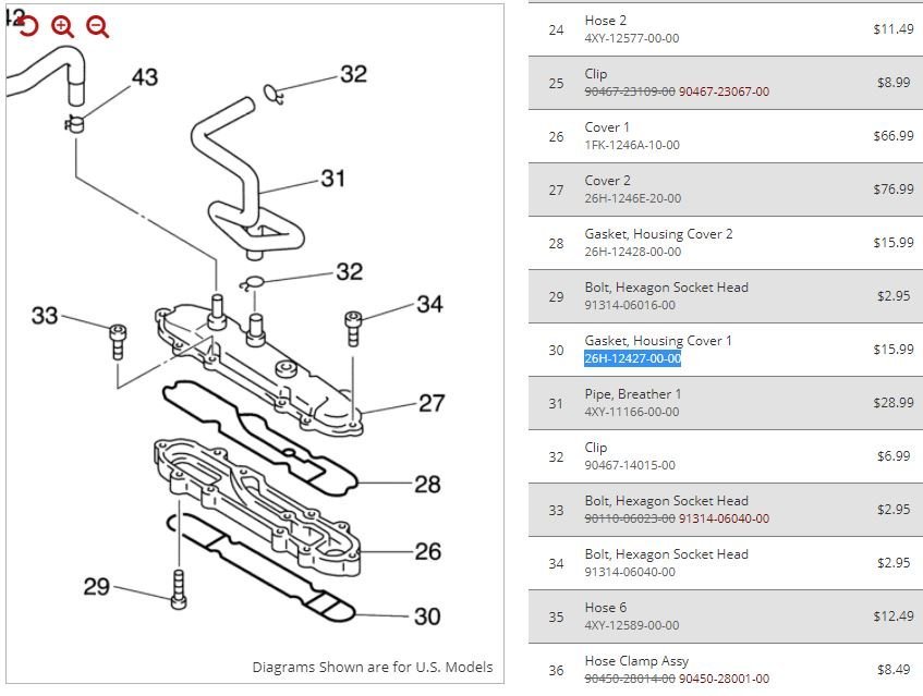

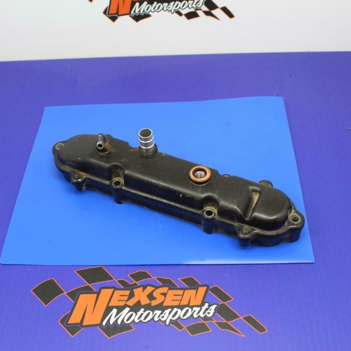

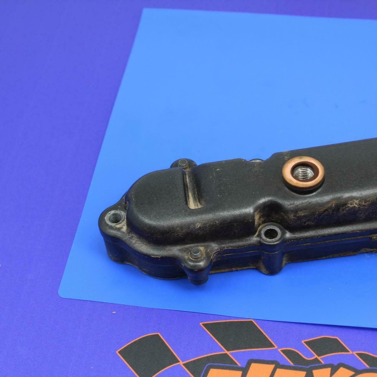

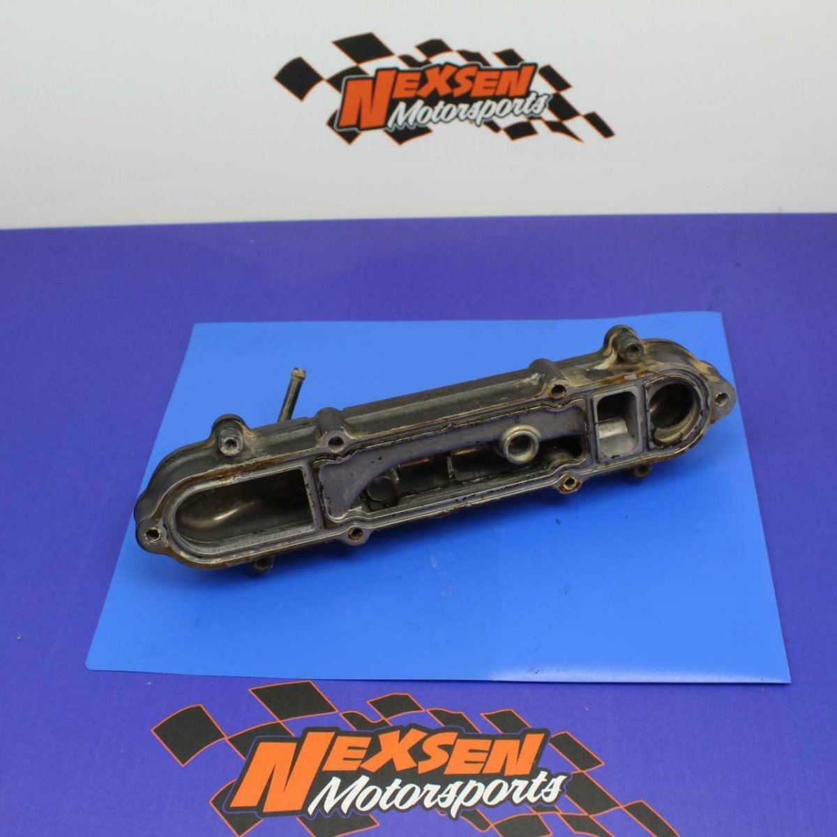

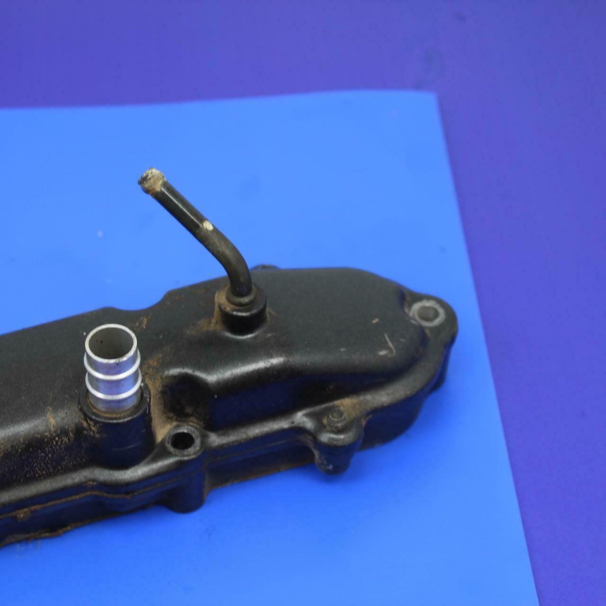

luffrr Posted August 8, 2021 Posted August 8, 2021 I am struggling with the same issue on a 2008 RSV with 24K miles. It overheated in the Tucson heat about a month ago. I found the radiator fan switch to be defective. When I opened the radiator cap I was surprised to find a light, brown oily sludge in the system. Upon researching the this issue there are several possibilities: (1) Water pump oil seal; (2) The mysterious "Twinkie." or (3) Engine head gasket. I understand that the engine is robust and the head gasket is not the usual culprit. I focused on (1). I removed the water pump and found a questionable oil seal. I purchased the parts from PartZilla for $84. I then rebuilt the pump and thoroughly flushed the system with a radiator cleaner. I went through several flushes until the drained coolant was clear. I then put in new coolant and figured it was fixed. As an additional safety I added a toggle switch in parallel with a new thermal fan switch so I could manually turn on the radiator fan. Last weekend I took a ride to Phoenix with my son. The ambient temperature was a toasty 106F. The bike did not overheat, but when refueling my son said he saw a small puddle of brown goo under my bike. The radiator reservoir under the seat again had the brown oily sludge in it. Now I am focused on (2): The mysterious "Twinkie" is a manifold located under the carburetor assembly and above the V of the cylinders. It is apparently a heat exchanger between the oil and coolant and also functions as a crankcase ventilation system. There are two gaskets. One is under the unit and mates to the engine. The other is in-between the top and bottom cover of the unit. Failure of this gasket can cause oil to get into the coolant. Also a cracked cover(s) could also cause the same. Refer to attached photos and documents for part numbers. Since my 900-pound Japanese girlfriend (RSV) is much cheaper than a psychiatrist I decided to order a used Twinkie from Ebay and the two gaskets from PartZilla. I figure if my Twinkie is defective I can swap parts and minimize downtime. I will let you know what happens. Twinkie.txt 1
