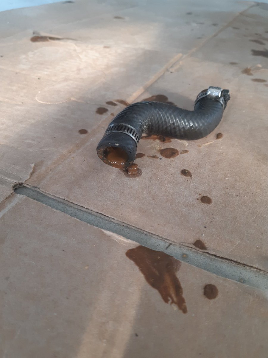

Tysons87venture Posted July 7, 2021 Posted July 7, 2021 Does this mean I have a blown head gasket? Basically looks like mud in the coolant, any advice, does this mean the bike is toast?
luvmy40 Posted July 7, 2021 Posted July 7, 2021 No first hand experience with this but, I have been told this could be the twinky gasket. Something about coolant in the oil but no oil in the coolant? Like I said, no real experience.
Tysons87venture Posted July 7, 2021 Author Posted July 7, 2021 I had done a coolant flush when first getting bike, there was some of this crud in it, I never thought anything of it just figured that dexcool had been used and that was the issue, I am now wondering if it didnt all get flushed through originally, I did a compression check and have 142psi in rear cylinders 122 on the front, still have to do the wet test and see if it changes, seems low though compared to manual, so might be looking for a new bike, love this bike with only 500 km that I got to ride on it, just dont know how much to spend on it
saddlebum Posted July 7, 2021 Posted July 7, 2021 From the picture it looks like rust mud. Has this bike been run with straight water in it by chance. In any case before tearing the engine down, I would do a thorough flush. A bit of automatic no suds dish washer powder soap and water for the first run and run engine up to temp about 15 to 20 minutes allow to cool drain and fill with clean water and run up again. Continue until relatively clean water drains out. Then fill with clean aluminum compatible antifreeze (STAY AWAY FROM GM DEXCOOL). Don'the forget to was out the overflow tank. Ride the bike and keep an eye on it. You can also do a cylinder leak down test and/or combustion gases test. You need a special tool with test fluid for this most auto parts stores carry them as does amazon. The later will tell you if the head gasket is leaking by detecting combustion gases in the rad. 2
Patch Posted July 7, 2021 Posted July 7, 2021 Just my thoughts on how I would approach this project. But first I would be hard pressed to assume the bike is toast, they just don't have that reputation. I agree with Bum on the flushing part. I however would be more aggressive in choice of chemicals. That said after flushing I would pressurize the cooling system and monitor for pressure drop. Now in this case a leak down might mislead you. At 122 the crankcase pressure must be up? When we run into that issue testing becomes a game of experience to determine or separate the issue of having pressure on both side of the piston rings. Look up "a case for fogging" here on the forum, tried proven and tested, its also safe. For me there is little doubt she'll come around.
saddlebum Posted July 7, 2021 Posted July 7, 2021 Sorry pressure testing and looking for pressure drop, or running the engine with the pressure tester on it and looking for excessive pressure build up were two items I meant to include but the Grand kids showed up so I cut myself short. There are more aggressive chemicals you can use but at the shop were I work dishwasher detergent is all we ever use when we get engines with cooling systems contaminated with either oil or diesel fuel. The more aggressive chemicals we only use if we feel that their may be a build up of scale in the cooling system. 1
Tysons87venture Posted July 7, 2021 Author Posted July 7, 2021 Thanks alot guys, I really appreciate it, I am feeling more confident now in the project, i really think I didnt get all the sludge build up in the first 4-5 flushes I did and that was before bike was on the road, now getting 500km of riding in the sludge has plugged up in areas I believe, the rad was super slow to drain so I have lots of work to do to get all this crap out of the system, aside from this bike runs fairly well, hoping the low compression is something that can be solved by adjusting valves or having a mechanic do work on the top of engine for me this winter. I'm sorry for bringing up multiple subjects in this forum if alot of this stuff is already out there, the only issue I have found with bike is running really rich, which could be to do with how I put carbs back together, i have an idle backfire and she burns tons of fuel, I have a morgan carb tune coming in the mail this week so hopefully I can learn that and see if I can sort out some issues being that every mechanic in my area is either to busy or will not even look at my bike as it is to old. I am really thankful for all you people with experience with these bikes and hope one day I can see you guys on the road. I owe you guys big time if this all works out for me, such a comfortable bike, these bikes are great! 2

Patch Posted July 8, 2021 Posted July 8, 2021 When I saw the pic of the rad hose the first thing I thought was Iron water. I once lived on a strip of land surrounded by fresh water but our well was so high in dissolved iron our heavy filtration system could keep up and was plugged in just 5 month. Or septic was just as bad. PH is a subject I haven't thought of in a long time but I do know that PH is a consideration that is balanced when you are dealing with coolant fluids. Most cleaning solution rely on temperature to reach a performance level. Is why I am aggressive when choosing one where I know I can get away with it. "slow to drain" that can be just as Bum eludes to or it can be sludge? I had this old swamp buggy 4x4 when it was cold my front wheel would drag not turn? I went to drop the diff oil yikes... So I filled it with thinner ran it lightly then drain rinse and repeated. Rich: like Ben says lots of potential reasons for this. So is low compression a cause. 1: deal with the cooling system 2: remove the carbs 3: soak the piston rings That's how I would plan it out. I'm going to vote a firm NO for the valve lash as the compression is too high for leaking valves.

Patch Posted July 8, 2021 Posted July 8, 2021 I hear what your say Bum. As you know I have work on and owned many different motorcycles still own too. Yes I can if I try hard to adjust a rocker to a faint lead but I'd be really hard press to get it to 122 lbs. Yes if I were less confident I would perform the leak down test before I get to the lash! But I'm not so I see more sticky rings then I can tribute to lash issues. Also as you and I know, sludge holds btu's longer than a proper cooling mix. The constant heat that must have been cooking up front there on those jugs and the obvious lack of engine maintenance leads me to think that that engine needs a soak and a rinse But the lesson you bring forward is valid
Tysons87venture Posted July 8, 2021 Author Posted July 8, 2021 This is great, thanks for all the advice, i really feel I am learning alot, hope to one day be at half your guys experience level. I am going to attempt to clean all this crud out of system tonight. My next question is what do you guys recommend I use for coolant? I know we had talked about using no suds dishwasher power and water for first couple flush through. And also a stronger chemical would a coolant flush product be worth the money? I used to use prestone 5050 blend in my superhawk and never had any issues. I seen patch is in Calgary, I probably gave you a wave at some point in the 7 years I spent there. I also really loved motul oil, my bike ran so smooth and shifted so nice. Do you guys have recommendations in that regard? I did read the article case for fogging and what a good read it was, really lucky to have this site, thanks again for all the work you guys put into this. So much to learn on here and when no one is willing to even look at a bike this old, I have been able to get this classic back on the road 1
