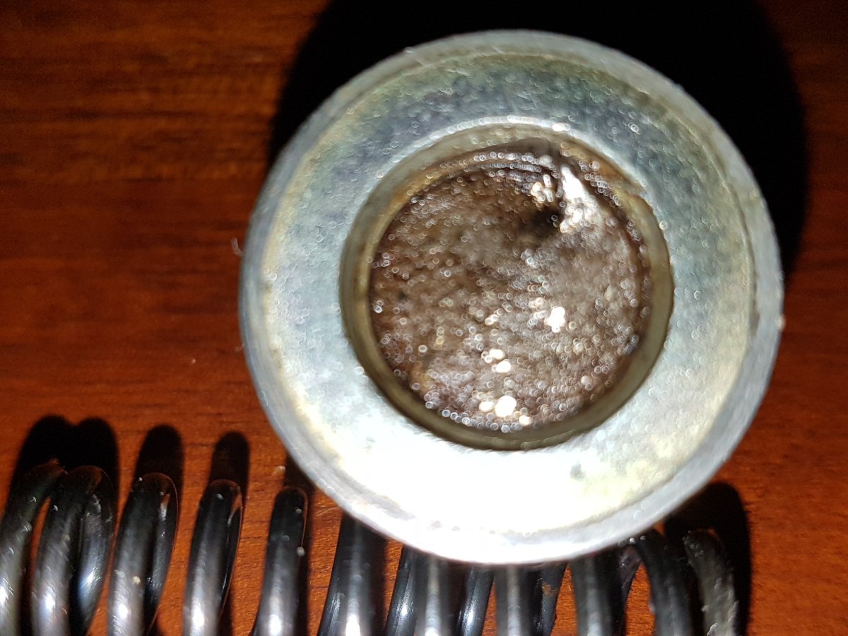

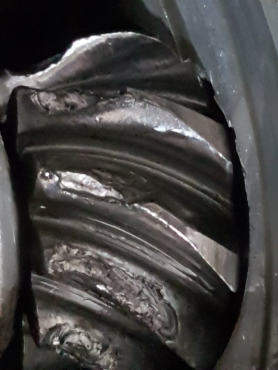

Patch Posted July 7, 2021 #4 Posted July 7, 2021 Coming back from a long trip some years ago my 91 began humming at speed. Then I noticed when parking the bike that th rollback was excessive. I pulled the final drive apart and found the pic below. I'll say this, it would be unwise to ride until you go thru it, NO shortcuts.
