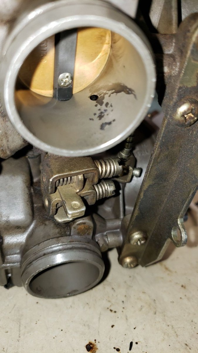

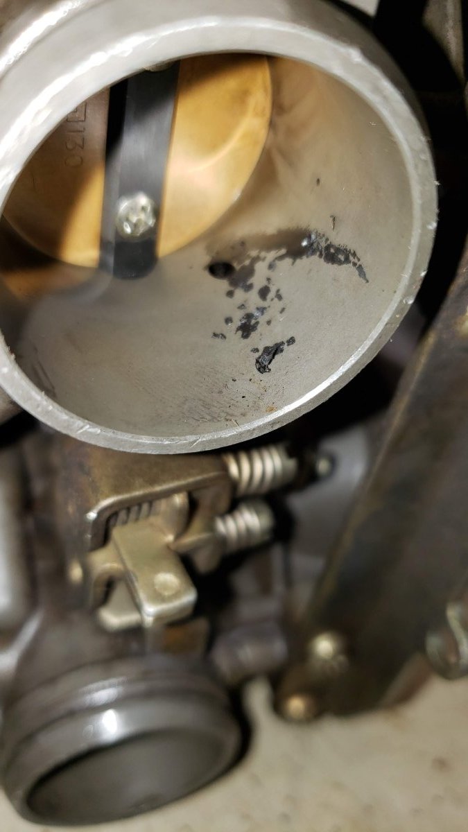

TTrax Posted October 23, 2021 Author #49 Posted October 23, 2021 Wonder what the heck this stuff is. Coming out of the smaller of the two holes on the engine side of the throttle plate. When scratched with a pick it comes off and seems rubbery in composition. Anyone ever see anything like this?
cimmer Posted October 26, 2021 #50 Posted October 26, 2021 When you say the smaller of the two holes, are you aware there are 3 holes between the engine and the throttle blade. The smallest of the holes is the idle Pilot outlet hole for the idle circuit. This hole is passing a fuel/air mixture and if the black stuff is coming out of there, it could be a bad o-ring that is used in the pilot screw set. The other 2 holes appear to be air holes for vacuum the coasting enrichment valve assemble and piston valve/diaphragms. You might have to remove the pilot screw and see what shape the o-rings are in. Be aware there is a spring, washer and o-ring in there and they can be hard to remove. You might need to stick a small stiff wire in there to work them all out and there are replacements available for a number of sources. Hope this helps. Rick F.
