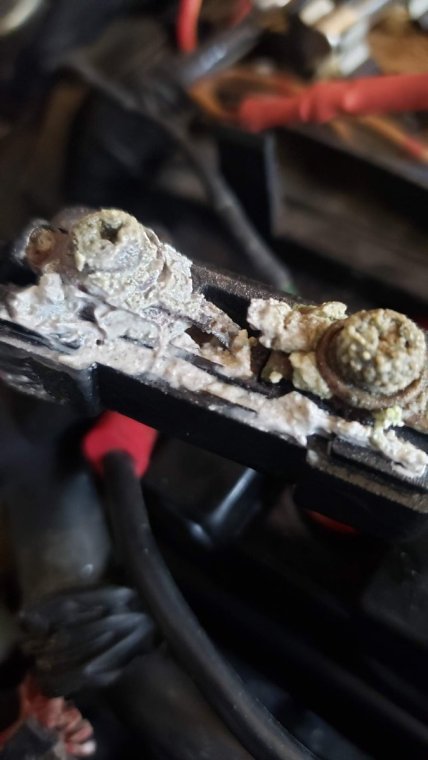

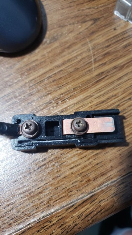

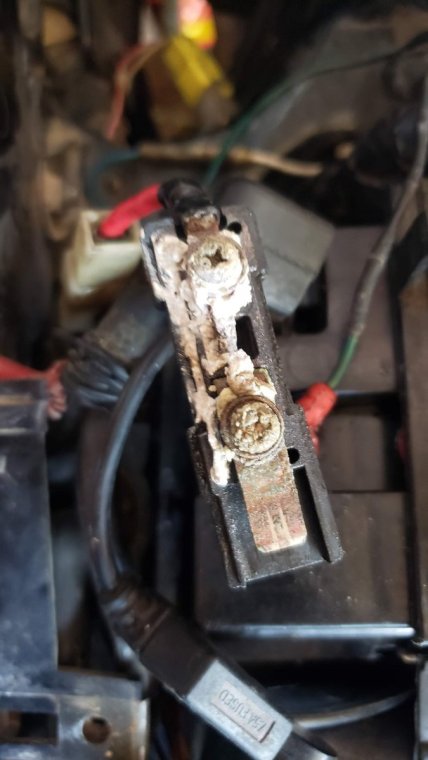

TTrax Posted June 25, 2021 Author #10 Posted June 25, 2021 Another possibility is forming now... I have the battery on the charger since yesterday. It is a "smart" charger and is set for 2 amps. Battery has been charging since yesterday afternoon and this morning the charger is still going at it. I can hear some pretty good bubbling coming from the battery. Wonder if it is possible a battery still has the guts to start an engine but still cause ignition issues? This will be on my list of possible problems if the fuel pump and line replacement doesn't resolve the issue.
Marcarl Posted June 25, 2021 #11 Posted June 25, 2021 Depends on what the running voltage is. If the stator is producing 13 some volts when running, then you should be ok for ignition from that point. On the other hand, you might have enough to start, but if the stator isn't producing then you will run into low voltage and then the ignition will start to fail,, but the bike won't start again either. So check the running voltage, it needs to be over 13v. Also, check your battery before you go to bed, it should be 12.6v and then check it again when you get up. No charger attached. It should not be less than 12.5v. If it reads 12.0v then the battery has problems. 1
videoarizona Posted June 25, 2021 #12 Posted June 25, 2021 When my red fuel line caused problems, it was a direct starvation issue. I gather what was happening was at high speed or under acceleration, the carbs would run out of fuel due to the line collapsing... Hence the scoot would bog down immediately. By the way you described your problem, my first thought was spark. It's easy to understand an engine bogging down at a certain rpm/load every time when you think electrical. But replacing the tci should have cured that. Stator not putting out enough volts? Don't think that would be an rpm issue unless something in the stator case is shorting out due to centrifugal force or high heat. But can't say I've ever heard of that on a non- points system. This is interesting... For sure. Hang in there... You'll get it! 1
saddlebum Posted June 25, 2021 #13 Posted June 25, 2021 6 hours ago, TTrax said: Another possibility is forming now... I have the battery on the charger since yesterday. It is a "smart" charger and is set for 2 amps. Battery has been charging since yesterday afternoon and this morning the charger is still going at it. I can hear some pretty good bubbling coming from the battery. Wonder if it is possible a battery still has the guts to start an engine but still cause ignition issues? This will be on my list of possible problems if the fuel pump and line replacement doesn't resolve the issue. Bubbling is not a good sign, you are boiling your battery you may want to check your fluid level. This is usually an indication that you are over charging your battery (even at two amps the charger could be putting out too much voltage for the battery). The other cause of a boiling battery is that it is just no good, possibly internally shorted out due to sediment build up in the battery ( if it is just a lead acid battery you could try dropping an aspirin in each cell, Its an old trick but it does sometimes work I once got an extra year out of a car battery with this trick). 1
TTrax Posted June 26, 2021 Author #14 Posted June 26, 2021 32 minutes ago, Marcarl said: Depends on what the running voltage is. If the stator is producing 13 some volts when running, then you should be ok for ignition from that point. On the other hand, you might have enough to start, but if the stator isn't producing then you will run into low voltage and then the ignition will start to fail,, but the bike won't start again either. So check the running voltage, it needs to be over 13v. Also, check your battery before you go to bed, it should be 12.6v and then check it again when you get up. No charger attached. It should not be less than 12.5v. If it reads 12.0v then the battery has problems. OK thanks. Maybe not a problem, the charger indicated 12.5 volts when I first hooked it up but don't remember the battery gurgling like it is when I initially charged it. The only time I ever see the charge level drop on the voltmeter is when I use the brakes.
