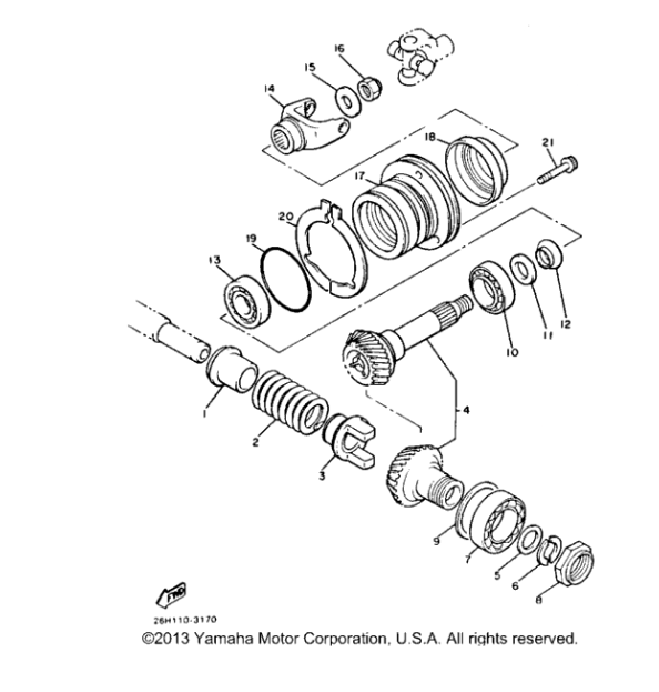

Marcarl Posted June 21, 2021 Posted June 21, 2021 It could be the u-joint at the rear of the transmission #s 14,15,16.. You can pull the boot back to have a peek. Other than that I would suggest it's internal in the tranny, possibly item #4. Try turning the rear wheel and take a listen to the shaft and tranny, see if there is anything noise at all.

saddlebum Posted June 22, 2021 Posted June 22, 2021 (edited) 18 hours ago, windrider1983 said: Clarification - The rear wheel is not currently locked up. The bike is on the big stand and the rear wheel will turn. I can start the engine (in neutral of course), squeeze the clutch, and tap down into first or lift up into second, and the engine dies without ever releasing the clutch. Ok so you say the wheel turns in neutral. When it turns does it feel relatively smooth with no odd noises. If so than I would say the final drive. drive shaft, u-joints and rest of parts in the parts breakdown Marcal posted are OK. With it in gear can you still turn the wheel with the clutch pulled in? from your description I am thinking you cannot, so my next move would be to check clutch operation. Start by making sure there is no air in the system. Then check to see if the master is actually functioning properly. It could be bypassing internally and not applying pressure to the slave. Check to see if you are loosing clutch fluid. The slave could be leaking internally and loosing fluid. Drain engine oil into a clean container. Does the oil look normal or is there metal in the oil? Remove the clutch cover so you can observe the clutch while actuating the clutch lever. you should see movement between the discs. If not then you will have to see why. Remove the Clutch. with the clutch removed and transmission in gear does the wheel now turn or is it still locked up. If still locked up you may have to pull engine and get into the transmission to see what is going on. Keep in mind this is all couch technique diagnostics If I had the bike in front of me I might take a different approach. Edited June 22, 2021 by saddlebum
larrydr Posted June 22, 2021 Posted June 22, 2021 2 hours ago, saddlebum said: Ok so you say the wheel turns in neutral. When it turns does it feel relatively smooth with no odd noises. If so than I would say the final drive. drive shaft, u-joints and rest of parts in the parts breakdown Marcal posted are OK. With it in gear can you still turn the wheel with the clutch pulled in? from your description I am thinking you cannot, so my next move would be to check clutch operation. Start by making sure there is no air in the system. Then check to see if the master is actually functioning properly. It could be bypassing internally and not applying pressure to the slave. Check to see if you are loosing clutch fluid. The slave could be leaking internally and loosing fluid. Drain engine oil into a clean container. Does the oil look normal or is there metal in the oil? Remove the clutch cover so you can observe the clutch while actuating the clutch lever. you should see movement between the discs. If not then you will have to see why. Remove the Clutch. with the clutch removed and transmission in gear does the wheel now turn or is it still locked up. If still locked up you may have to pull engine and get into the transmission to see what is going on. This may no be the answer to your problem , but what happened to me was I had the kick /side stand and center down and when I put it into gear the engine went dead . That is what it is supposed to do ...The kick stand switch should shut the engine down when the bike goes into gear when the stand is down
