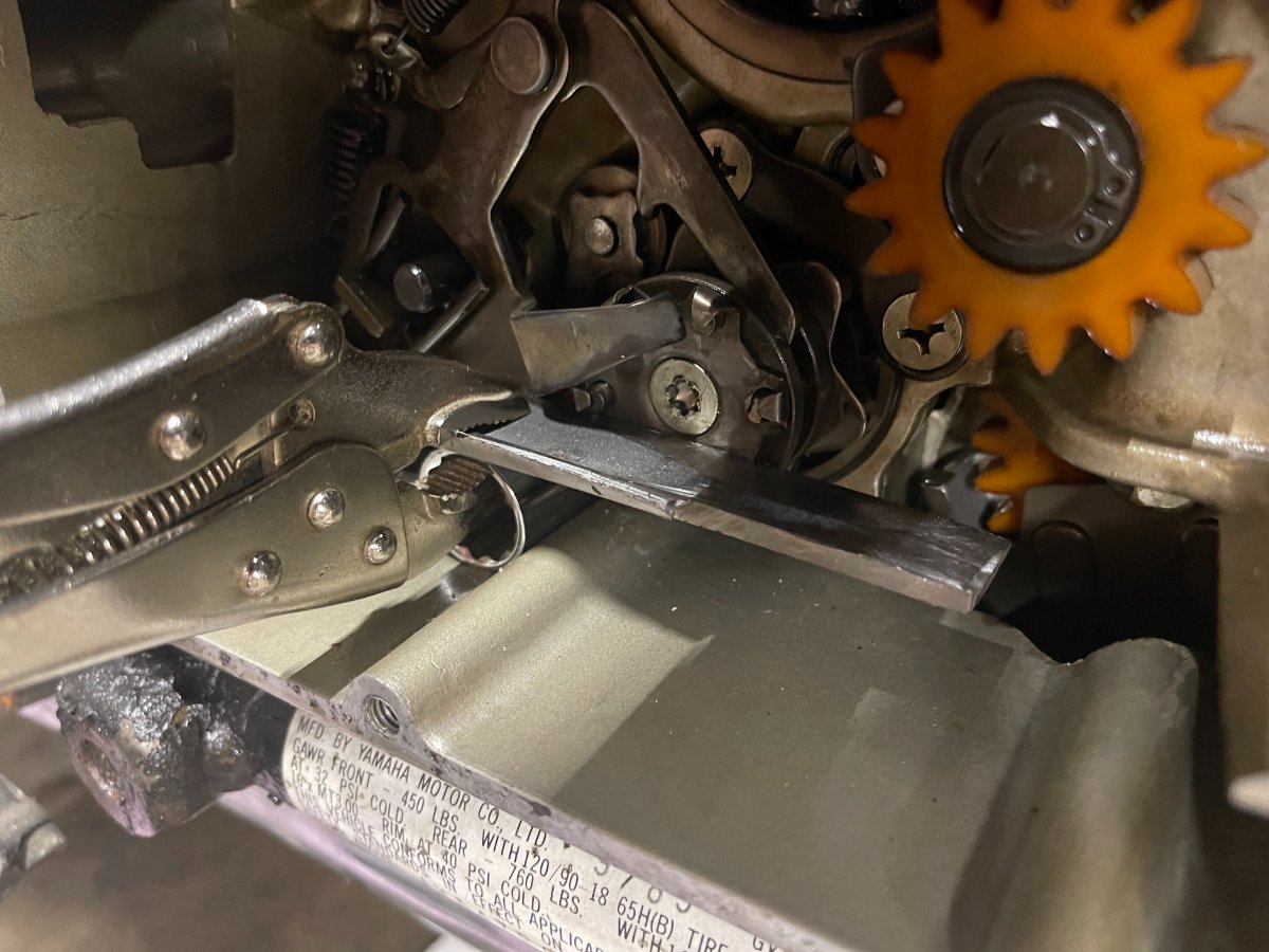

JFootman Posted June 11, 2021 Author Posted June 11, 2021 (edited) Still feeling like a bit of a boob as every forum post I have read grazes over the screw removal with exception of "don't strip it" and apply heat. I've tried to gain insight from the service manual but I don't see anything that describes the segment removal. I'm using THIS post as a guide (among others) but again I feel like I must be making a mountain out of a molehill or just not bright enough to easily see the solution. Will this work? The socket was placed under the shift lever to keep it out of the way. Small piece of steel vice-gripped to the socket and slid under the pin to prevent downwards rotation. I don't like the torsion that will be placed on the drum but I don't see any other way. There is no pressure on the shift lever but all the force will be downwards on the housing. I've got a Dewalt 1/4" impact driver with a Torx bit and also have a Torx socket and a breaker bar available. Fearing my membership dues may increase exponentially next year.... Edited June 11, 2021 by JFootman Added image
Marcarl Posted June 11, 2021 Posted June 11, 2021 Yep, probably in there with lock-tite. I've never had to remove that bunny, but if I were the one tasked with the issue, here's what I would do. First turn the shift drum all the way counter clockwise, that way I could get rid of the extra tools. Then with a small torch, propane would be fine, I would heat the bolt head for a while. Then I would insert the torx bit, on the end of my impact gun, making sure it was turning in the right direction the first time, and then with a good amount of forward pressure, hold my breath, quit shaking and squeeze the trigger a quick burst. That would tell me if there was enough heat on the threads to loosen the lock-tite. 2
saddlebum Posted June 11, 2021 Posted June 11, 2021 (edited) I would do as Marcarl stated with one exception I would avoid use of an impact gun using it as a last resort only. in my field as a heavy duty mechanic, I have seen far too many torx heads round out or round off because of the way an impact gun works. Use a hand tool and steady pressure is the the safest way using a longer handle if needed the bit may break but at least you won't round out the head. you can also try heating the head of the bolt (red if possible) then immediately and quickly quench the head with cold water repeat a couple of times then again attempt to back the screw out. Failing that use a hand impact driver such as https://www.grainger.ca/en/product/p/KDT1140D?gclid=Cj0KCQjwk4yGBhDQARIsACGfAetK2Sr16P1iz7MT8c9hl2d_b2ZpA_ZnABnq1GAe3wi5TAWt72ihl-MaAgg9EALw_wcB&cm_mmc=PPC:+Google+PLA&ef_id=Cj0KCQjwk4yGBhDQARIsACGfAetK2Sr16P1iz7MT8c9hl2d_b2ZpA_ZnABnq1GAe3wi5TAWt72ihl-MaAgg9EALw_wcB:G:s&s_kwcid=AL!3645!3!303422060307!!!g!296274828640! to try to remove the screw this tool twists as you wack the end with a hammer while twisting the tool in the proper direction which will supply both inward pressure and twist at the same time. If all this fails then try an impact gun as a last resort. by this time the screw may even have given in a bit and become a bit more cooperative. Edited June 11, 2021 by saddlebum 2
JFootman Posted June 11, 2021 Author Posted June 11, 2021 Thx, @Marcarl & @saddlebum. Admittedly it was a sleepless night (all I can think about is shearing off the screw!) so this is brainpower with less than 3 hours of sleep on it so bear with me. Neither of you believe it is necessary to support or reverse the twist against the drum? Put it in 1st or 5th (whichever is at the end of the counterclockwise rotation) and start the heating process? I suppose the reason no one is making a fuss over the bolt is they are doing just that. I have a cheap-o Harbor Freight impact driver but again, not having gone to this degree of mechanic work I'm just anxious about screwing anything up. Beating on a screw or bolt when I can visualize the steel I'm pounding against is a more comfortable proposition! I guess I just need to man up and quit being a wuss about this. I also suppose the worst case scenario I strip the screw or bugger up the drum & I purchase a new one. I've always spent more than twice the time thinking about a problem than it takes to perform the task & usually it's the first solution I came up with!

JFootman Posted June 12, 2021 Author Posted June 12, 2021 I know this is getting old for everyone (moderator can move topic to "Tech Talk" or maybe there's a forum "this is what a wrench is..." or "mechanics 101") as this has morphed into a greenie orientation into bike work but my worst fears have happened. Heated bolt (well beyond 500 degrees) and used Torx socket. The head of the socket twisted. Purchased replacement and heated the bolt & quenched x3 then heated again and no dice. Also tried the impact driver. Then used a small socket over bolt head and smacked 3x aggressively, heated to the point the shift lever assembly covering the shift segment was red hot (heat was focused on the bolt however) and yet another Torx socket twisted unfortunately buggering the head of the screw this time. I have drilled out the bolt & the head is removed, dowels and retaining plate pulled however the arms of the shift lever assembly will not move up or out far enough to remove the segment off of the remaining bolt. Another "walkthrough" on replacing the segment had recommended loosening the clamp on the shift shaft on the other side to move it out and up but after reading all the horror stories of leaking oil seals has made me reluctant to drive the shaft out forcibly but I don't see any other solution. I've loosened the clamp bolt hoping there would be enough play and there's not. My expectation now is to drive the shaft part of the way out from the other side, rotate the end assembly up, remove the segment I'm planning on replacing & exposing the bolt. Heat the remaining bolt directly and hopefully pulling without issue (yeah, like that's gonna happen!). Of course any monkey can tear things apart so we'll see about reassembly. I suspect I'm going to have to pull the muffler to gain access to the end of the shift shaft to reseat the (possibly now leaking) oil seal and clamp. Got a few more hours sleep last night but hope I'm thinking and explaining clearly. The original post might be apropos yet again if I keep screwing more things up....
