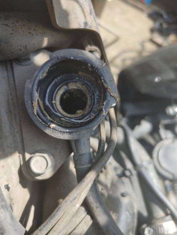

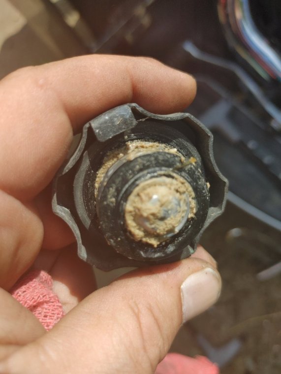

I found oil I'm my coolant. I believe it's the water pump seals? Im trying to find a shop manual. I looked in the search section. But I can never seem to find what I'm looking for. Any help would be appreciated. Thanks in advance

There is an area between the "V" of the cylinders called the "Twinkie" where engine oil and coolant come VERY close together. This is where the engine oil is cooled by the coolant. If that "O"Ring has failed, then oil and water will mix together at this one point. Because of the design of this "heat exchanger" area, you will usually see oil in the coolant, NOT coolant in the oil. If you find no coolant in the oil, I would have a close look at the Twinkie, better yet change the "O"Ring for the Twinkie and see if the this solves the issue. Obviously it's not called a "Twinkie" in the repair manual,
But there is a section on the R/R of the "O"Ring in there. If you aren't seeing any coolant dripping from the weep hole of the water pump, you're looking in the wrong place.
