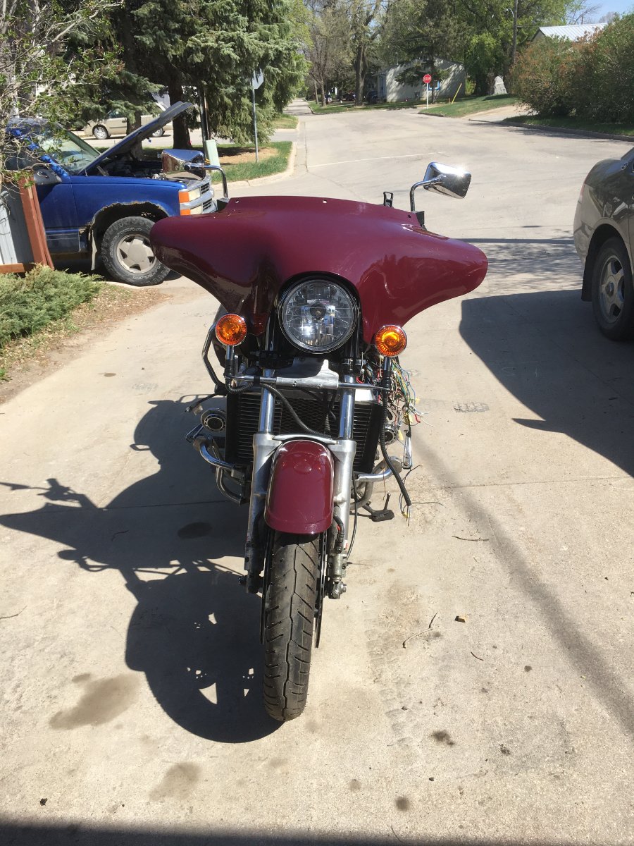

larrydr Posted May 17, 2021 Posted May 17, 2021 (edited) I am 5ft 6 and 74 years old and have been riding bike since 1960 ..I bought the Venture from a friend , runs great but very top heavy ...I decided either to sell it or change it ..So this is what I am doing , work is on going ..Have removed 65 LBS and I have lowered the bike 1 1/2 inches and installed low profile tire on the front The bike has a great feel to it . I have matched the color to the original front ... I may paint the rest of bike when the project is done .. ...I can now balance the bike with one hand on the handle bars and lean the bike over 12 inches past centre and bring it back to straight up right Edited May 20, 2021 by larrydr
