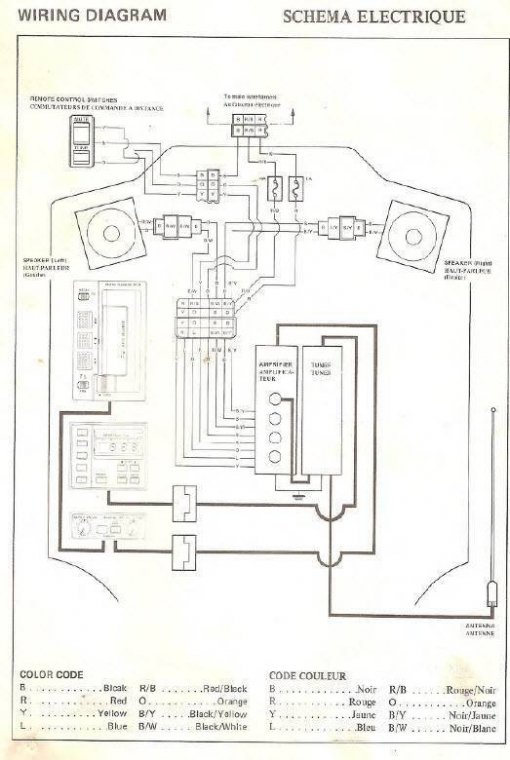

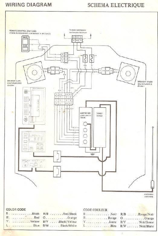

videoarizona Posted May 16, 2021 Posted May 16, 2021 16 hours ago, Pasta Burner said: I posted this originally in the gen 1 tech forum but it quickly became not a generation issue but an electronic issue. Any help is appreciated. Pasta, if you know all this...disregard. Otherwise.... I just went through all of my manuals and can't find any reference to Yamaha using error codes for the cb. So... If that's true then the "7" you see is the channel the unit is on. If you can't change channels, then that's one problem. Since you are already having fun with the circuit board, I'll not go farther. Download the manual from our site. The wiring and block diagrams are detailed. There is a problem flow chart to follow for different issues. Hope this helps. I have the manuals on my phone and can email to you. But they are available on site. 1
Pasta Burner Posted May 16, 2021 Author Posted May 16, 2021 Thanks @videoarizona I’ll have to see if I can find the CB schematic. It’s not an error code, the CB is working fine when turned on. The 7 appears when it is powered off, it’s picking up stray voltage from somewhere. It even displays the 7 when the ignition is off. So being that the CB circuit is ACC and ON only I’ve got a starting point.
videoarizona Posted May 17, 2021 Posted May 17, 2021 7 hours ago, Pasta Burner said: Thanks @videoarizona I’ll have to see if I can find the CB schematic. It’s not an error code, the CB is working fine when turned on. The 7 appears when it is powered off, it’s picking up stray voltage from somewhere. It even displays the 7 when the ignition is off. So being that the CB circuit is ACC and ON only I’ve got a starting point. Yikes. Guess I didn't get that from first post. You definitely have a crossed wire somewhere. Let me know if you can't find the schematic, I can email or PM the file to you.
videoarizona Posted May 17, 2021 Posted May 17, 2021 0 7 minutes ago, videoarizona said: Yikes. Guess I didn't get that from first post. You definitely have a crossed wire somewhere. Let me know if you can't find the schematic, I can email or PM the file to you. Shoot.. The files are in my phone. Here ya go. Hope this helps. 1989 VR Wiring.pdf CB System Introduction - 86 tech manual.pdf CB Radio troubleshooting - 86 tech manual.pdf CB radio cabling - 86 tech manual.pdf 2
