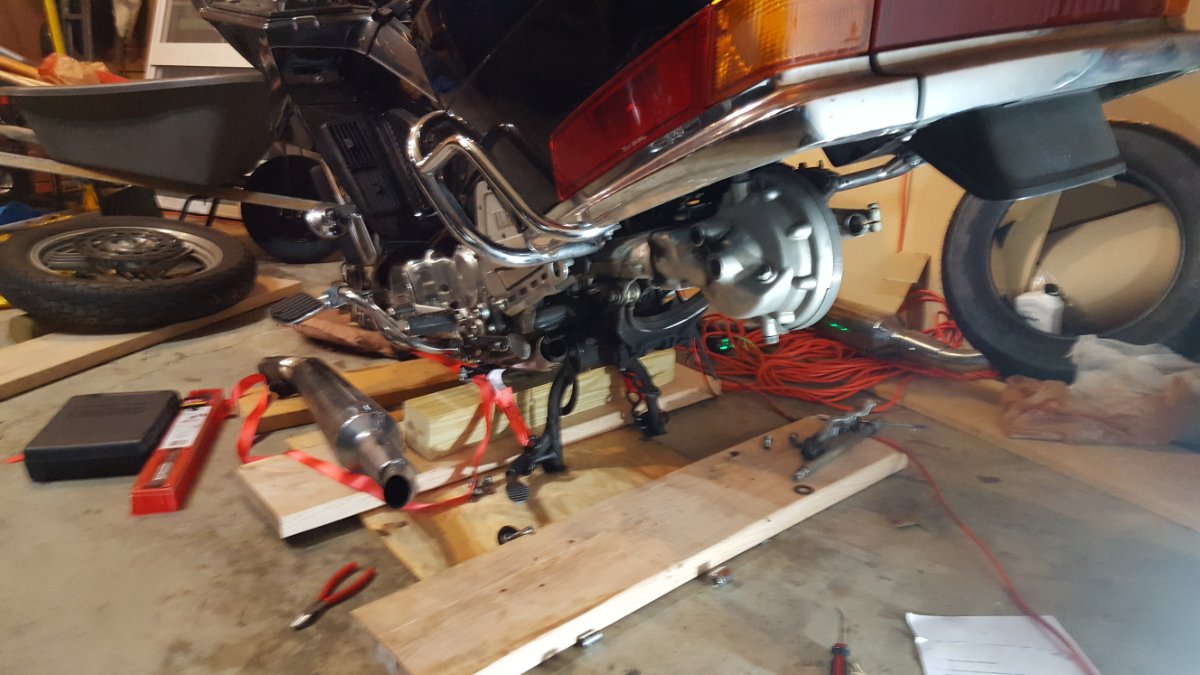

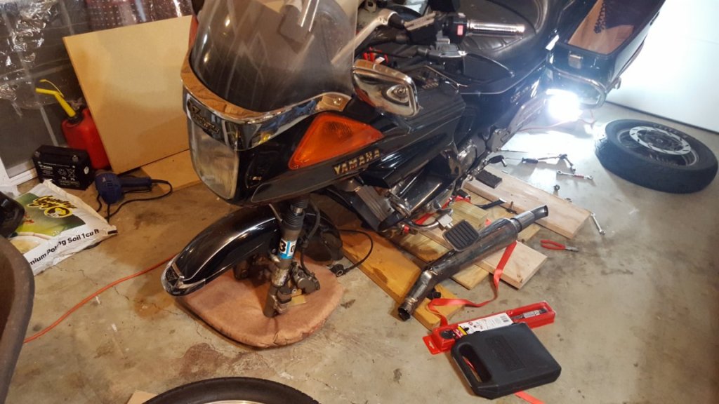

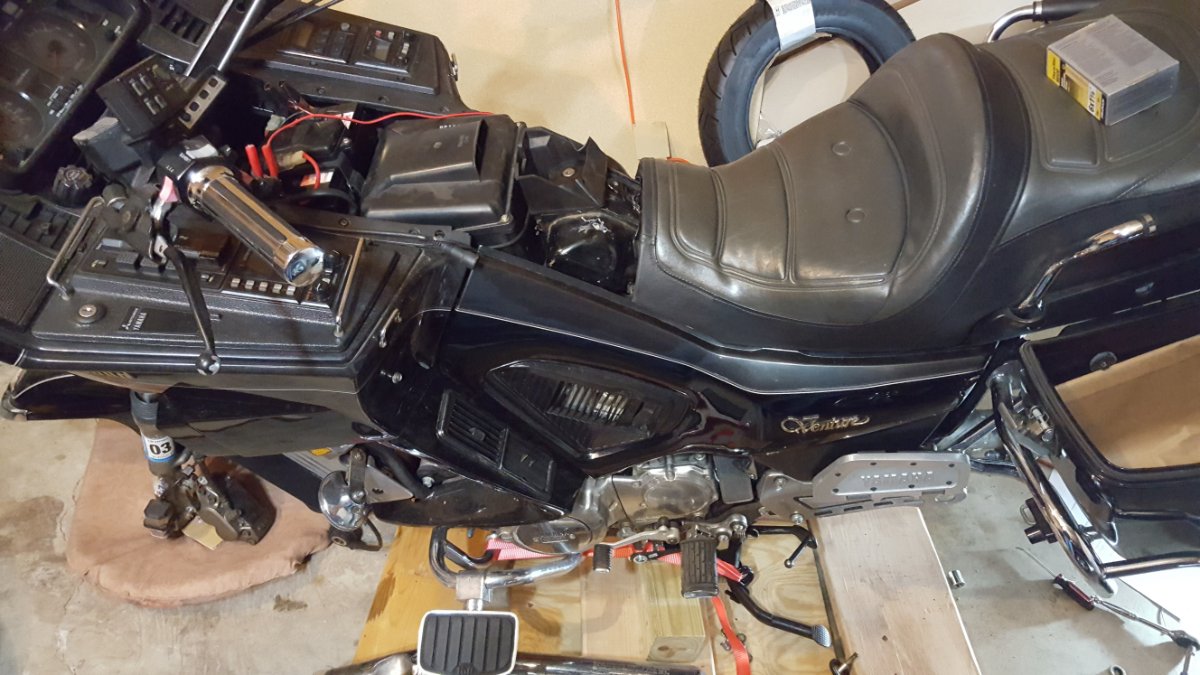

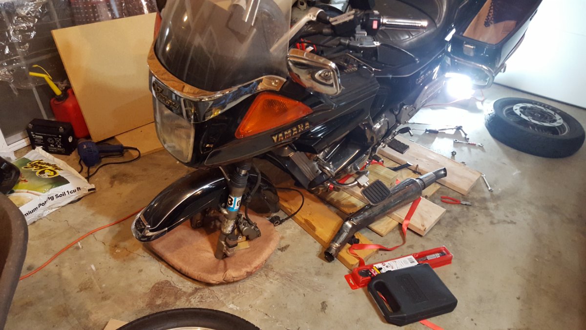

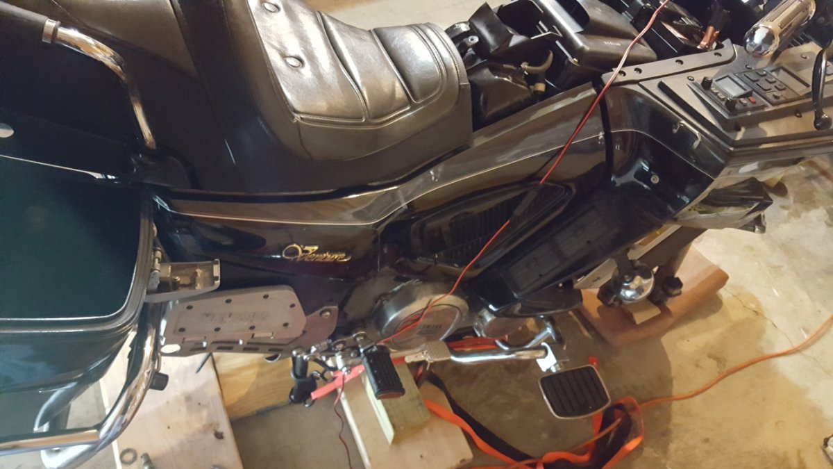

Well I finally got some time to work on the bike. Using all the useful information posted, I was able to get both wheels off. I don't know why I was so worried about not having enough clearance. Once I removed the from wheel, the rear wheel was way up in the air. I had some difficulty removing the cotter pin but ultimately was able to get it out. Also had some difficulty getting enough leverage and clearance to remove the final drive bolts. Tomorrow, a shop will mount and balance my new tires. Attached are some pictures. I am sure I will back asking questions when I am reinstalling the wheels. Thanks for all the good advice. I would not have gotten this far without it.  20210513_230559.thumb.jpg.2e2676352fcbffdce5eeee15c7e3d269.jpg

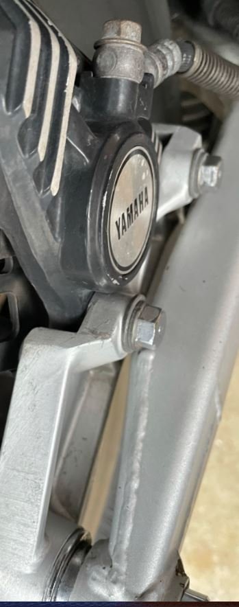

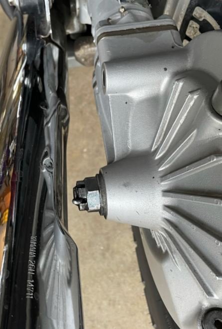

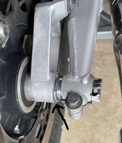

Posted (edited)
11 hours ago, Marcarl said:
Did you loose the 'washer spacer' that sits inside and flush with the wheel? Did you install the large washer in the proper sequence?
This washer is what Marcarl is asking about
Edited by SpencerPJ
  • Like 1
I went back and took off front wheel and then rear wheel.  Replaced everything, making sure to put spacer in correct spot and wheel still does not move freely.  It seems almost as if the brakes are on.  Spencer, the amount of axle shown in your picture is when everything is torqued to specifications?  My axle goes in past the holes in the axle.

I'm tinking you might be missing the spacer washer that sits inside the wheel hub then. Can you take some pictures for us?

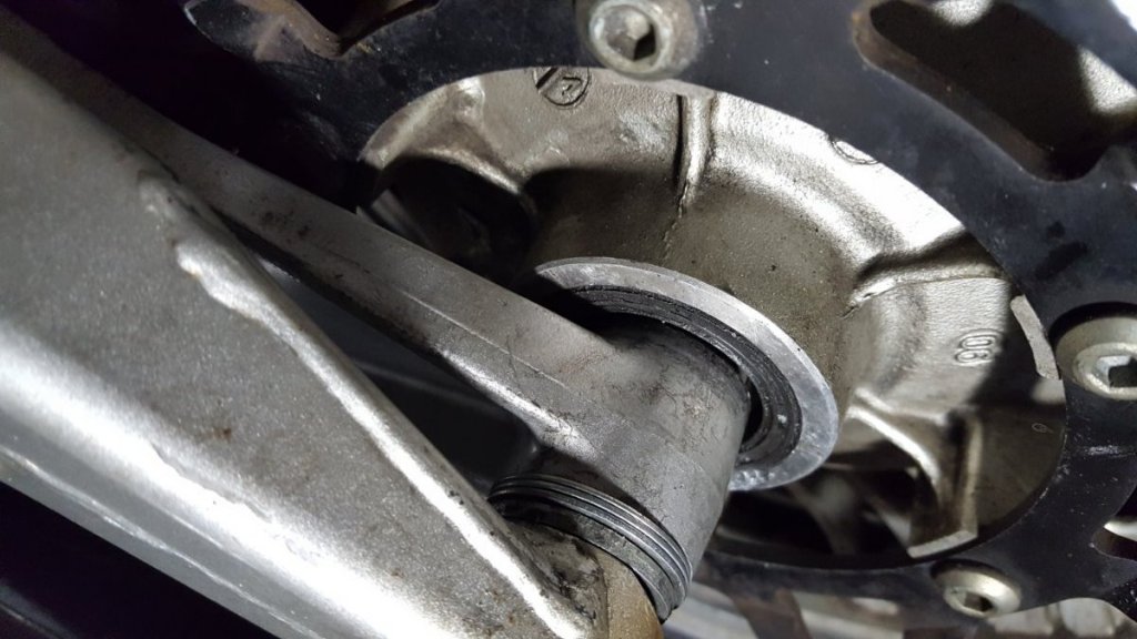

37 minutes ago, vulcanb822 said:
Here are some pictures. I actually added a couple of washers in this picture just to see if it would help. 20210705_205204.thumb.jpg.629d4b6dd0490f32927228e0e1ced506.jpg20210705_205200.thumb.jpg.2139707954143d06920a7d69b91079ee.jpg
You don’t want the extra washers.
Looks like a missing spacer. Go back to the garage and see if it's laying around the tire machine somewhere, or in the vehicle you used to get it there. It looks like a really thick washer with an extra collar on it. The collar matches the spacer/bearing inside the wheel.
  • Like 1
Correct
Here are a couple other pictures that might be of help,
I checked my garage and the back of my truck for the missing spacer.  No luck.  Went over to the shop that replaced the tires for me and the shop is closed this week with the owner on vacation.  Since it's been so long (over two months) from when I had the tires replaced, I am doubtful the spacer is there.  So, I ordered the spacer from a dealer.  The dealer told me it would arrive in 4-5 business days.  Hopefully I ordered the right part.  (90387-200J2-00 COLLAR)
