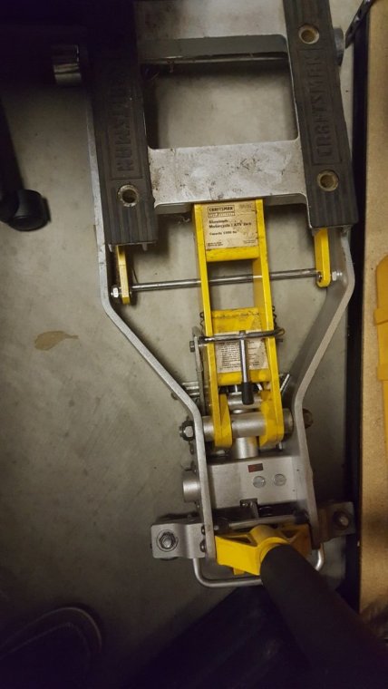

vulcanb822 Posted April 27, 2021 Posted April 27, 2021 It's time for some new tires. I purchased the Shinko 777 for the rear, and the Elite 4 for the front. My plan is to take the wheels off the bike and have bike shop replace the tires. My question is what is the level of difficulty in removing the wheels? I have the attached jack.
djh3 Posted April 27, 2021 Posted April 27, 2021 Different bike experience on the 2nd gen. But no matter which wheel you take off first the bike will want to list. I wouldnt think the difficulty is any difference than a 2nd gen. Puc is the master of tire changing on the first gens.
luvmy40 Posted April 27, 2021 Posted April 27, 2021 (edited) MK1 or MK2? The MK1 makes short work of removing the rear tire compared to the MK2. I wouldn't say either is dificult but there is a good bit of prep work to get to actually removing the wheel. Follow the service manual and you will have no problems. There are some short cuts that work, but I would advise going by the book the first time around. One good short cut, if you pay close attention and do it safely, allows you to remove both wheels from the centerstand with no lift. Set up on the center stand, then use a ratchet strap from the center stand to the front frame to secure the center stand in the forward position. use a small bottle jack under the front cross member to lift the front end and remove the front wheel by the book. Let the bottle jack down, pull the front end down and secure it with a tied down strap. Remove rear wheel by the book. It's critical to do this on a solid, flat surface free of debris. Do not attempt this method on grass or a gravel driveway. Edited April 27, 2021 by luvmy40 2
SpencerPJ Posted April 27, 2021 Posted April 27, 2021 Neither are difficult if you are a bit handy, I just did mine a month ago. Take several pictures as you go, that way you will know the exact washer placement etc when you reassemble. Rear is a bit heavy to lift and hold while assembling, I use a rolling floor jack to assist.

Du-Rron Posted May 1, 2021 Posted May 1, 2021 Has anybody mentioned the need to use a Jack Adapter to get the thing up in the air? Or Blocks on the Jack and tie the thing down real good.???
vulcanb822 Posted May 1, 2021 Author Posted May 1, 2021 When referring to a jack adapter, is an adapter needed when using a jack specifically designed for motorcycles? I have the one pictured at the start of this thread. Also, I have the 1991 Venture. I believe that is referred to as MK1???
Squidley Posted May 1, 2021 Posted May 1, 2021 1 hour ago, vulcanb822 said: Also, I have the 1991 Venture. I believe that is referred to as MK1??? A '91 we would refer to as a 1st gen MKII. '83 thru '85 are the original 1200cc motor (MKI) '86 thru '93 are the 1300cc motor and a body style change (MKII) 2
vulcanb822 Posted May 1, 2021 Author Posted May 1, 2021 Thanks Squidley. Someone mentioned making sure I tie the bike down good. Am I tying it down to anything in particular? Sorry for all the questions. Just trying to make sure I'm not missing anything.
vulcanb822 Posted May 2, 2021 Author Posted May 2, 2021 I am having trouble getting the center stand onto my 2 X 4. Any suggestions?
luvmy40 Posted May 2, 2021 Posted May 2, 2021 Help from a friend. Getting it up on a 2x4 is going to be quite challenging by yourself. You really don't need the extra height. If you are going to use my suggested method, make sure you use a ratchet strap to secure the center stand in the down/forward position. I'd use a 2x6 at least. You don't want any chance of knocking it off when rocking the front end down. .
vulcanb822 Posted May 2, 2021 Author Posted May 2, 2021 On 4/27/2021 at 7:16 AM, luvmy40 said: Let the bottle jack down, pull the front end down and secure it with a tied down strap. What am I securing the front end to with the tie down strap?
Du-Rron Posted May 2, 2021 Posted May 2, 2021 19 hours ago, vulcanb822 said: When referring to a jack adapter, is an adapter needed when using a jack specifically designed for motorcycles? I have the one pictured at the start of this thread. Also, I have the 1991 Venture. I believe that is referred to as MK1??? ...Nevermind... I cant read....I thought I was talking about a '99 - '13 Venture. Sorry.... Carry On!
Marcarl Posted May 2, 2021 Posted May 2, 2021 8 hours ago, vulcanb822 said: What am I securing the front end to with the tie down strap? Secured to the front of the bike, could be anywhere, but what ever you it to, can't move and needs to be solid, like part of the frame.
