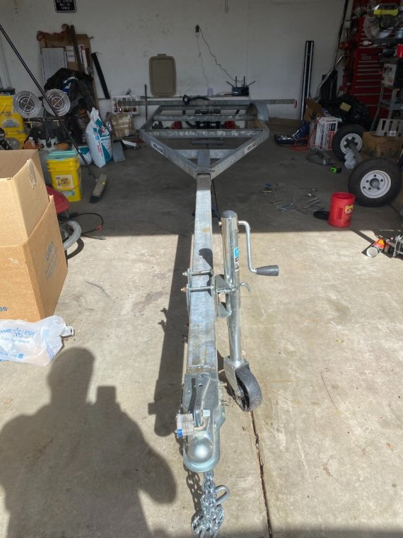

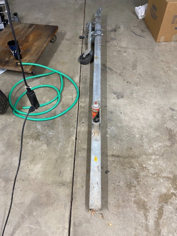

Pasta Burner Posted May 3, 2021 Author #35 Posted May 3, 2021 (edited) This is what she looks like with the tongue attached. That’s 6’ 4” from the A-frame to the ball. Here’s a link https://trailerparts.com/1-1-2-square-galvanized-axle-1-800-lb-capacity-with-1-spindles.html to the axle with dimensions 57.5” hub to hub. As @Flyinfool mentioned a rule of thumb is 1.5 - 2x axle width from axle to ball. I plan to cut the tongue down in length, curious if there are any suggestions on how far? I’m thinking it might be smarter to get the decking down and wheel chock mounted first to determine axle placement with the intended load. Also thinking about adding a tongue box. https://www.harborfreight.com/2-34-cu-ft-steel-trailer-tongue-box-62253.html I also think I decided on 2x6 Douglas Fir decking. Next I’m gonna have to figure out where to store this thing 😬. She won’t be a big trailer but I already have four vehicles stuffed into our three bay driveway and another on the street with two steeds in the garage. Note: I don’t plan on using that crossmember on the back, the original design had two crossmembers fore and aft where the rollers were mounted for the Hobie hulls. So the axle width sat between the hulls. Edited May 3, 2021 by Pasta Burner 1
Flyinfool Posted May 3, 2021 #36 Posted May 3, 2021 that 1.5 to 2 times the axle width is not a max dimension, it is a minimum dimension. there is no problem with going longer other than it will take more room to turn around. The longer the distance the easier it is to back up. Look at how long a semi is compared to its width. 1
Marcarl Posted May 4, 2021 #37 Posted May 4, 2021 The longer the tongue the more the trailer will cut the corner. Important thought when you only have 2 wheels pulling. Don't want the trailer to get hung up on something and jerk the scooter.
