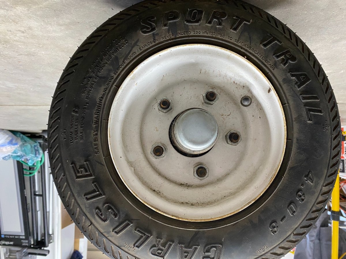

Pasta Burner Posted April 24, 2021 Author Posted April 24, 2021 8 hours ago, djh3 said: https://www.rvforum.net/data/attachments/34/34853-423910e63e15110f8a176e769ac9fb58.jpg That’s interesting, same concept but gives the support we all seemed to feel needed. 51 minutes ago, saddlebum said: You could always replace them with 530/12. the bolt pattern would be the same and you can choose between 4 ply approx 850 lbs at 55 psi or 6 ply approx 1050 lbs at 80 psi.. You can often find sales on rim and tire assembly's for about the cost of a tire. I just looked into that, I think I’d be in the same place as far as speed rating. Our posted limits are 80 and there is rumor of 85 test zones. My plan is to put it together and take it to a local trailer dealer and see what they can offer. Also pretty much decided on expanded steel decking, so hopefully they can point me in the right direction for that locally. If I don’t like what they have to offer I’ve picked out a couple choices. https://www.etrailer.com/Trailer-Tires-and-Wheels/Kenda/AM3H390.html https://www.etrailer.com/Trailer-Tires-and-Wheels/Kenda/AM31951.html I’m leaning toward the radial vs. bias ply. Thoughts on that? I see very limited off road use. But the bias is cheaper and can go faster.
saddlebum Posted April 24, 2021 Posted April 24, 2021 speed rating of tire is usually designated by a letter on the tire side wall see chart below 75 mph 120 km/h M 81 mph 130 km/h N 87 mph 140km/h P 93 mph 150 km/h Q 99 mph 160 km/h R 106 mph 170 km/h S 112 mph 180 km/h T 118 mph 190 km/h U 124 mph 200 km/h H 130 mph 210 km/h V 149 mph 240 km/h 1
Pasta Burner Posted April 24, 2021 Author Posted April 24, 2021 Thanks @saddlebum I knew about the codes but what I was coming across is a lot of trailer tires in these smaller sizes don’t contain a speed code. Looks like I can get the same tire and rim setup with a 87mph and load C rating for $55. https://www.harborfreight.com/530-12in-tire-with-5-lug-rim-load-c-64235.html discount tire also carries them for $32 for just the tire so replacements should be readily available should the need arise. as a go back to avoiding registration, aside from the hassle and cost, when I lived in PA I was ultimately unable to register this trailer because I couldn’t prove ownership. Highlander didn’t put VIN plates or even serialize the trailers at that time. I don’t remember all of the hoops and bull I was going to jump through but it wasn’t pretty or cheap. If memory serves I was going to have to claim it as a home built trailer and get it inspected all of which cost bit by bit more and more. Ended up relocating shortly after finding all that out and haven’t thought about any of it till the other day when I started this thread. Not sure if Utah would give me the same runaround trying to title it and I don’t want to find out 😁

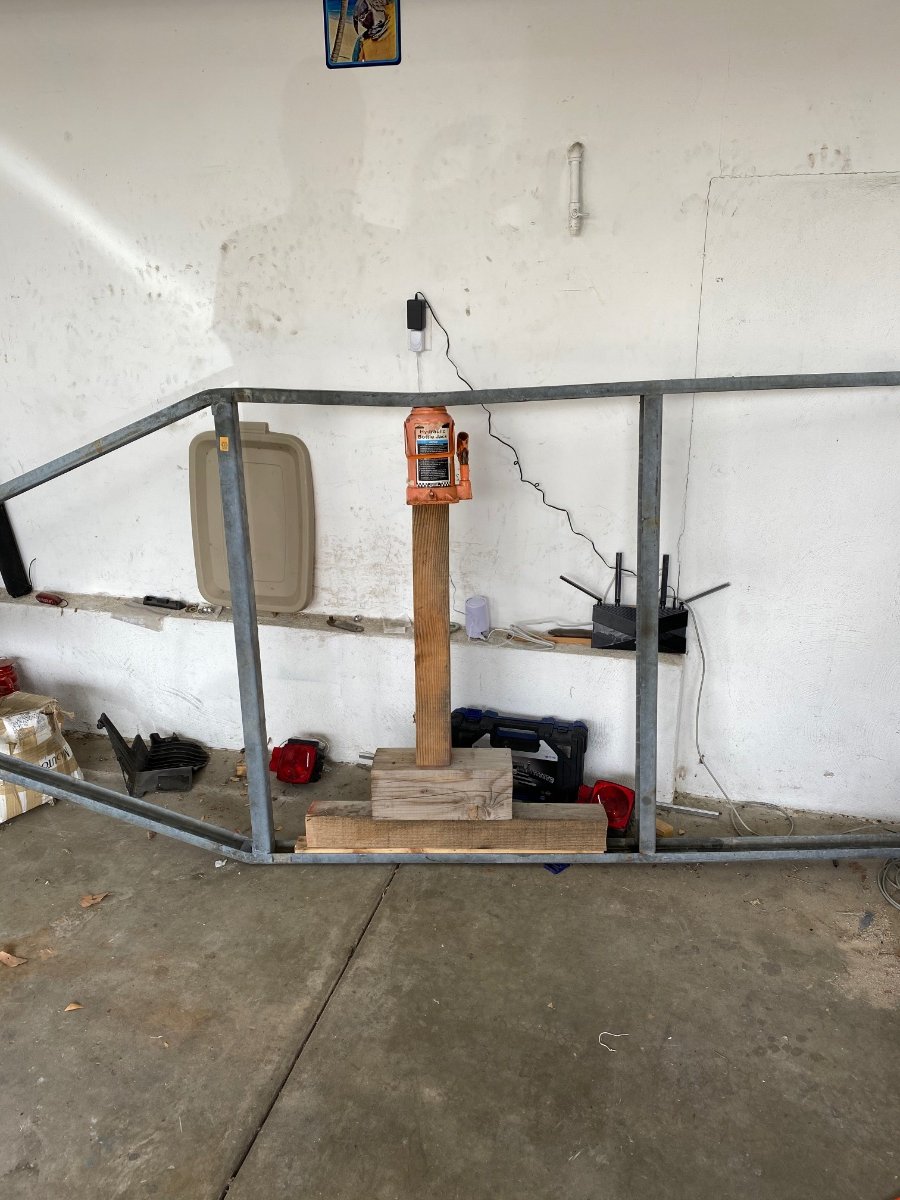

Pasta Burner Posted April 24, 2021 Author Posted April 24, 2021 Forgot about that little bend. Some redneck Ingenuity and I’m back in business. 4
Marcarl Posted April 25, 2021 Posted April 25, 2021 Make sure you measure the frame after you get it straight, bet the one side will be a bit longer than the other, so you'll have to compensate with mounting the axle of it will fishtail on yah. 1

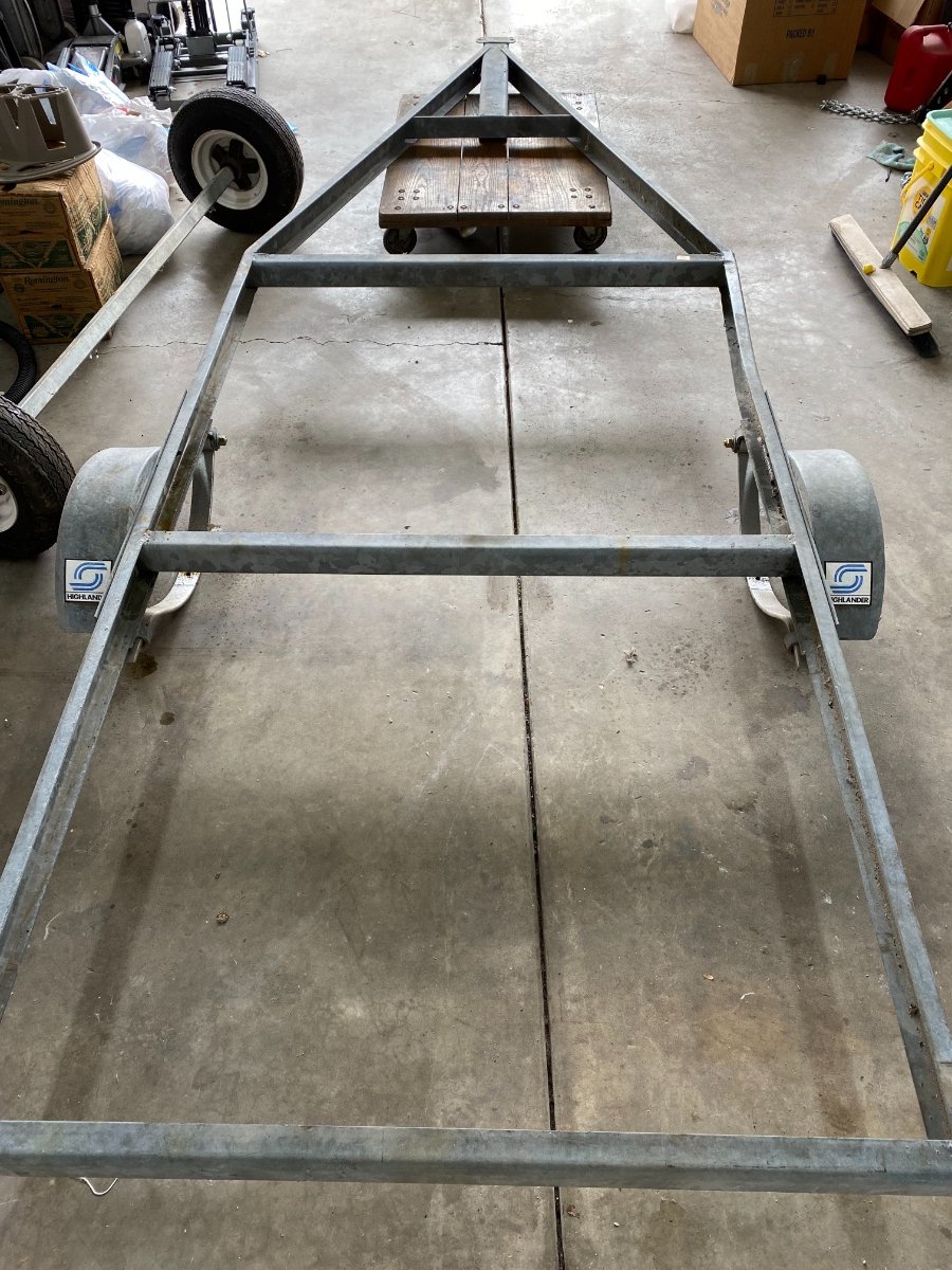

RDawson Posted April 25, 2021 Posted April 25, 2021 Is it just me or is the axle too far forward for good pulling? 3
dfitzbiz Posted April 25, 2021 Posted April 25, 2021 12 hours ago, RDawson said: Is it just me or is the axle too far forward for good pulling? Hey RD, I think the view from the rear gives us an optical illusion. What I can gather from looking at all of the pics is that the overall length of the trailer appears to be about 16'. About 6' of tongue and 2 sections of bed at 5' each. As a rule of thumb the axle would be placed 60% of the length of the entire trailer from the tongue or about 9.6' From what I can gather from the pics it appears to be about right. Of course the tongue weight should be between 10% and 15% of the loaded trailer. I would guess the trailer weight at about 500# and the RSV at 1,000# so tongue weight not less than 150# and not more than 225# should work. I believe this tongue weight could also be achieved by moving the load forward or back. These dimensions and weights should be verified by Pasta Burner. I'm sure he will PM us with any questions. 1
Flyinfool Posted April 26, 2021 Posted April 26, 2021 The tongue measured from axle to ball should be 1.5 to 2 times the width of the axle. You look to good there. Weight distribution is also critical to get the proper tongue weight. The location of the axle to the rest of the trailer is irrelevant. 1
